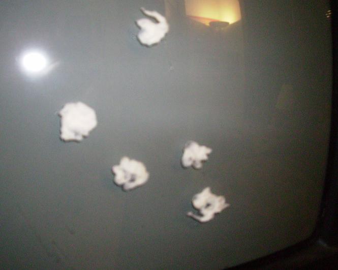

damage pics on the t.v. lol  using spit balls

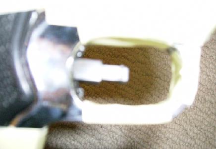

the igniter mounted as a trigger

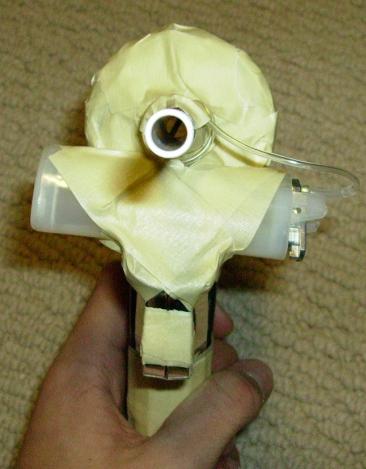

ahhh! dont shoot!
ahhh! dont shoot!

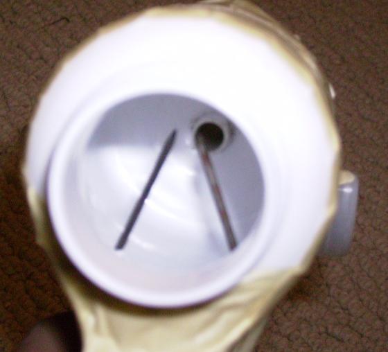

inside chamber with nails for electrodes

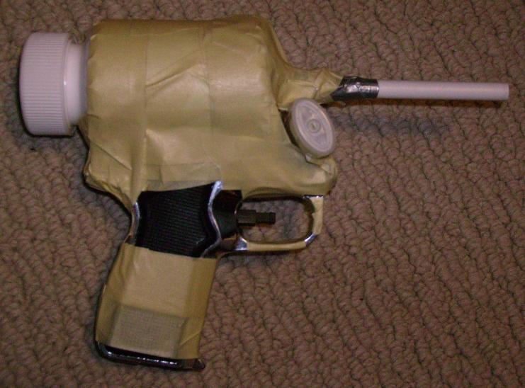

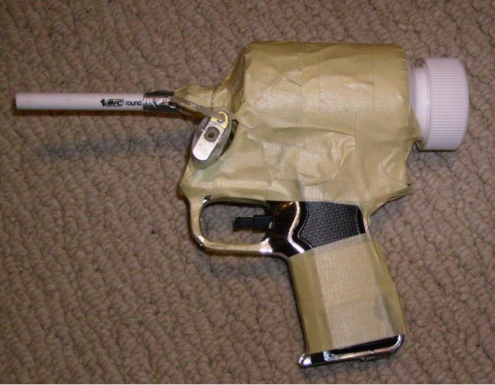

the beast
the beast
