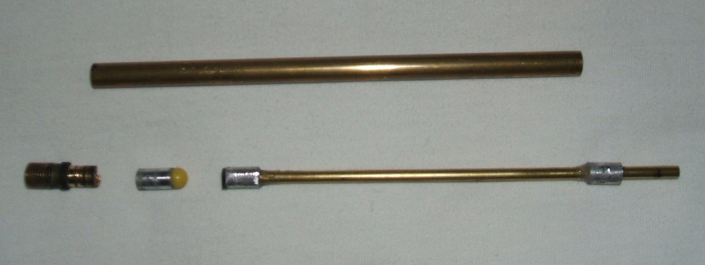

didn't check if anyone already asked this (i know, i know...) but what material are muzzle and breech parts, i mean the silver color parts glued to the barrel? also sorry if im posting on some old topic.
Tue Jun 18, 2013 4:35 am
Aluminium, but I've had good results simply wrapping masking tape around the barrel and gluing the whole thing with araldite:
http://www.spudfiles.com/forums/mini-0- ... 20101.html
Good for 800 psi at least ;)

and why are the pictures deleted
Sun Jun 23, 2013 1:02 pm
they were on my photobucket account, i had deleted a bunch of stuff.
here:
