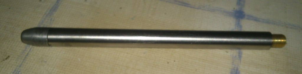

A cocky guy from my school challenged me to make a "nice looking" stuff that shoots :roll: . He wasn't serious but I decided to make something any way. Today a parting blade I have ordered arrived, so I thought I can finally turn some aluminium. My first thought is a >1000 psi pengun.
I haven't bought the lathe and mill yet so it was made on my drill press (good stuff, with some nice blade and mill bits you can do a lot).
Body made of 10 OD stainless steel, 1mm wall. Nose cone made out of a 12mm OD aluminium rod. Haven't finish it yet, not sure if nylon is a good material for the piston.

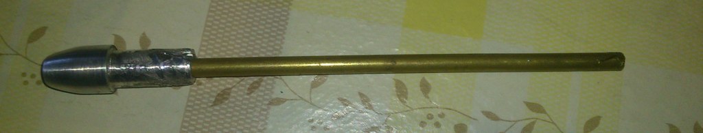

Looks a bit rough on the inside ...or is that tape?
With the outer tube on it looks good though.
How is the barrel ( going to be) sealed to the endplug?

wyz2285 wrote:not sure if nylon is a good material for the piston.
No reason why it shouldn't work well, delrin has similary properties and I found it great for HPA pistons.
Looking good for a drill press, you're going to love having a lathe ;)

Edit, done, only need to finish the firing cap.
That's the idea, for epoxy :wink:
Epoxy :D
Thanks Jack, I know :D

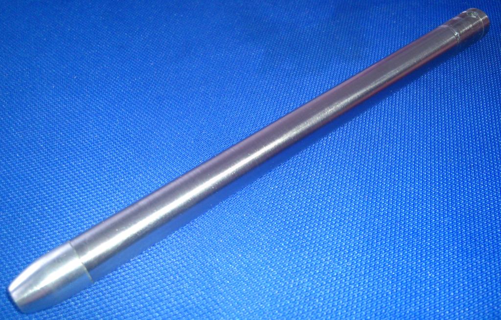

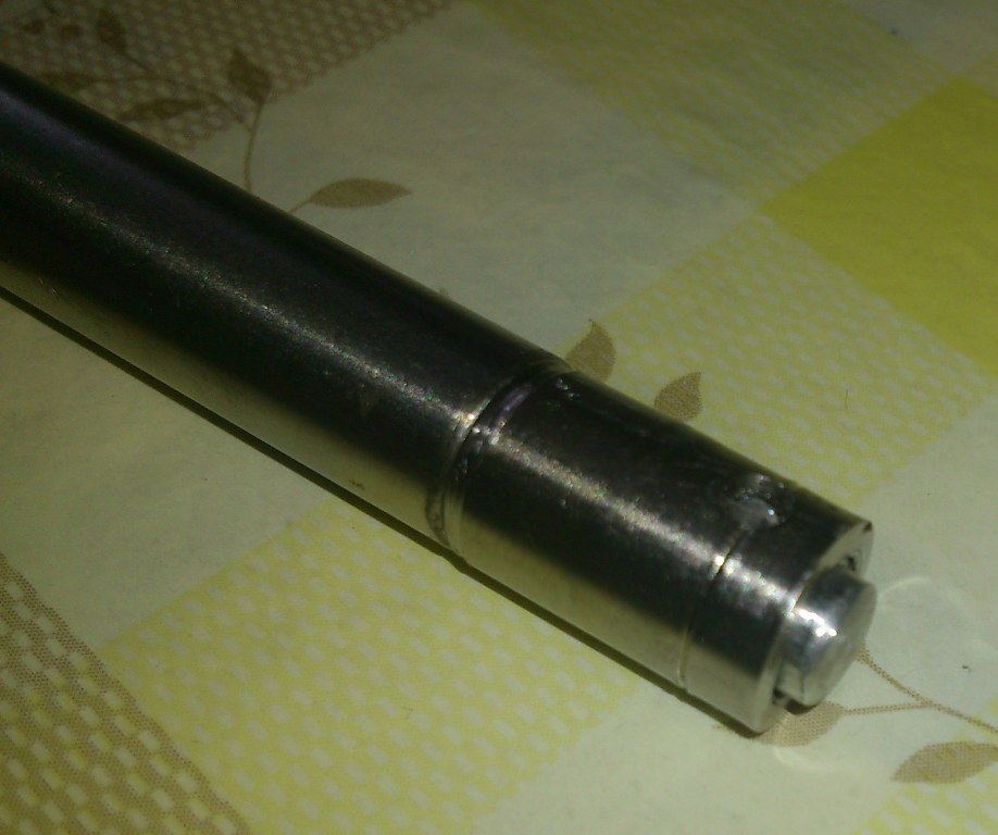

Finished the end-cap, all done :)
Tue Mar 19, 2013 9:32 am
Not bad at all :) I hope you put something on the breech end of the barrel to stop it going all cookie-cutter on the piston seal...
wyz2285
Austria
Posts: 2388
Location: Porto, Portugal
Tue Mar 19, 2013 9:48 am
Of course, the sealing face it 2mm id and 6mm od :) also has a magnet

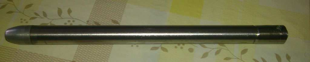

What calibre is it?
wyz2285
Austria
Posts: 2388
Tue Mar 19, 2013 11:06 am
2mm... I was going for 4.5mm pellets but didn´t have the right size tube. Now I do so when I get my lathe and mill a new one will be made :)

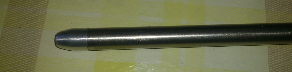

It looks awsome!

What pressure will she run at?
We will see some damage pics right?
wyz2285
Austria
Posts: 2388
Tue Mar 19, 2013 1:54 pm
Thanks BTB, right now only use 200psi, it will run on 1000 later :)
