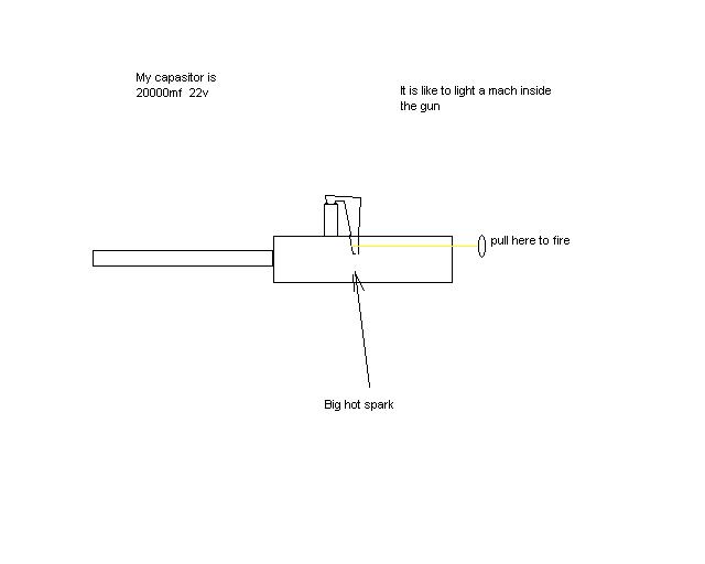

My canons are very difficuld to ignite too(with a piezo sparker from a lihgter) so I use a capasitor.
