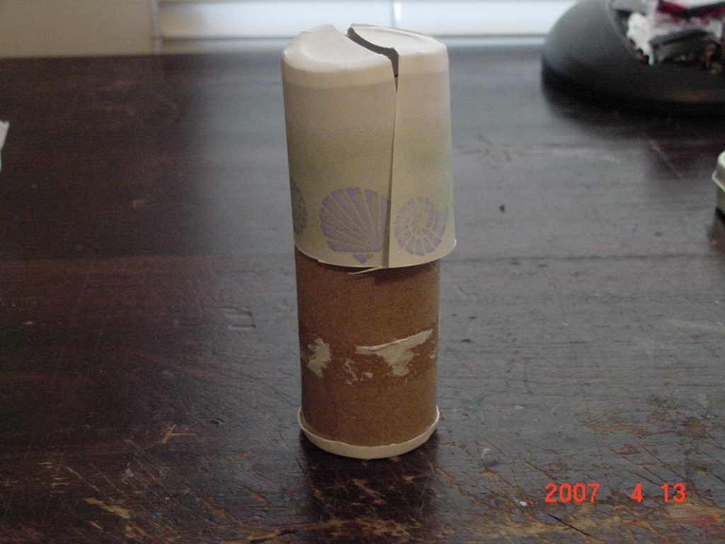

Here are my shot gun loads.The half shell holds 12 rounds and the full shell holds 24. I've also pictured my grenade shell.I don't use them exclusively for paintball.Dumping a bag of Snap and Pops in the shell is fun,Marbles,rocks,and smoke grenades also work out good :D

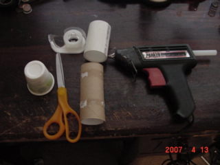

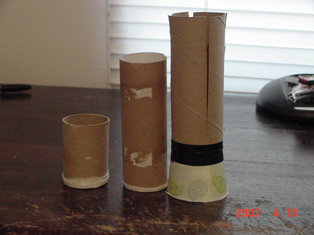

This is the stuff your going to need:scissors,Toliet paper roll,hot glue gun,2 paper bath cups,tape,and a piece of 1 1/2" PVC pipe 3-4" long.

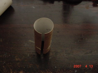

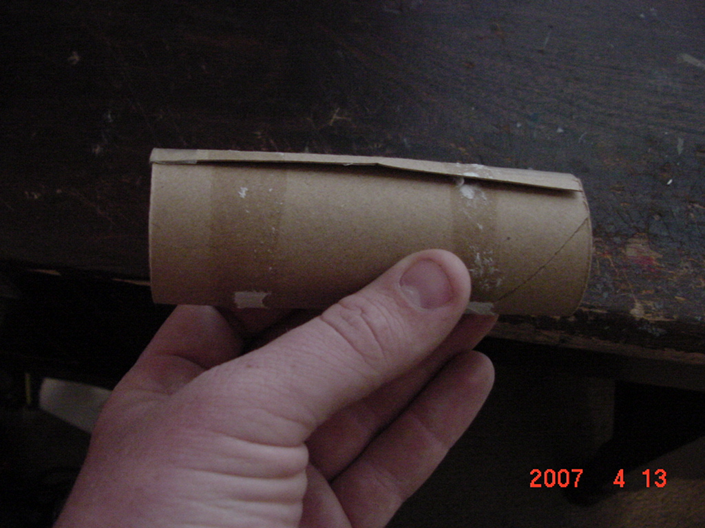

Get your TP roll and cut it like in the picture.

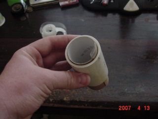

This is were your pipe comes in.Take the TP role and put it inside the pipe.Size the roll to fit the pipe on ONE side then tape it on that end.On the other size sqeeze it to fit the bottom of the cup and tape it.This side will be smaller
After taping the inside fill the gap on the outside with glue and press it together.You can tape it but the shell will fall apart sooner if you tape instead of glue.

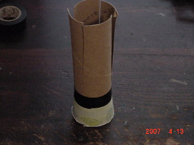

Cut the bottom off of the first cup.Along the line where the bottom is glued to the sides.Next take your hot glue and make a ring on the inside.Push your toilet paper roll(small side) into the cup and let it glue.The cartridge itself is done.

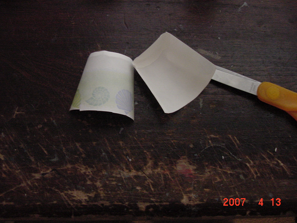

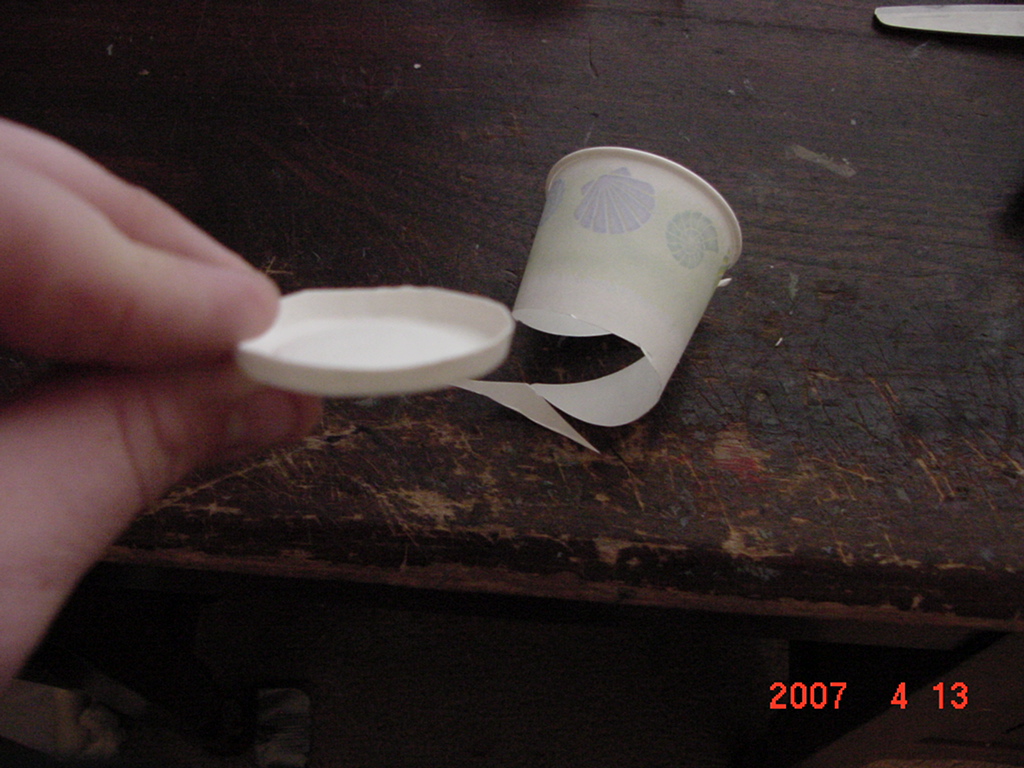

Cut the top ring off of the second cup. Then cut the cup in half. This is the stopper to keep the paintballs in.

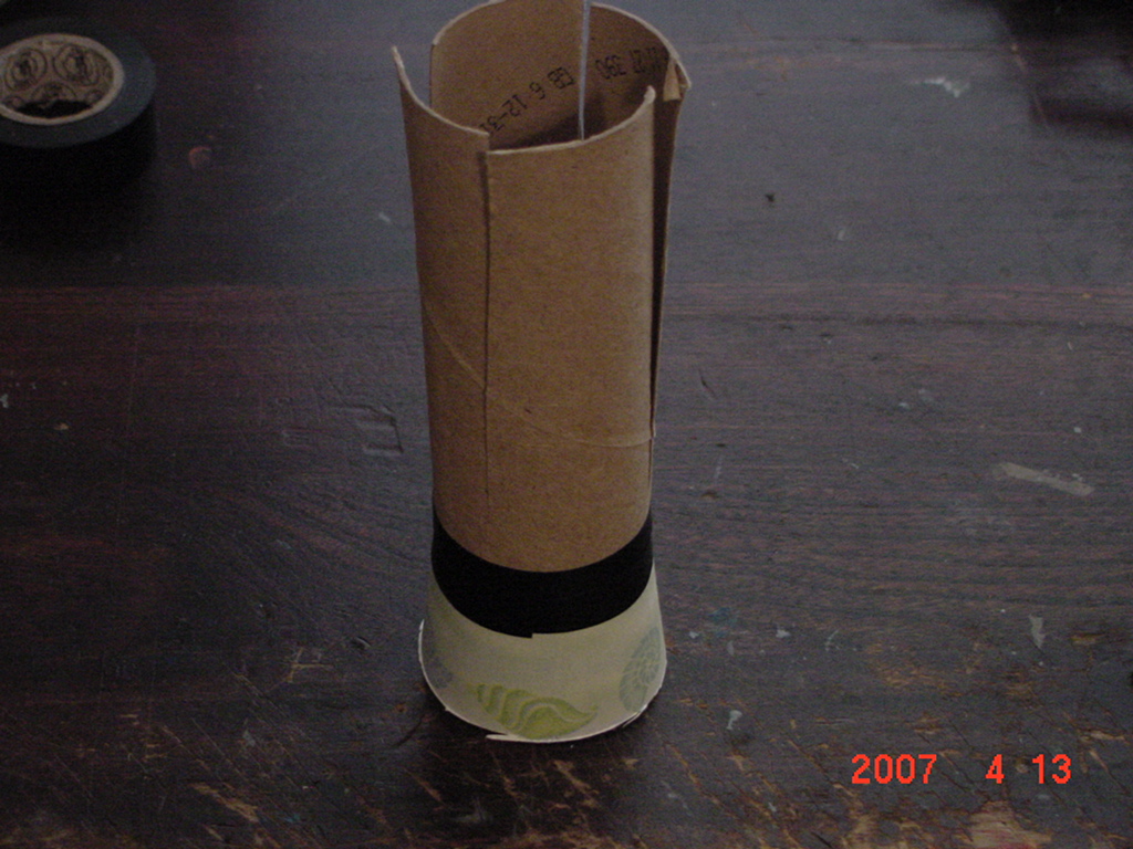

Here it is finished.These can be used to hold anything.
This is the grenade shell.All that is done is to turn a bath cup upside and tape it to the bottom of the toilet paper roll.Then cut the top ring off of the cup to fit into a 2" barrel.Finally cut the toilet paper roll in to 4 even sections.

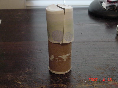

The finished cartridges.The small one is built identical to the regular cartridge only half as tall.
