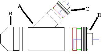

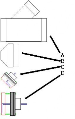

For my next cannon i plan on making a hybrid. But before doing so i would like to get my plans prefected to make sure i dont leave anything out that i would like to incorparate into my gun. I have drawn up two different designs both share alot of simalartes.
GUN PLAN 1
Gun Plan 1 the plans speak for them selfs. The reason i used two different fans is becasue i have two and i thought it would move are faster also. The reason why everything is attached to the end caps is so if you mess you only have to by new end caps and not a whole new chamber. I didnt draw where the fuel goes in because you can do that any where on the gun. I was planning on using a propane set up and maybe a place for the air compressor fitting (to make it a hybrid) on both gun plans.
KEY:
A=Sainatary Tee
B=4 to 1 1/2 Brushing
C=3" or 2" End Cap w/ Fan
D=4" End Cap w/ Fan
Red=Fan
Green=Nuts and Bolts
Blue=Wires

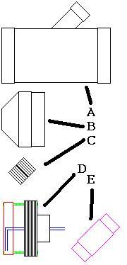

GUN PLAN 2
This gun plan i like better. It only uses one fan in the chamber. One thing that i will proably add is small fan inbetween part C and E. The flow/ check vavle is so that you can press on the screw to let the exhaust out. But when the gun explodes it wont go out vavle until you press on the screw.
KEY:
A=Sainatary Tee
C=1" Male Adapter
D=4" End Cap w/ Fan
E=Flow/ Check Vavle
Red=Fan
Blue=Wires
Pink=Flow/ Check Vavle
Gun Plan 1: Parts List w/ Labels
Gun Plan 1: Pulled Apart w/ Labels
Gun Plan 1: Gun Assembled
Gun Plan 2: Parts List w/ Labels
Gun Plan 2: Pulled Apart w/ Labels
Gun Plan 2: Gun Assembled

dude, you're asking for death here, you dont know much about hybrids at all, first of all you need to know how to solvent weld properly, and also you need ALL SCH 80 PARTS!!!!!!!! there are no sanitary tee's in 80, there's not many that are pressure rated in sch 40 either. you're talking about fans, when a hybrid builder should know taht fans wont do anything in a hybrid chamber. you're showing cleanout caps, which all of them are non pressure rated, a bell reducer, again non pressure rated, until you really know what you're talking about dont build a hybrid unless you feel like being comatose for a few years. go to http://www.spudtech.com and register on the forums, ask questions there, get answers from experience people, some of which have built hybrids, read the whole hybrid section before attempting to build one.
and as far as just replacing the caps if you mess up, thats bullshit, if your hybrid goes the whole chamber is likely to go, including you if you're near by, and fyi, PVC shrapnel doesnt show up on X-rays so you dont want it in your skin

It would work for just a regular combustion wouldnt it. I didnt know if i wrote it in the origninal forum but i ment to ask if it would work for a hybrid or if it wouldnt. Can you sleve the chamber to stregthen the walls?

it would work for a combustion yes, but strengthening the walls to use it as a hybrid wont do shit you need schedule 80 pipe and seeing as how you've never used propane or built a pneumatic, i'd also say you need more experience

DWV shouldn't be used for a hybrid, of course if the parts are Sch 40 you could do up to a 2x mix. With Sch80 you could maybe do 3 or 4x mixes. The last time I checked, snitary tees weren't rated.
