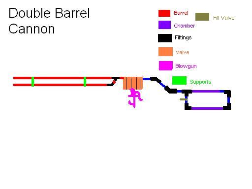

heres my new double barrel design. tell me what you think

Sun Jan 06, 2008 4:46 am
Its nice but with in your design, the connection of the lower barrel, cause the lengths to be different and the lower barrel to be longer overall.
I think you need to focus on making the barrels same length overall...
But beside it i think the design is good.
i'll make a drawing to explain in a while.

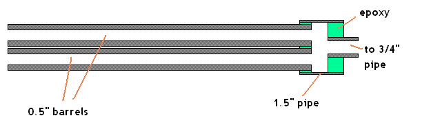

Sun Jan 06, 2008 6:07 am
If your barrels are say 0.5", hooking them up to a 3/4" valve like in the attached diagram, you'd get no loss in performance save for a little extra dead space.
Go on, let's see more creativity and less off the shelf parts on this forum :D

Sun Jan 06, 2008 6:19 am
idk if im lookin at the diagram right but is that just epoxy acting as the wall? i just like the reliability of parts off the shelf. or maybe get a joint that actually looks like a " Y " and make it side by side double barrel. im not 100% if im right but should the airflow divide evenly both ways if its side by side? im just tryin to milk everyone of their superior knowledge ( something i dont have haha).
Sun Jan 06, 2008 6:28 am
If you get a "Y" fitting that's the same diameter as the barrels, you'll get half the flow going to each barrel and less power. With my design and using a 3/4" or even better a 1" sprinkler valve, you'd get much better performance.
I'm a big fan of using epoxy as a casting material for custom reducers and endcaps, have a look here and at any of my finished projects.
