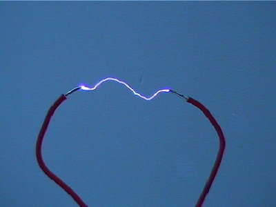

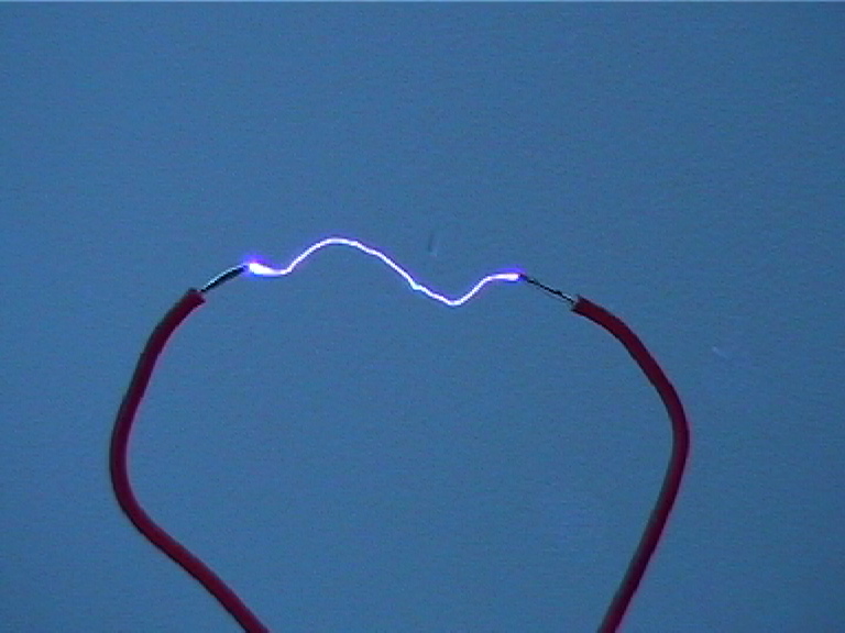

This is what happens when you make the spark gap too big, or it might short internally.

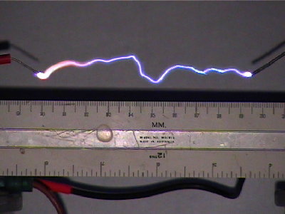

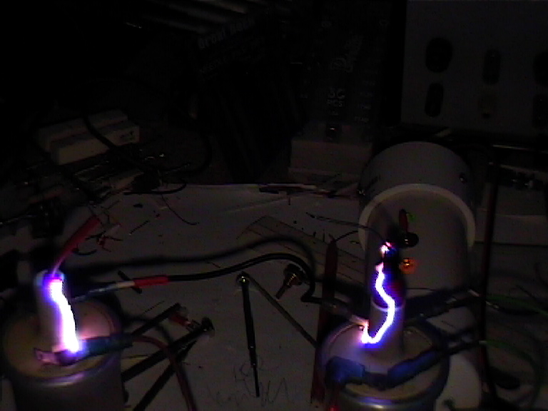

This spark was made with this exact type of circuit and two car ignition/spark coils connected in antiparallel.

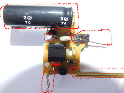

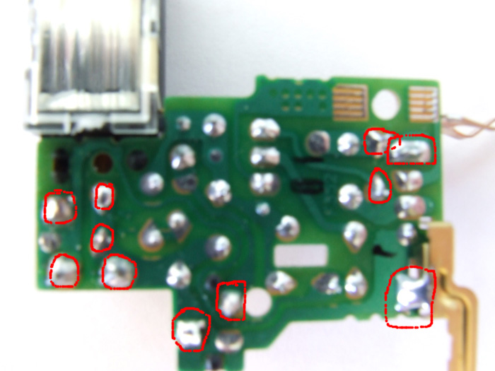

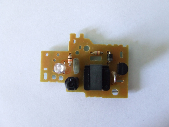

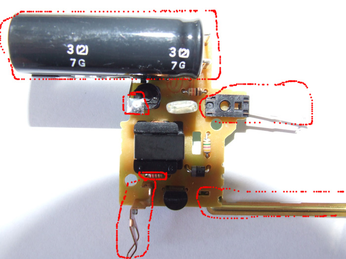

All the enclosed items should be removed.<br />The Capacitor is removed at first, only so the flash tube and reflector can be taken off, then it is soldered back on.<br />Make sure the polarity is right when you solder it back on.<br />The battey holder parts can both be taken off. The flash trigger can be taken off.<br />The lead on top of the trigger transformer needs to be unsoldered and removed.<br />Don't remove anything else, except the 220 ohm resistor if your going to replace it.
This shows where to solder to remove un-needed items.

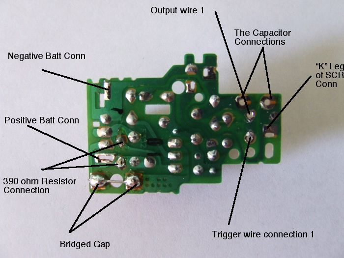

This is the top after having items removed.

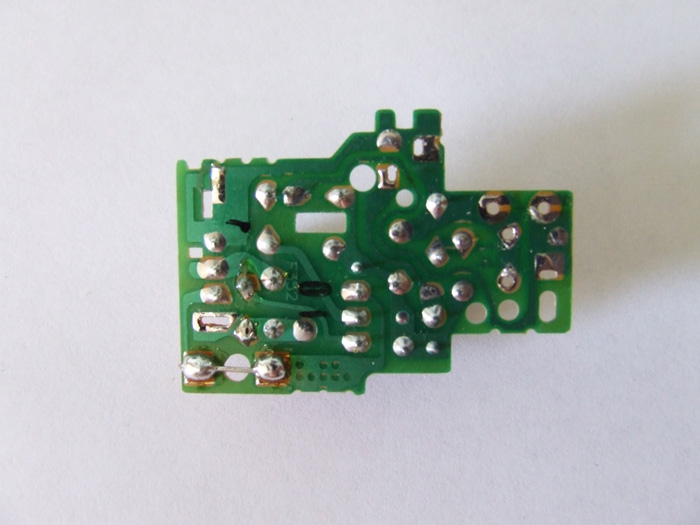

This is the rear after all the stuff that wasn't needed was taken off.
These are the battery box leads soldered in place.
Output wire 1 goes to the positve side of the spark coil. It is soldered to the positive side of the capacitor.<br />Trigger wire 1 is also connected to the positive side of the capacitor.<br />The bridged gap was just were the original on off touch switch was, it will be different depending on the circuit you use. Since I controll on and off from the battery case I just connect the two pads.<br />The original 220ohm resistor was removed and the 390 ohm soldered in.<br />If you cannot figure out were to put this resistor in the circuit you are using, then get a lower value, say 100 ohm and put it in series with one of the battery connections.<br />The original battery holder things are removed and the leads from the holder soldered into their places. Take note of which one is positive and which is negative before you take them off.

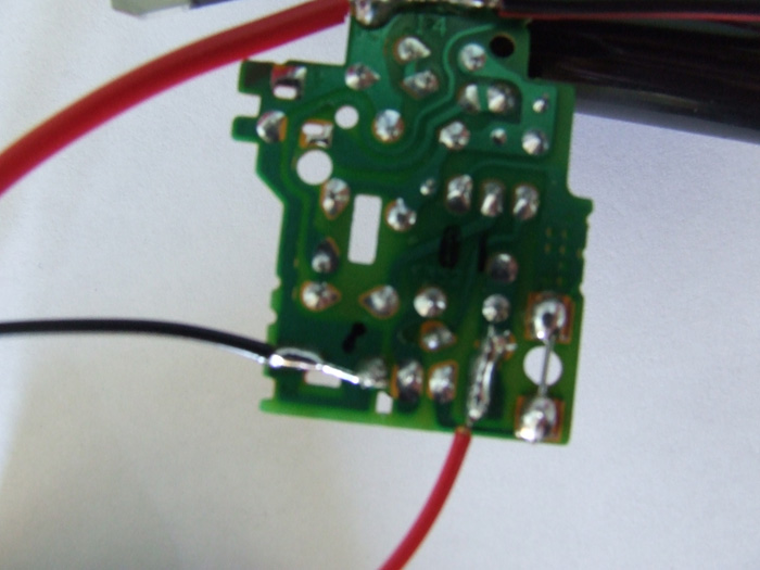

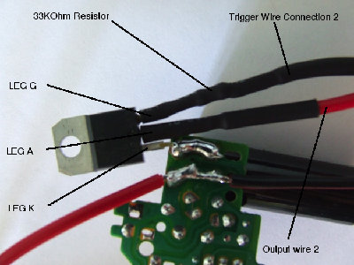

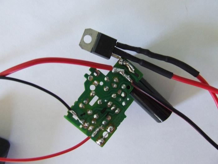

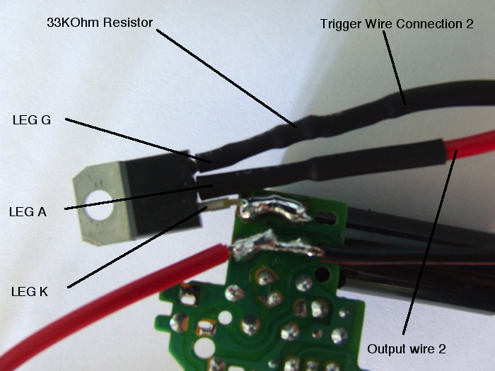

This shows where to solder things to the board.<br />Leg K is soldered to the negative side of the capacitor.<br />Leg A has output wire 2 soldered to it, this wire goes to the negative side of the spark coil. <br /><br />Leg G has the 33kohm resistor soldered to it then trigger wire 2 going to the pushbutton switch. <br />This resistor is very important, it must be this value and must be connected to that leg.

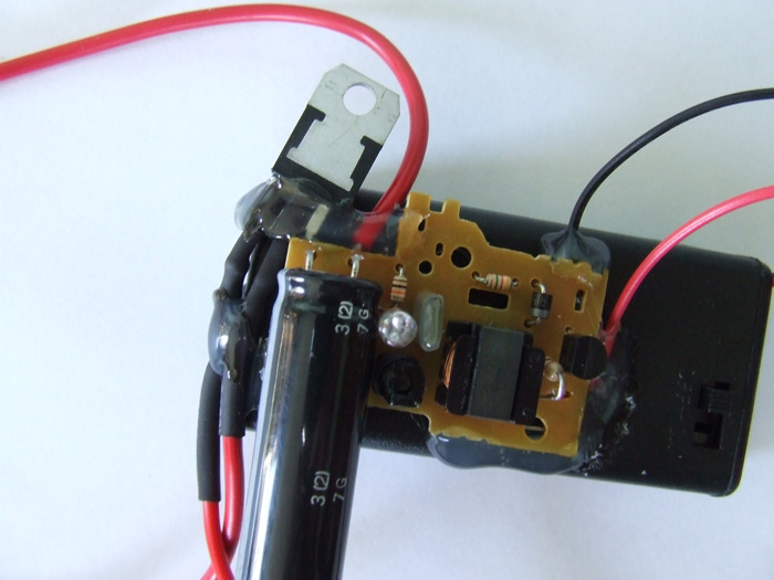

This is the finished circuit board. Trigger wires 1 and 2 are connected to the push button switch. I enclosed mine in a film canistor to make it easy to use.
I like to hotglue the board onto the back of the battery case, aswell as glue down the wires coming off it to the case. This holds it all together and stops the wires and SCR from moving about and pulling on the joins. It also insulates it a bit where there are exposed connections.

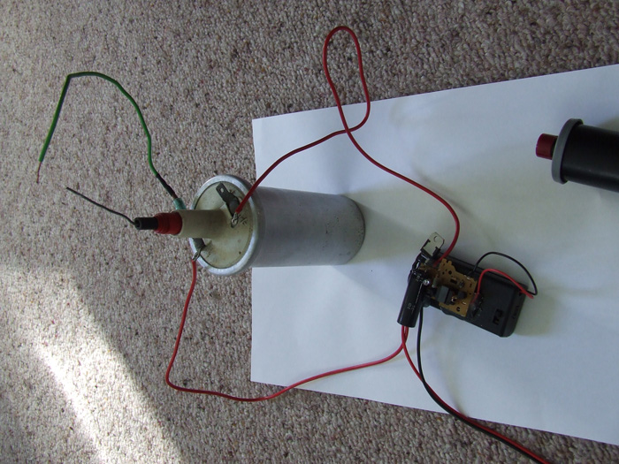

This is how it should be connected to an ignition coil. The positive side of the capacitor to the positve tab on the coil and so on. The High Voltage is between the Negative Tab and the main plug bit coming out the middle. Use wire with a fairly thick insulation on the high voltage side. Don't use a sparkplug lead as these have a high resistance and make the spark smaller.

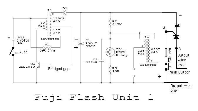

This is a better schematic, still pretty poor though lol.

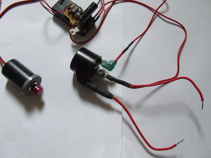

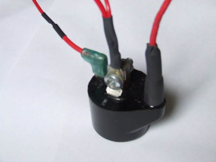

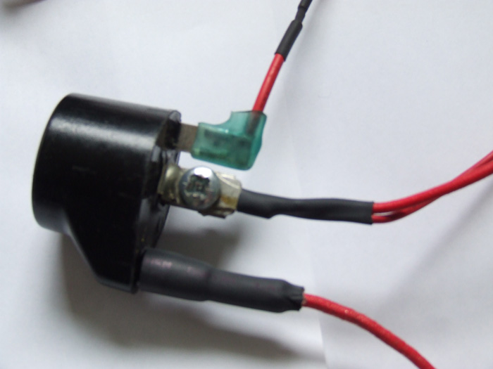

I found this coil recently and decided to hook it up to see what the performance was. <br />Its about the same size as one off a lawnmower engine. But this ones from a go-cart engine.<br />It is quite high quality which is why I like it, fully encased in epoxy with actual tabs coming out to connect the wires to. <br />The lawn mower ones (atleast the older ones) only had thin wires sticking out of the epoxy, tabs are a lot stronger and easyer to connect to.<br />The main high voltage output was sealed using heatshrink tubing which has glue on the inside which activates when you heat it.<br />This provides very good insulation and is very solid, a must if your thinking about building something like this. I was surprised at the size of the sparks I could get off this thing, around 50mm. <br />Thats more then some car ignition coils before they start to short internally. <br />Its just goes to show that if you put a little time into wiring it up nicely and using good insulation then small coils can create some big sparks.
Another pic.
Another pic.
New coil hooked up to circuit.

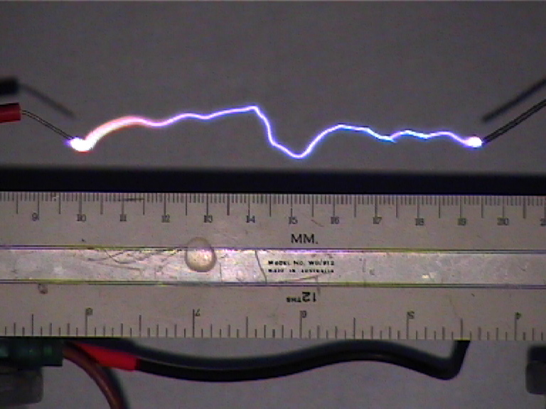

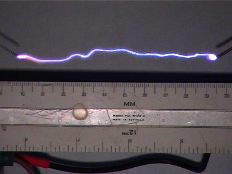

Sparks off small coil which are 50mm long (2inches).
