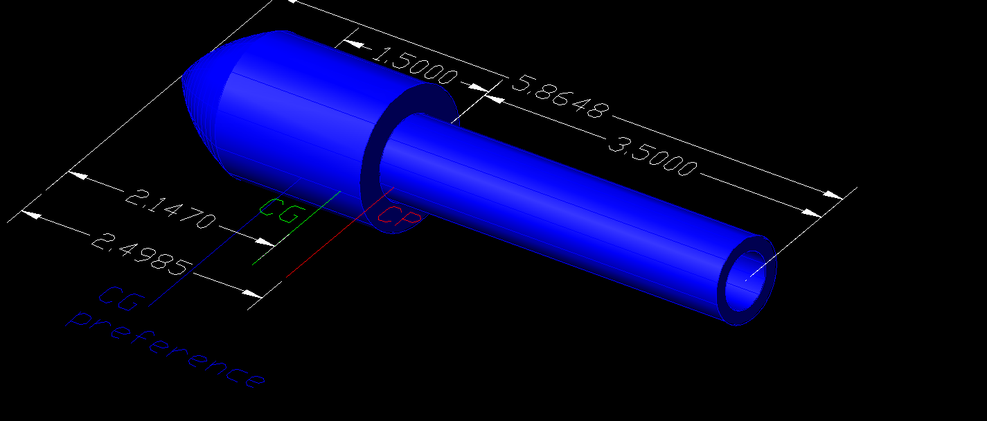

drex wrote:
the cp needs to be at least one body width below the cg to be considered stable.
Here is a quick drawing for nominal CG .

what program did you use for that drawing and cp/cg calculations?

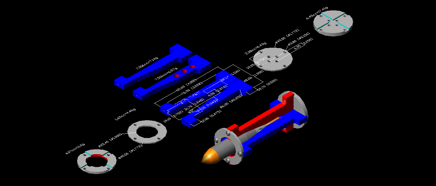

drex wrote:I made this at work earlier this week I had a little bit of time to kill. the nose cone part is 1.250" and the tail part is .750" with a .5 inch id. it did tumble so it was not a success in that regard, however the sabot did separate quite nicely.
Shame about the projectile not working but great sabot, there's certainly potential for development.

drex; I use an old 5 year AutoCad.
Here is the sabot with individual weights if I calculated them properly.
Sun Apr 24, 2011 1:03 pm
Impressive work Duane. You're right, as it is the weight is far too high. The material needs to be thinned out and drilled out :)

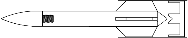

I would make it like this, with full bore fins. That way, the sabot is lighter, the projectile is more dense and also more aerodynamic due to the pointy tail.

I've used this design before on a few distance darts I made. It does indeed work very well - so long as the front of the dart is not heavy enough to cause deflection in the fins to the point where it can lay lop sided in the barrel. Even then the drag stabilization of the fins kicks in pretty fast to straighten things out mid flight if their adequate.
