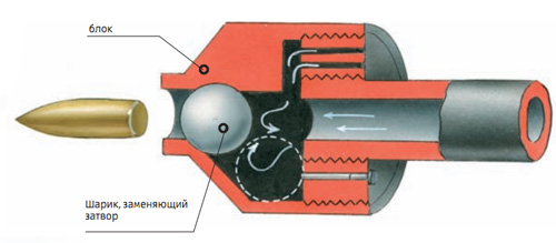

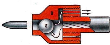

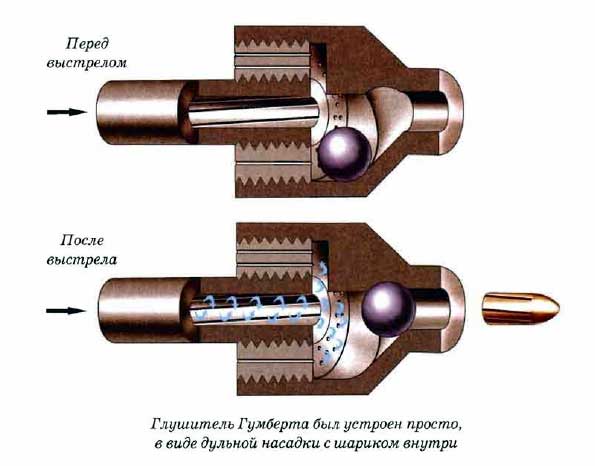

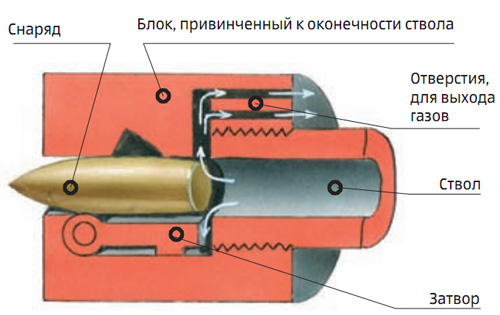

What do you know, this wasn't a new idea.
Can't find much detail though, other than that it was developed around 1898 by a certain French Colonel Humbert.
The design makes it a lot easier for the ball to block the muzzle, but the obvious problem with the ball on a ramp is that if you try to shoot at a downward angle...

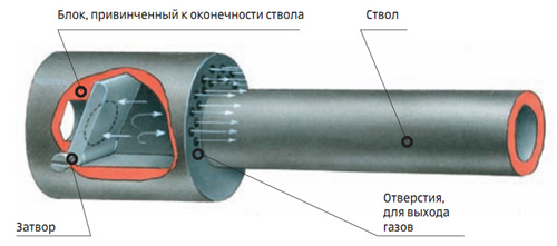

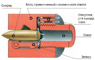

Some pics taken from this article, it seems that there was a variation with a flap instead of a ball.

What I don't like about that design is that if you fire the gun upside down (could happen), you shoot off the end of your barrel.
Also, they vent combustion gas right back at the operator
Sun Sep 02, 2012 10:41 am
ramses wrote:What I don't like about that design is that if you fire the gun upside down (could happen), you shoot off the end of your barrel.
Even if you point it at a slight downward angle as I mentioned.
True, though given the small bore of the vents it would probably not be that much of an issue.

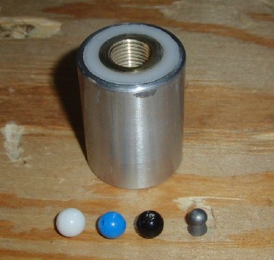

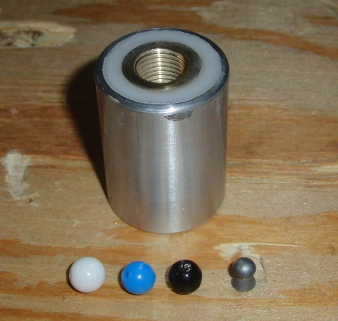

Anyway, decided to give this another go. My previous efforts floundered because I made them too weak, and because I only had airsoft BBs which were just 0.5mm greater in diameter that the 0.22" pellets I was using.
This time round, I used the aluminium tube and hammer-fit epoxied delrin endcap construction that has served me well with high mix hybrids. I also have a selection of plastic bead sizes (7.59mm, 7.88mm and 8.10mm) to choose a blocker from. The centre bore should allow the barrel gasses to leak out, though if that's still too loud I'll block it up. Blowing through the thing easily lifts the beads to block the muzzle, my fear again is that it will strike the pellet on the way up.
I put a female 1/2" UNF thread on the back to be able to attach it to my Daystate for testing, now that it's in my commercial interest to make a compact and effective airgun silencer :) watch this space.

The problem I can see is what happens when your projectiles are approaching the SOS in normal air.
These shut-off suppressors work by sucking the ball/flap into a stream of fast moving air, but when your projectile is traveling at sufficient velocity, there is also a similar pressure wave building up in front of it. This will not likely close the valve completely before the projectile gets there, but they may bump into each other a bit, quickly becoming a source of mechanical wear.
This is another reason why my old 'shunt' valve design was to use a controlled amount of contact between the projectile and flap to shut itself.

I just tried it out with the Daystate with the power turned up (900 or so fps) and no luck, all sizes of bead didn't budge. I'm guessing having the ball between two disks leaves too much volume for the venturi effect to kick in from the brief blast of air....
They seal well enough when I blow through it, but then again breath is low pressure but high volume.

Sun Sep 02, 2012 4:03 pm
Lockednloaded wrote:So in theory, this should work for the conventional "low pressure-high volume" spudguns?
I modded it with a single vertical bore and the ball now seems to be jumping to block the port, but no difference in noise. It would appear that the delay between pellet passage and ball movement is sufficient to allow the bulk of the air to escape.
I would surmise this is the reason why the concept is not in general use. Looks great on paper, but does not translate in practice.
