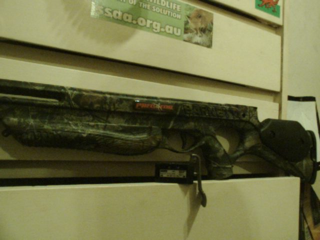

jonesy42
Posts: 94
Joined: Sat Jun 02, 2012 9:54 am
Fri Aug 31, 2012 9:07 am
wyz2285 wrote:My mom told me to clean my room and I found out I have a couple of QEVs, 3-ways and cylinders all around, I thought I´d make something with them and my friend had just got me some 12mm steel BBs.
So I made a simple .50 cal semi-automatic using 1/2 inch stainless steel tube as the barrel. It works like the most basic 3-way+QEV+pneumatic cylinder semi-autos, the cylinder it´s connected to the chamber of the QEV and it´s used for reload.
Any question just ask POLAND_SPUD :D
Part 1:
Part 2:
Hey wyz, can you make that set up a bit smaller, so i can fit it in this stock, :wink: lol.

wyz2285
Austria
Posts: 2388
Location: Porto, Portugal
Fri Aug 31, 2012 1:53 pm
Check out the "how to make a semi-automatic airgun for beginners" thread (I'm on my phone so I can't link it, it's in the how to data base as well). But basically you just need to use a smaller 3-way and cylinder (probably order a custom one).
