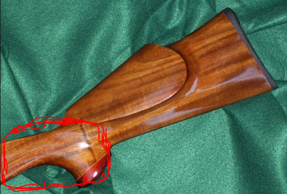

the red shows the grain direction, how it should flow through the wrist of the gun

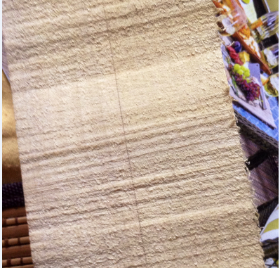

to get the grain pattern it is often a good idea to take a DAMP towel to the grain to check the area in question. (must also be free of large knots, they are brittle and often crack the stock later). you should then lay a pattern down to check how the grain will run through your design. (MidwayUSA chanel on youtube is a great reference for gunsmithing, though a few videos are only for those with special machinery, but can be adapted to fit your designs)Unfortunately I have a bedtime, so that is all for now.

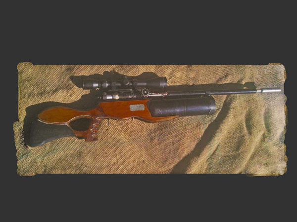

It looks perfect, i like building stocks. I made like 10 so far( only one ended up looking nice, my friend do not trust that its made by me) The best wood for tht is beech wood- it easy to work with it, it never cracks when working with, it has a beaytiful color and grain, and it is a very very strong wood....
I used it for my 6 mm QEV

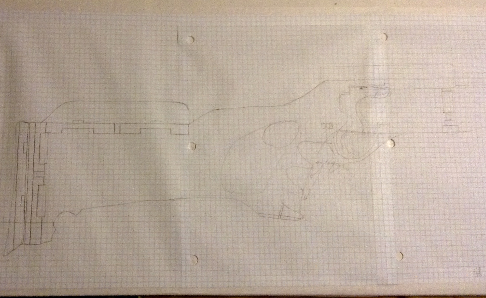

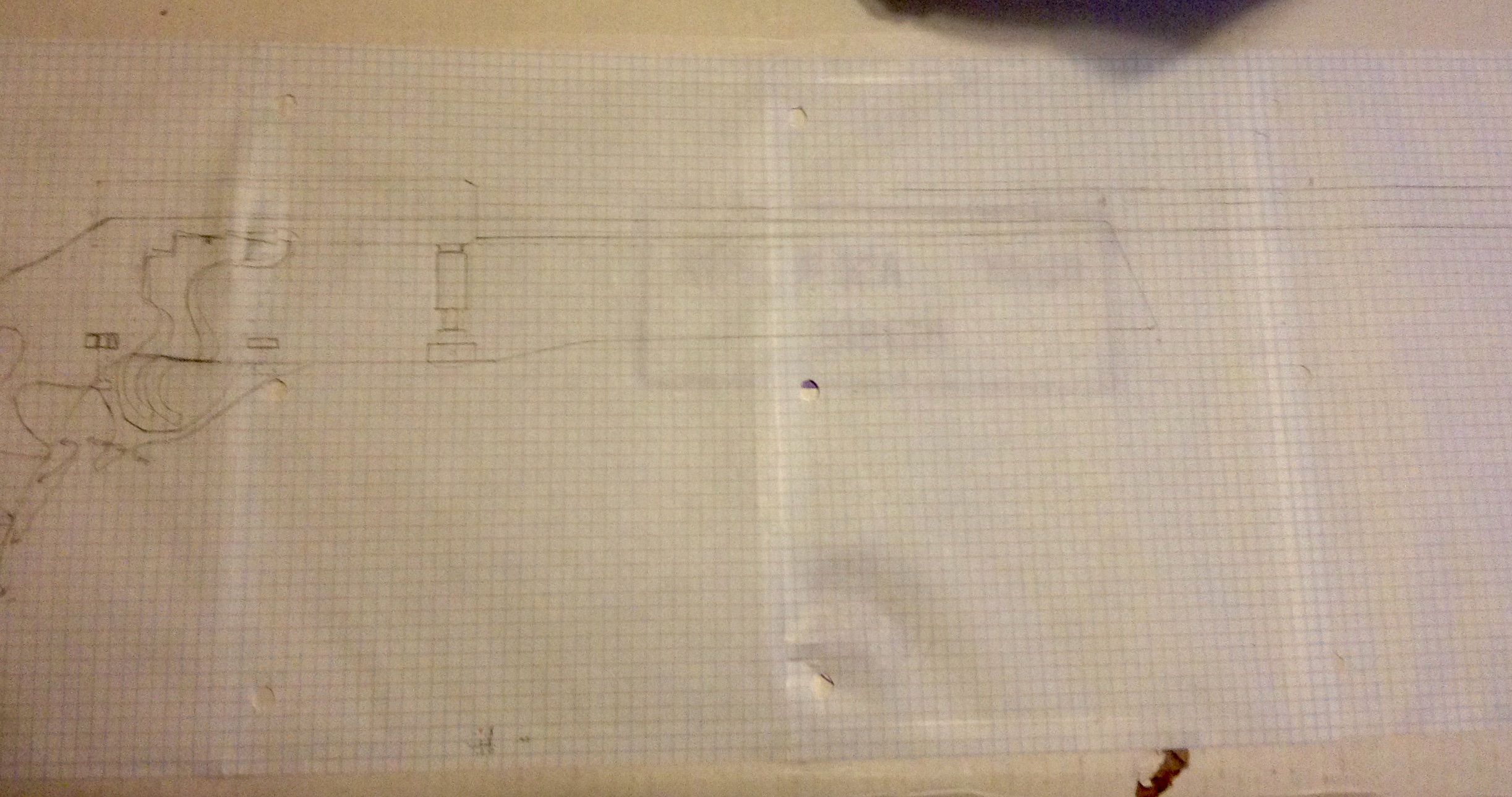

back on topic: design your stock AROUND YOUR *GUN! if you design your stock first, your gun becomes much harder and time consuming. Also borrowing ideas from other guns will help you create your own style,my style leans toward the l-96 with a thumb hole. When i started to design my gun i got graph paper out and got to work, the reason I say graph paper is that it is helpful for drawing lines and getting a size estimate without getting rulers and such. When drafting your stock, lay out the important parts you are going to use, like triggers mech (can be designed and made while drafting), barrel, chamber and holding fixtures. air guns have many more parts, but not all are applicable to every build. and remember the only one who needs to understand your design are the people working on it(depending on what you can accomplish on your own).
DRAFTING REQUIRES:
A Ruler/measuring stick
A pencil
paper for plans
Your mostly assembled gun
problem solving and imagination
part 1
part 1
part 2
part 2
Make sure you know what you want to make your stock from first, and also make sure you leave enough material to hold the force, exerted from the anchor points in your design. and one last thing, while drafting, log your moving parts, look at the trigger, I designed it to have a hollow for the trigger to move freely and it is designed based on my ability to work wood.

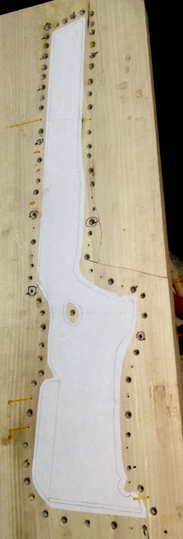

the next thing i like to do after drafting is to create a pattern that is good to lay out on the wood. I like a paper one because i can cut through the paper, so i can leave an edge away from the line that is 1/4" to 3/8" from the pencil lines. This is important if using a saw that may cut not exactly 90 degrees or distort in the wood blank, like a band saw, handsaw without a jig, or other things like it.

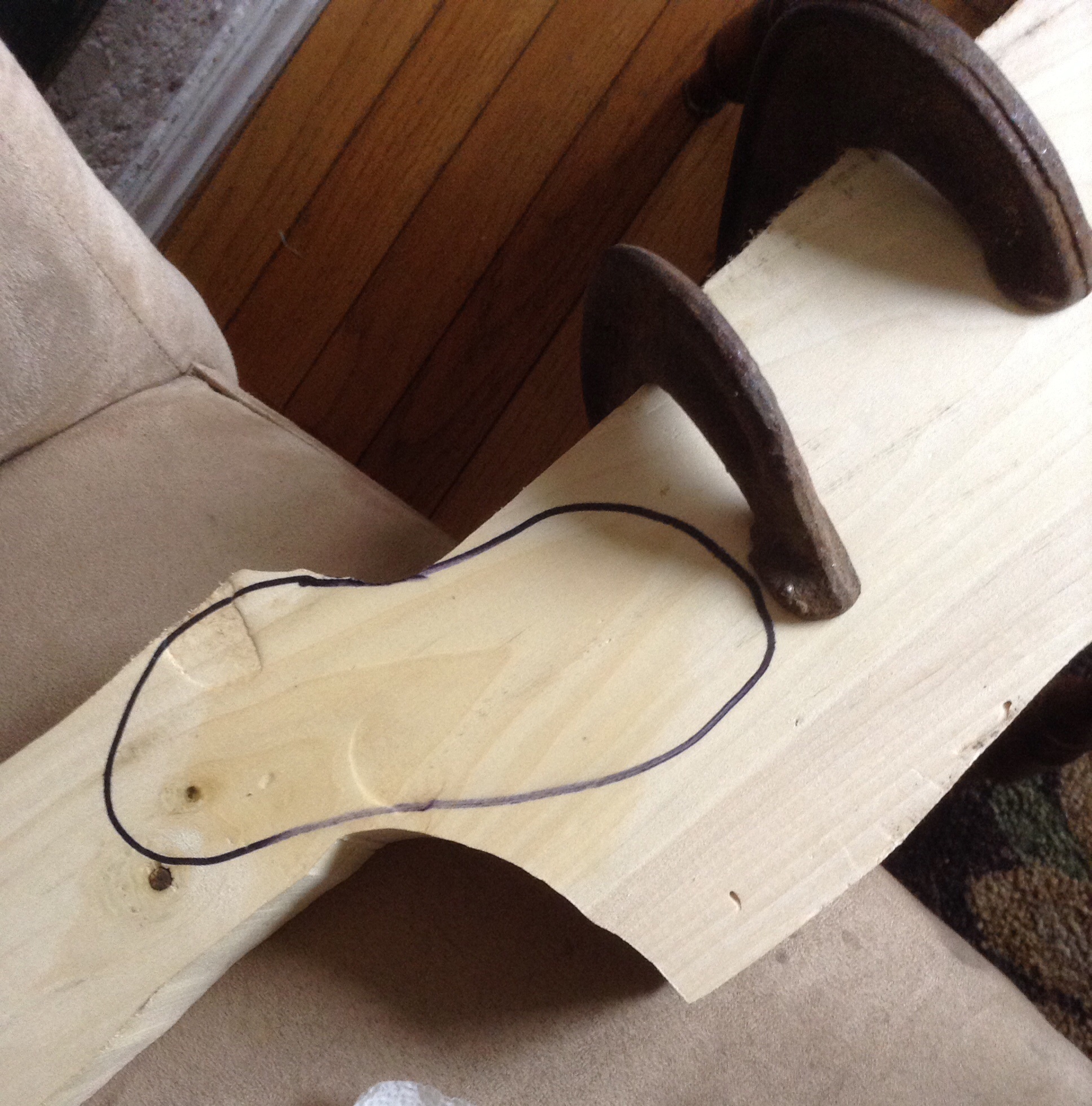

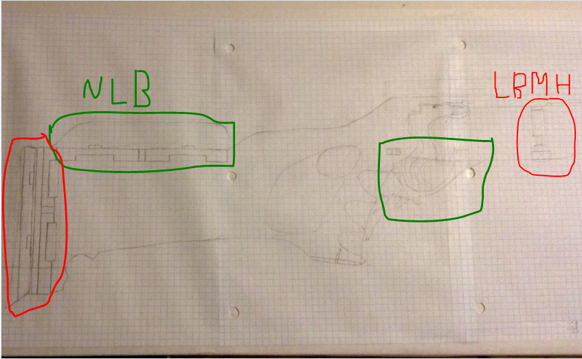

To make my stock, I laminated two pieces of poplar together to make my desired thickness. to determine the desired thickness for your wood blank, first you must determine how it will be put together. If pieces are going to be made separate from the stock, such as my cheek rest is (I left a space in the form of an aluminum plate) make sure you draft in cutting space, and spaces for mounting that do not compromise the stock's integrity. To avoid compromising the stock, you can add pieces of metal and epoxy to the area that needs to be strengthened (drafting it in is a good idea), again, midway usa has a video on it that is better than any video I can currently make. A good rule to keep yourself safe for wood is to make the spots for mounting away from knots or other imperfections and wider than you think they need to be, like 1/4" (1/2" before shaping) wider on a non load bearing area, like the fore-end of the stock(the part of stock in front of mounting pieces)
non  load bearing, load bearing mounting hardware
and for the load bearing parts should have a lot of material around them, like at least 1/2" (3/4" before shaping) on each side of the mounting pieces and should be as reinforced as much as possible to prevent breakage, both of my mounting hardware will have at least 3/4 an inch on each side after finished.

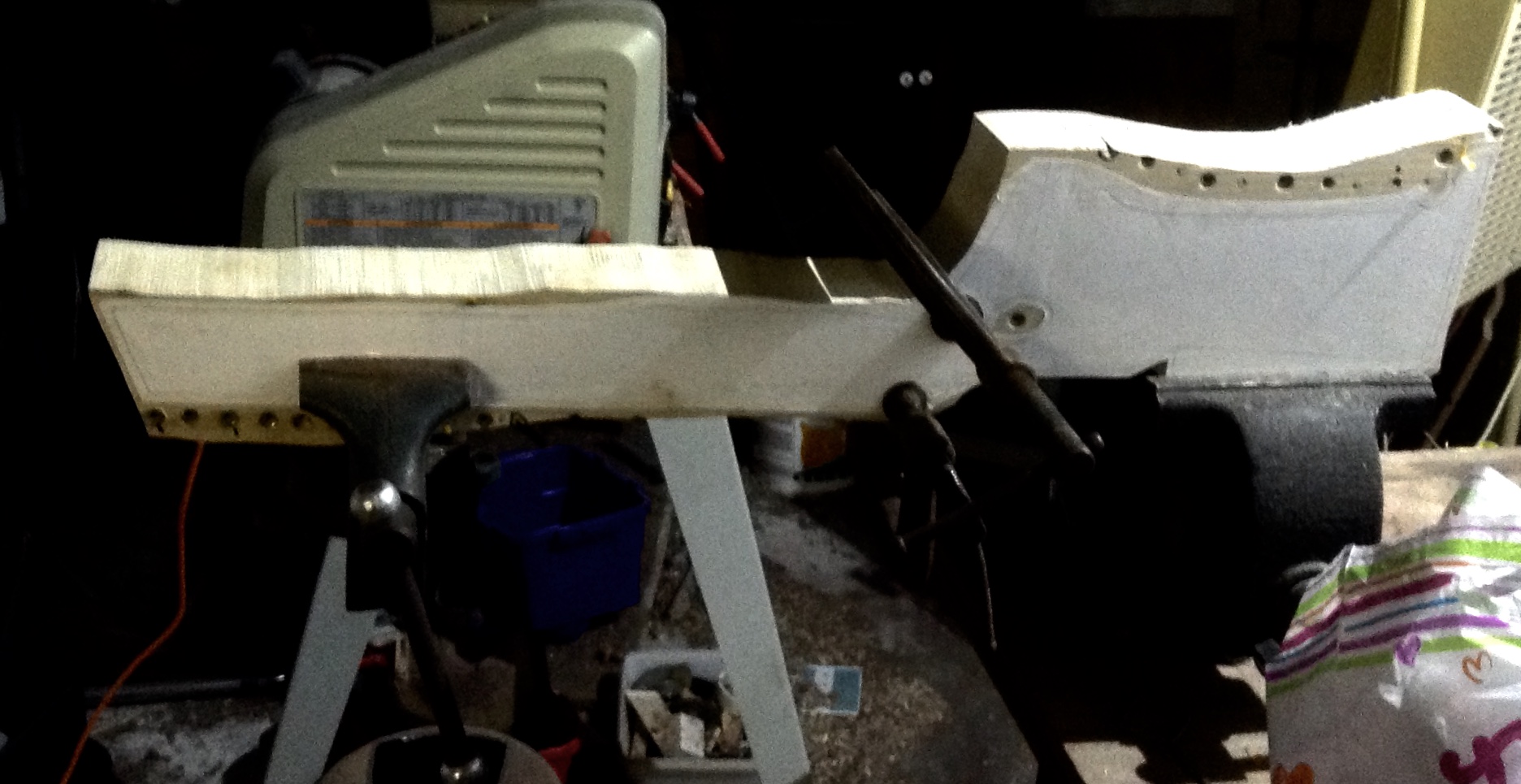

When laminating two pieces of wood together, it is good to have a lot of clamps, like 1 for each 4 inch area, so if you are making a stock like mine, you should, have a clamp every four inches down, and towards the back of the stock there should be clamps to the middle of the stock. to prepare the wood, make sure the surfaces are clean for gluing, if they are not clean and do not have a good bonding face it will create weak areas. Another good rule, have enough glue to seep out the edges when tightly clamped. the whole are must be evenly coated to prevent air bubbles, i coat both sides with a visible layer of glue that I rubbed into the wood using Clean rubber gloves. the glue and bonding surfaces should remain unhandled by hands, which could spread oils. after the gluing, make sure there is alot of pressure, holding the stock together, the end result is a thin, almost disappearing glue line.
the glue line runs the long way
.Just remember the more area being held together the longer the glue takes to dry because there is more glue to oxidize, making it dry from outside to inside. after a few days to 2 weeks depending on the glue and surface area being glued. keep the wood from getting wet, too cold or too hot, and receiving shocks(like dropping) .to do the clamping, i did it a much less desirable way, i used a lot of screws to hold it together to start with, holding the two large piece of wood and letting them to dry for a few days. then i took the screws out when the glue was in a plastic state in the center, which created a nice edge. then i cut the stock out and clamped it, on the areas that needed more pressure, like the stuff that was on the inner part of the wood blank. then i let it dry for a few more days so that it could cure. i do not recommend the clamping method i used because it is more unpredictable in the final result.( if not enough pressure is applied by the screws is not enough, there will be too much excess glue, if it is taken off to late it will not be able to be compressed in the plastic state, and the less uniform pressures may spread the wood in certain areas.
with screws removed and template glued on
(vices work just like clamps if you need some, i have three random vices so i used those for lack of clamps)
i later clamped the thick part of the stock about 10h later using the c clamps and a vise.

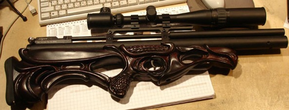

Will it look like this ? :)
