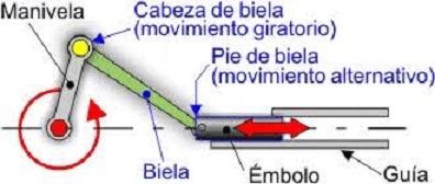

Only electric compressors have this system, the kind they use to pump air into the wheels of automobile tires. I imagine that you could build one with the features you need or use directly one of those that can be purchased. With a lithium polymer battery of good power, it would be quite compact.

These pumps tend to have a very small volume so if you're going to convert it to a hand crank, it would have to be geared up considerably otherwise you'll be cranking forever.
To be honest I think you're better off with a large paintball bottle or SCUBA tank + regulator.

Hi Jack Yes, these compressors have a reduced flow rate. I bought one and it takes a long time to fill a chamber of just 50 ml at 7 bar. Maybe a bigger one, depends on the application.
