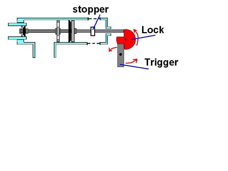

I'll post a picture of what I think sgort means, wich I have thought of before I might add, just never tried, because I never felt like going through the whole trial and error process...
Here is my thought on what sgort said.
Trigger and lock should be metal , housed in something....very strong.
I have made crossbow locks like this and they worked, so why not combine them??
This way it could ( make that "has to") be filled from the chamber side, and it could be reset by hand, and the middle washer is no longer needed..saves some more weight..

I just copied and pasted this.jrrdw wrote:There is a line of writing in your post that is way to small to read. What does it say?
"The front "barrelphram" can NOT be used without the back one. Without the back the front can NOT be pulled out the barrel because of the pressure on the front causing friction."
