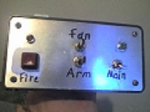

Switches and LED's. You Know what the red button is for LOL :)
Trigger Box Front.jpg (13.98 KiB) Viewed 3955 times

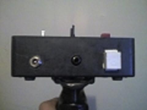

Were the Plugs go
Were the Plugs go
Trigger Box Back.jpg (10.05 KiB) Viewed 3955 times

you need to get a label maker and make the labels more official looking. Is it for a specific gun or is it going to be for a number of guns

um, usually for remote firing things the arm means that there is a circuit established, to make sure you didn't do something wrong
um, how do you plan on getting a circuit w/o a spark?
or have you done something different with the arm?

Yea, I know that I need a labler to make it look more official but I got to wait till payday. And the Remote will be able to be used on ANY combustion gun I make in the future. The only thing that I need to do is get another stun gun for any future guns.
sandman
The Main switch controls the power to both Arm and fan switches. The arm switch just controls the power to the fire button, so I don't accidently push the fire button. The fire button turns on the power to the stun gun exturnally. The stun gun is still on the cannon which makes the spark. The remote just controls the power for the fan and stun gun corded 25 feet away buy Cat-5 network cable. This is a concept from the way a Detonator for TNT is built. I still might get a key switch for the main switch to make it more authentic looking.

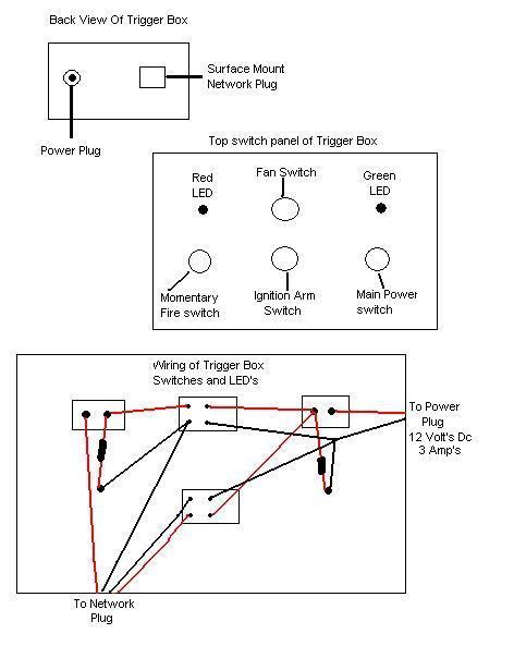

This is how it is wired up hope you can understand this I'm not good at making diagrams.
Wiring Diagram of My trigger box.

ok, yea makes since now
and i would get the key for the main like you said
