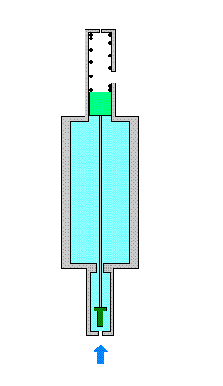

I think you'll have to do a fair amount of research into springs but it could work.
As constant rate springs are difficult to get hold of I'd suggest a long rising rate spring, and only use a very short bit of its compression either by getting a stiff spring or pre-loading a weaker one using the "lips" you've omitted here for clarity.
I think this might be why in the past valve like this have sat half open. The force applied by the spring decreases as it extends, and you come to a point where the pressure in the chamber can build up through a partially open vent such that the forces equal each other.
Does that make any sense?

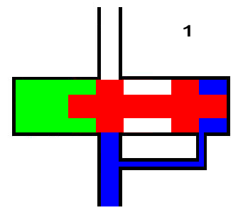

Looking at it closer I think this is how it works. I've dropped the spring completely and that little port into the barrel and am using air as a spring.
Blue is high pressure air, green is lower pressure air and if it's white it's at normal atmospheric pressure.
1 high pressure air enters the system
2 piston pushed across, opening valve
3 high pressure air is free to flow down barrel
4 pressure decreases and system resets
Well I think that's how it works.

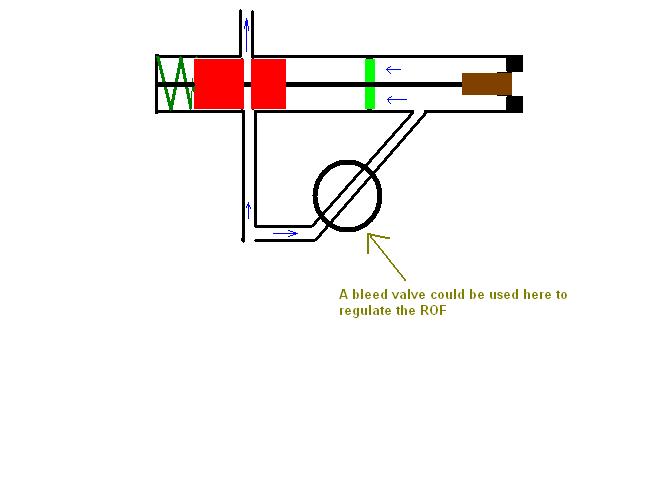

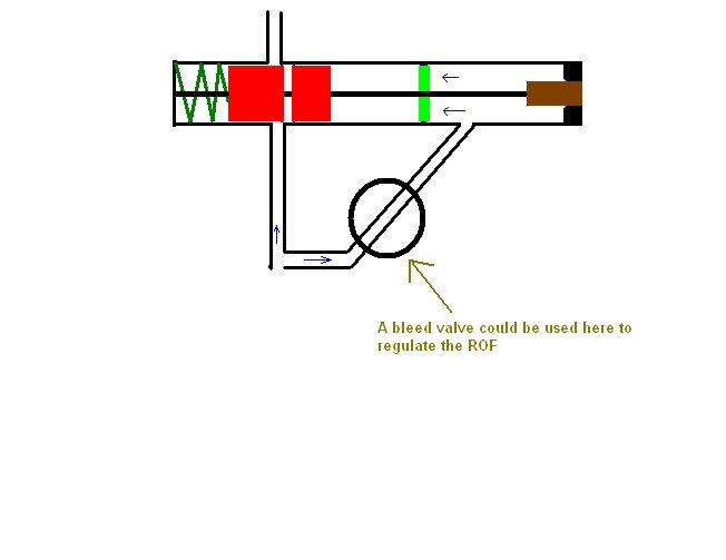

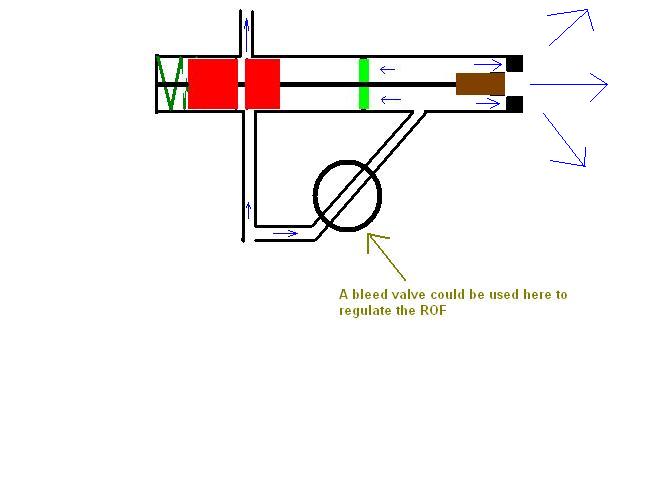

JSR that drawing sucks so don't bother looking at it, you know it was late at night and it was a wrong interpretation of that diagram that I've found in the documentation of that valves.....
this is much better and it would work for sure.... you could also use a free floting idea for that brown piston in these pictures.. i think it would improve the whole thing.... the real problem is that it would waste some air.....
- third phase... air is let throught that opening (brown piston) and the spring moves the whole valve to the right blocking the flow to the chamber... possibly wthe brown piston could be free fpoating to give more time before the valve opens... or the realesed air could be used to power an air cylinder that would help the spring to close the valve and would give more delay before it opens again.... but this makes everything more complex and it is needed to realese air from the aircylinder afterwards...
- XZ2.JPG (21.08 KiB) Viewed 4167 times
- second phase... air is let to the barrel the piston is still moving to the left
- XZ1.JPG (19.31 KiB) Viewed 4167 times
- first phase... air is slowly moving the piston to the open position
- XZ.jpg (18.71 KiB) Viewed 4167 times
