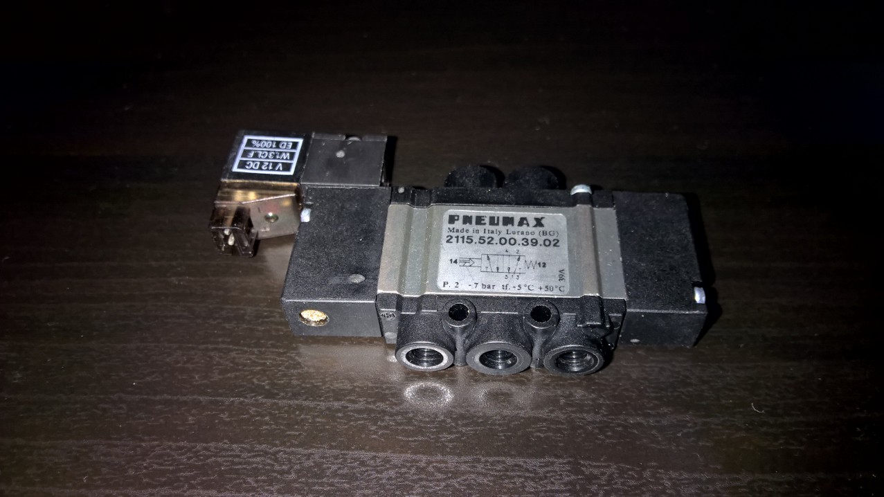

Anyone have any idea how this 5/2 solenoid works? It doesn't seems to work as normal 5/2 solenoids.
I checked the model number, didn't dig up any diagram or manual. It also has a weird exhaust port (no thread, the one with brass particle filter) that is leaking (or it's supposed to do so, can't understand why it exists).
Wed Sep 16, 2015 6:39 am
Some sort of spool I guess?
wyz2285
Austria
Posts: 2388
Location: Porto, Portugal
Wed Sep 16, 2015 8:28 am
Yeah I thought it was a pneumatically piloted spool, but the leak from that hole never keeps the spool pressurized so the pilot does nothing at all. I'm gonna return this back to the store..
Edit: faulty valve, the store gave me a replacement, working perfectly now :D
