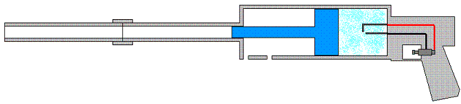

I have been thinking of building a launcher that works like a pressure amplifier, basically a two stage launcher. It would consist of two chambers connected by a push rod. The first chamber would be a fairly large and low pressure PVC chamber and might be either combustion or pneumatic. It would drive a push rod until the end of the stroke where the pressure would be dumped as the piston went past a port. The push rod would drive a piston in a much smaller diameter steel chamber. There would probably be a burst disk between the high pressure chamber and the barrel.
According to a quick and dirty calculation, it looks like a 3" primary chamber with 100 psi using a push rod to drive a 1" piston you would get something in the neighborhood of 400 psi. More or less amplification would seem to be easy to arrange by selecting the appropriate diameters.
Does this sound like it would work?

PeteS wrote:I have been thinking of building a launcher that works like a pressure amplifier, basically a two stage launcher. It would consist of two chambers connected by a push rod. The first chamber would be a fairly large and low pressure PVC chamber and might be either combustion or pneumatic. It would drive a push rod until the end of the stroke where the pressure would be dumped as the piston went past a port. The push rod would drive a piston in a much smaller diameter steel chamber. There would probably be a burst disk between the high pressure chamber and the barrel.

PeteS wrote:It doesn't sound all that complicated to me, but maybe I am missing something. One likely advantage I can see is that it could be used with no pump, powered purely by combustion. That way you would not be tied to an electrical power source. You would only need the launcher, some spuds, some burst disks, and your propane metering system. So only a few pounds of stuff that would all fit in a small backpack.
There has been some discussion of such systems, here's a diagram I had posted a long time ago:
No real advantage in using it as-is though, for real advantage you would need the piston on the compression side to be of smaller diameter in order to generate significantly larger pressures than what the combustion is achieving.
That being said, I'm sure there's room in your backpack for a small bicycle pump - go hybrid, you won't look back!

Hybrid indeed may be the way to go, but it seems to me this would be pretty simple and work. The line in the barrel a burst disk
