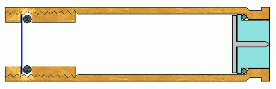

Lemauditpouravoirabandonnésonamourdelacomplexité wrote:Alright, here's a better insulated-no thread-no glued-self sealing one
You're getting the hang of it ;)

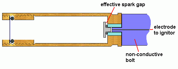

Gun Freak wrote:So what's to stop you from insulating the valve stem?
Technically this could work, what I don't like is the bolt poking into the cartridge, this could cause issues with ejection. I've ensmallened the valve stem to allow it to be dropped out through the mouth of the cartridge in case the seal needs replacing.

Here's another one, now I understand better the problem and in case dewey1 is working on another drawing:
- plastic plug that can slide to be used as the refil valve
- sealing with no need for a precise o-ring size
- hole can be made with a standard drill bit
- the electrode is a bended brass pin.
:D

Gun Freak wrote:Or using a plastic one?
... and what would you use for an electrode then?

jackssmirkingrevenge wrote:... and what would you use for an electrode then?
Duh :roll: :D Remember I've never made a hybrid 8)
What keeps the stem from falling out when there is no pressure in the cartridge? I see how it would be easy to put it back in but it would be a pain to do all the time.

Gun Freak wrote:What keeps the stem from falling out when there is no pressure in the cartridge? I see how it would be easy to put it back in but it would be a pain to do all the time.
Nothing, and yes it's a huge pain in the arse.

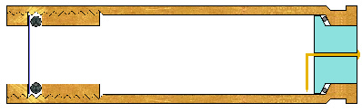

LeMaudit, I modified your design slightly. The aluminium insert gives all round spark gap potential and also reinforces the synthetic bit to make it less likely to blow out on ignition.
What I don't like about this is that the rear seal cannot be serviced.

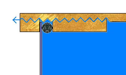

do you really need a servicable plug ??
untitled.gif - can be serviced as far as I can tell
Be my guest :D
What do you mean? You can access it from the front, by unscrewing the threaded rings... :? oh... right... the inner one is epoxied...
Me what I don't like is the thread... working on removing it :lol:

JSR;
Use Loctite thread sealant (blue) rather than epoxy for the threaded insert.
And again LeMaudit beat me to the 118 degree drill angle for the the rear seal. All the my ideas are being used.
The untitled gif looks like the most promising to prevent arcing externally.
Mon Jul 11, 2011 12:55 pm
What do you mean? You can access it from the front, by unscrewing the threaded rings... Confused oh... right... the inner one is epoxied
already told him there is no need to epoxy them

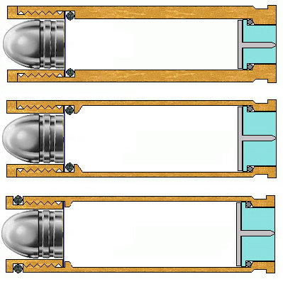

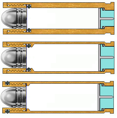

Nothing new here, but IMO it's not more complicated to cut it that way (top drawing), you have an easier way to unscrew the front, and it's serviceable.
If the volume need to be increased and you're bored, a tool of the same name will easily cut in one swift movement the intricate internal as shown in the center drawing. You just drill through, insert the boring bar, and cut.
As a bonus in the bottom drawing if you put the o-ring externally, no risk to be damaged by the heat or removed by the blast, and also it may be useful as a seal in the barrel (?) But I'm not sure it would seal the chamber that way.. would it?

That last one will not seal, there is nothing to keep the o-ring from being pushed out.
I'm guessing the burst disks have to be fairly rigid to not pop out ? Unless the o-ring is compressed in which case there needs to be a gap between the body and the screw in insert for tightening.
I was afraid about that :?

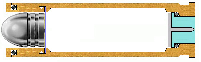

[edit] Right! Last one: Serviceable, & sealed the Dimply way
