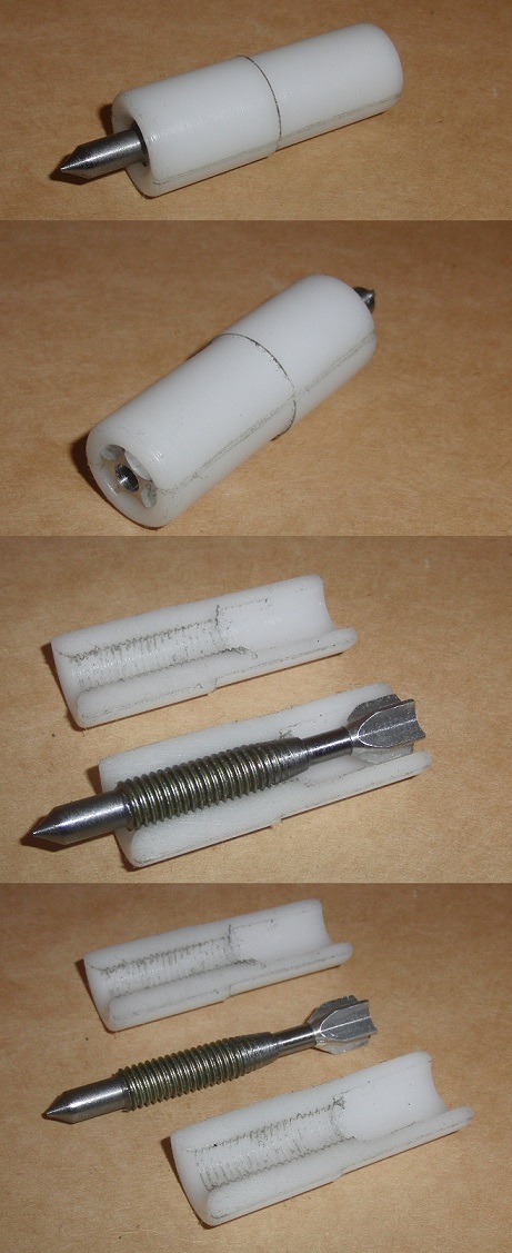

Sadly the darts did not live up to expectations.
taofledermaus wrote:Darts: shot- results
We shot the darts today. None of them worked. It seemed the fins were stripped off or broke off at the moment they left the barrel, so the rods just tumbled through the air. The 3 bolts that you made worked very well, and were pretty accurate. They flew perfectly straight, so it isn't all bad news.
I'm guessing that since they are only supported at the base, on acceleration the metal body skews to one side and these torsion forces are enough to break the fins. Back to the drawing board :)
Has thanked: 581 times
Mon Aug 12, 2013 4:21 am
Here we go, plan B - something very similar in design to a "proper" APFSDS round :D

jackssmirkingrevenge wrote:Sadly the darts did not live up to expectations.
Was the barrel used making use of a choke or a slug barrel? Just a thought.
How are the fins attached? I am thinking the fin assembly seperated rather than breaking the fins.
Which ones were the bolts he referred to?
Mon Aug 12, 2013 5:09 pm
dewey-1 wrote:[Was the barrel used making use of a choke or a slug barrel? Just a thought.
Smoothbore unchoked, that would have been a basic mistake :)
Nope, shattered. He said in the slow mo the fins and shredded wad came out before the bolt.
This is what he had to test, apparently only 3, 4 and 5 were successful, the rest shattered in the barrel.
Jsr, i like the new desine,but i think that the dart itself will not fly right if you dont have deterline fourths so that the wings dont get caught.
The balle sauvestre uses two sabot "petals" and seems to work well enough.
I'm confident these will work so I made four more:
