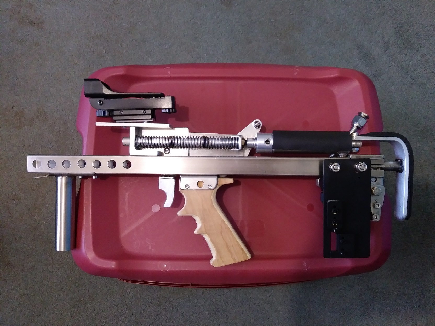

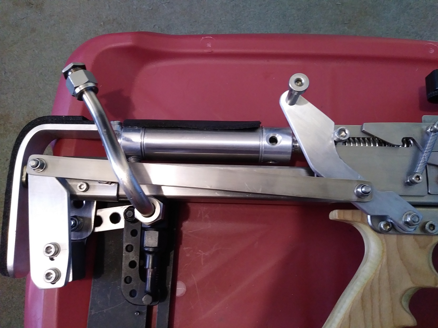

Got everything working, charging and loading is now from the side handle, the front grip is fixed, this allowed me to cut off a bit of weight as well. :o

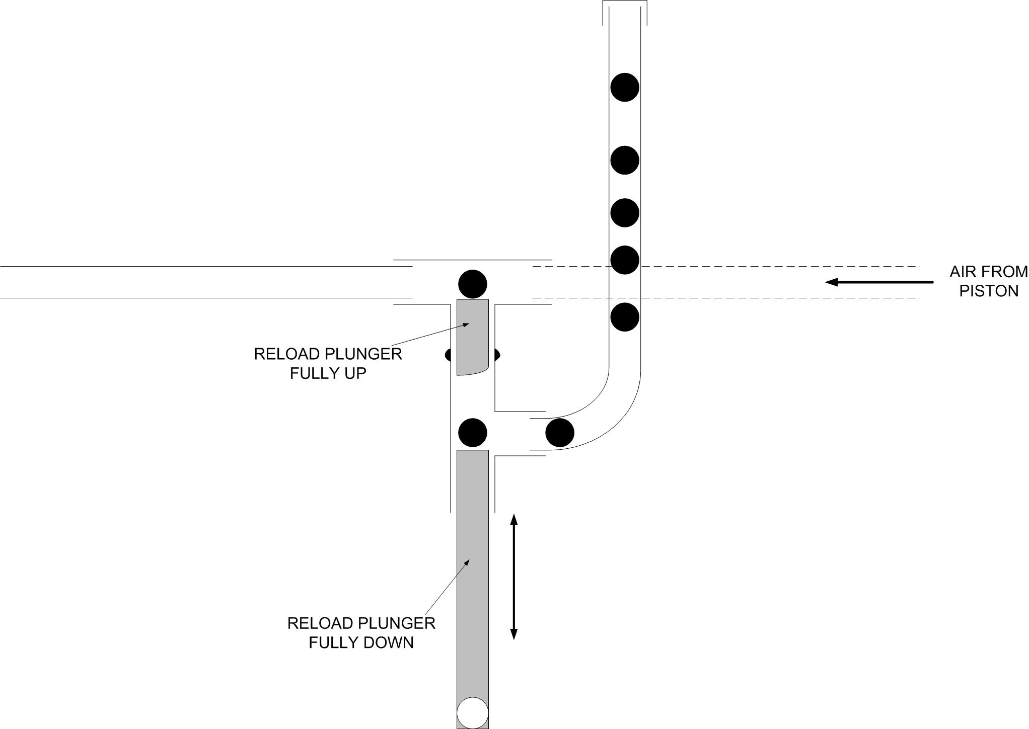

Neat, is that tubing the magazine? If so how are you handling loading one round at a time?

Yes the tube at the rear is the magazine, it holds 22 BBs and gravity feeds one at a time when the plunger goes down, the last few don't feed well as they are horizontal and are not pushed from above, so I normally shoot like 10 then reload it.
