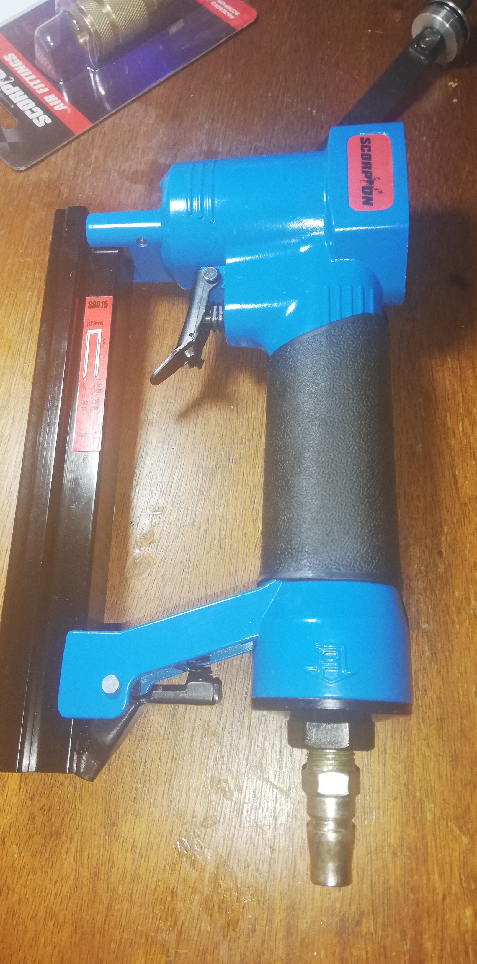

Hi.
Idea convert stapler to blow forward.
Had some questions.
There in pics.

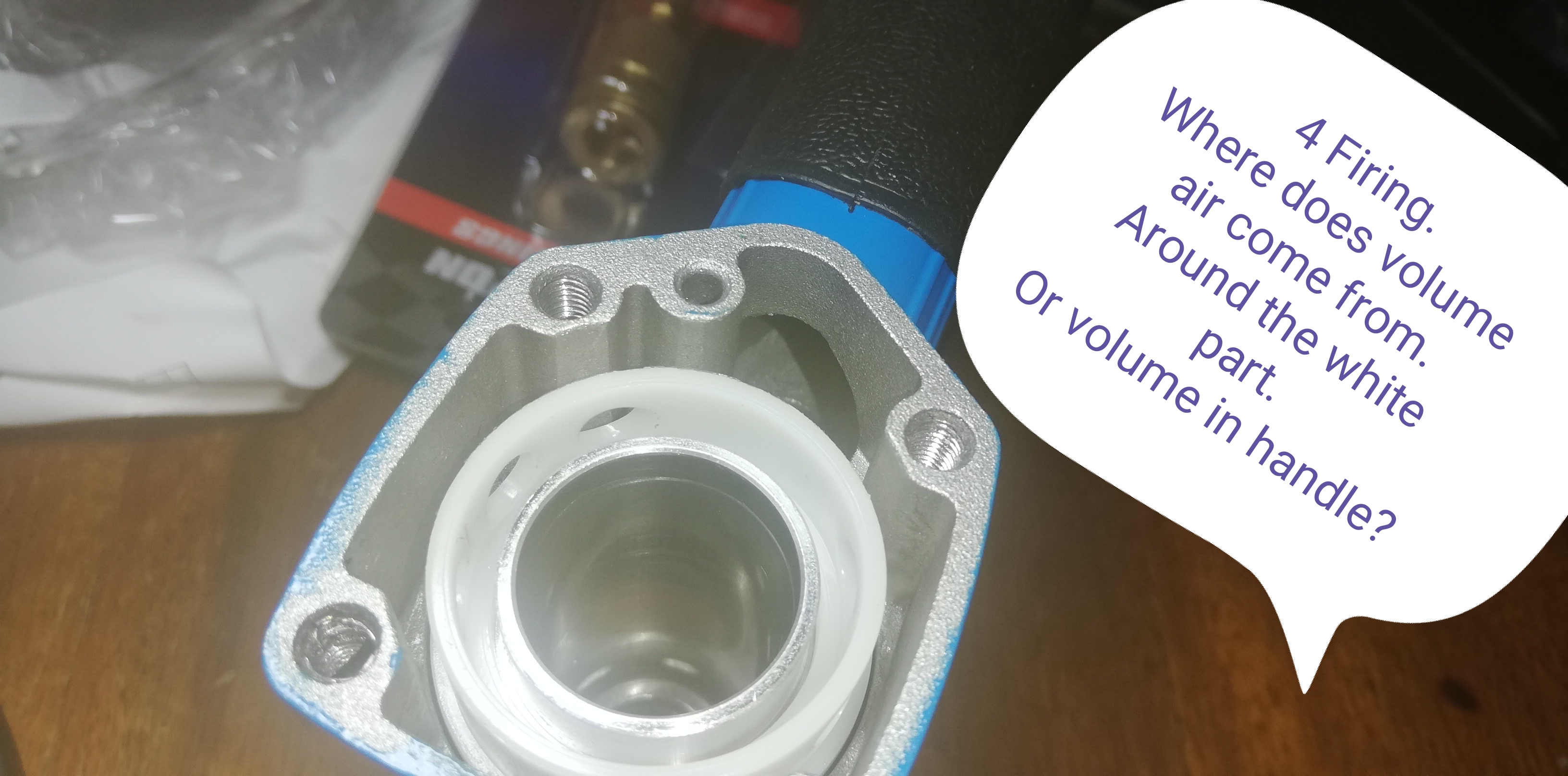

Air/chamber volume.
Air/chamber volume.

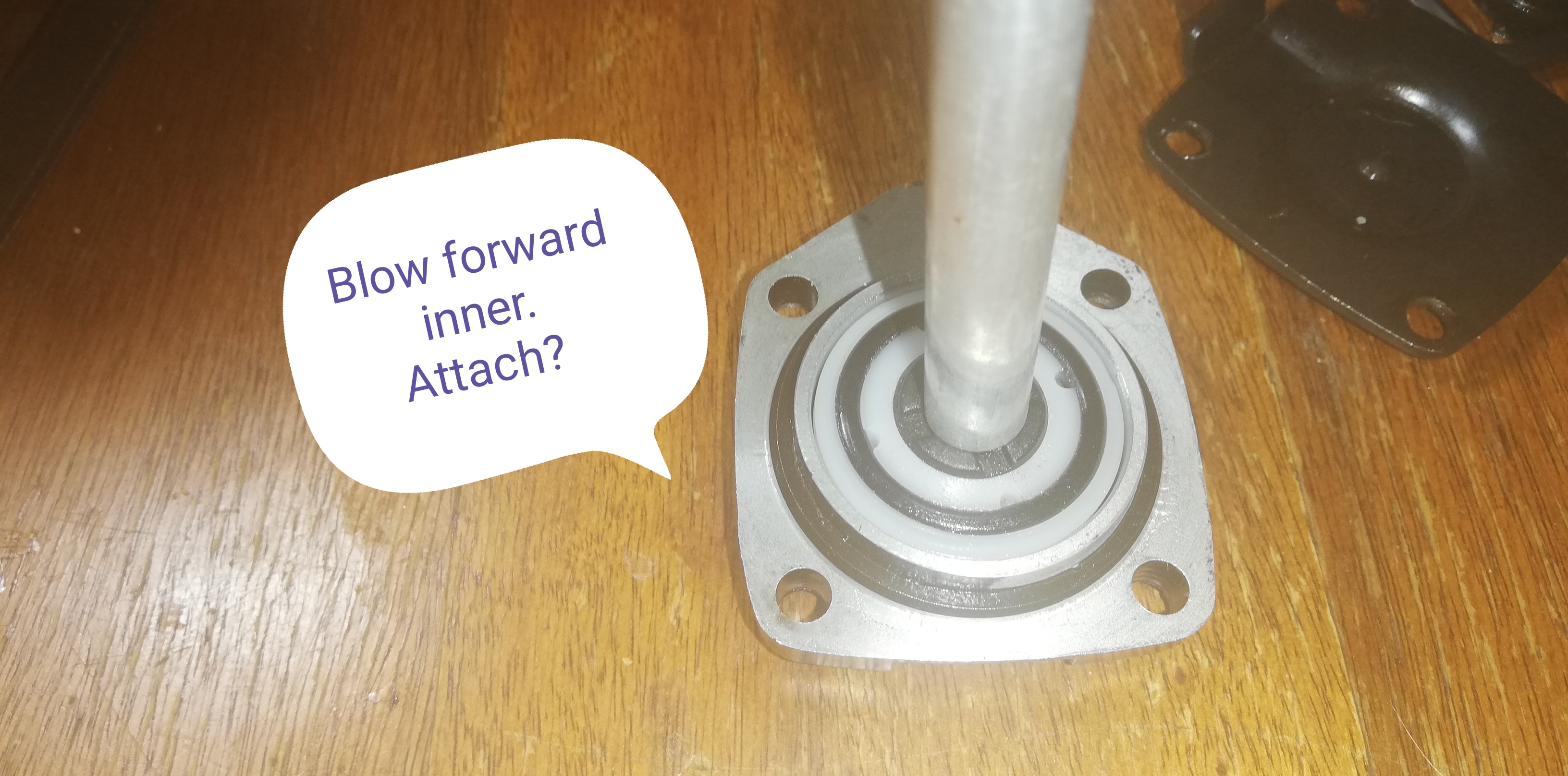

Piston return
Piston return

Attach piston inner here, is that right?

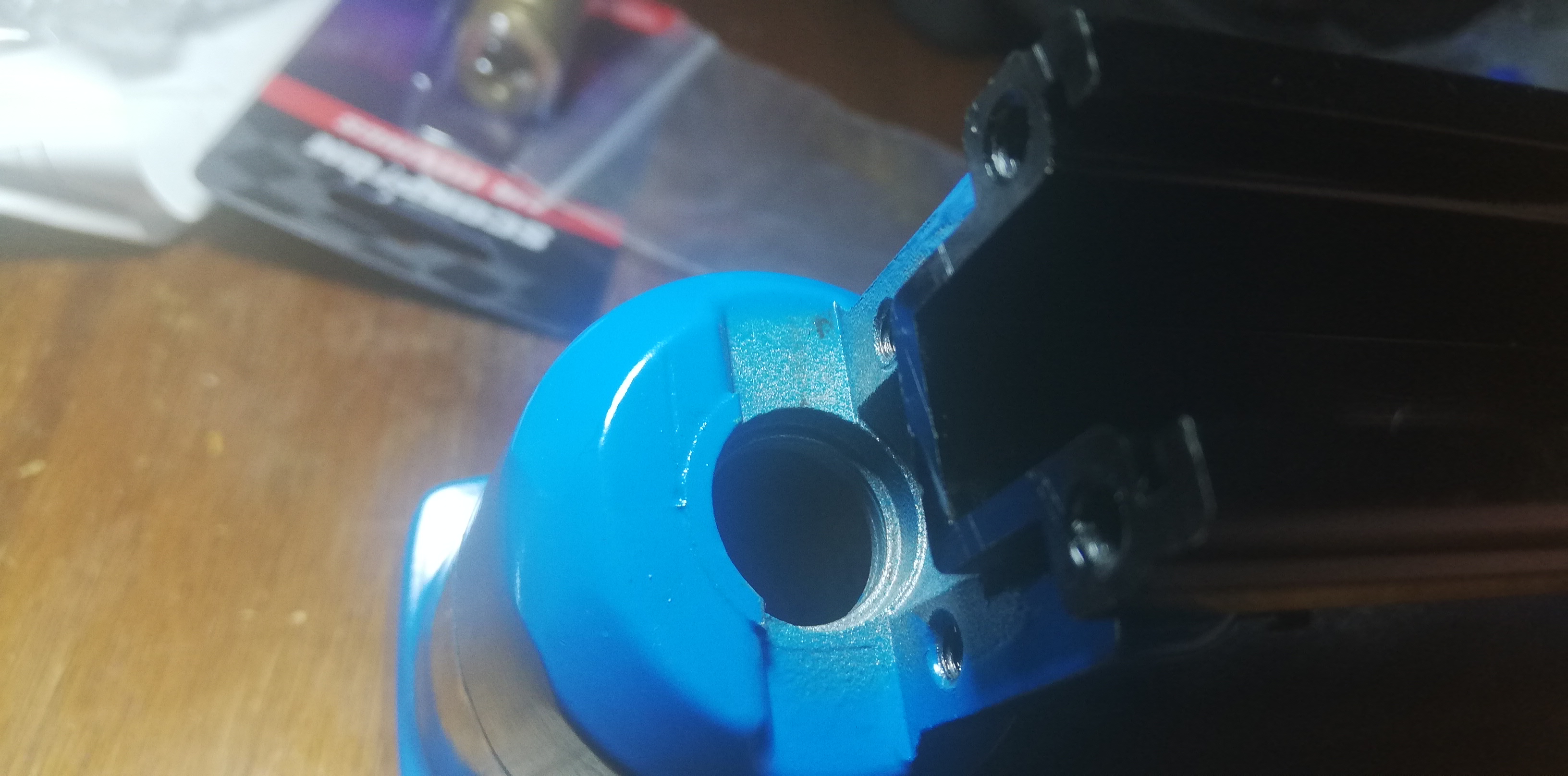

Some mods, but nozzle come out here.

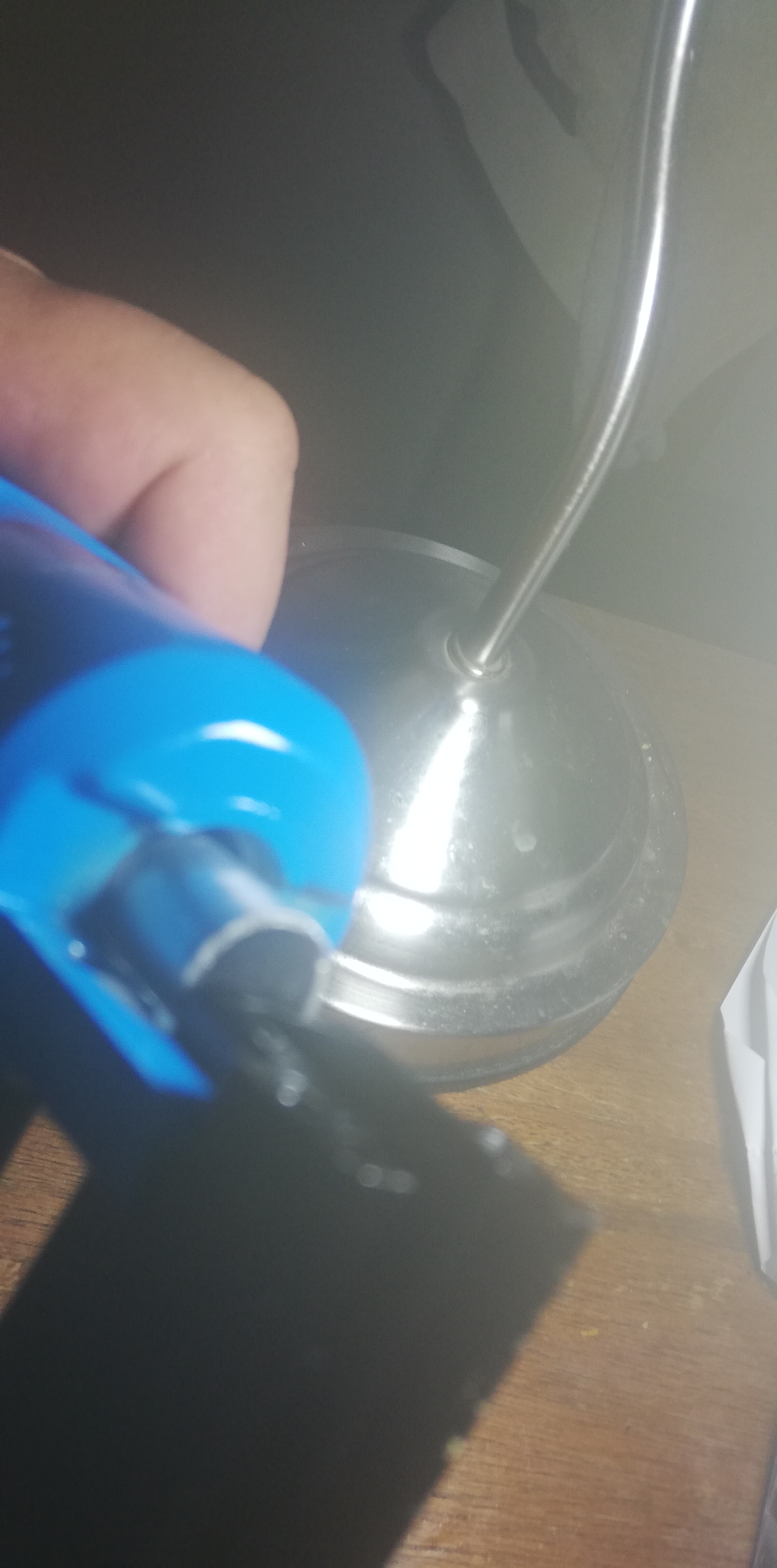

Have to make o ring thing for shaft here I think.

Gather this port from trigger. Still unsure where volume comes from.
This stapler.
This stapler.

Found another, explains the small holes in cylinder for piston return, in that diagram nailer is fed from Seperate chamber.
I think could do, hav to block above the trigger.
Makes the around white plastic storage pressure volume. (then Seperate from in handle).
I thought that's how it operated.
But the air from trigger pushes piston. To seal off chamber.
Dosnt allow air to bleed into surrounding chamber (white plastic part with holes in pics)
Fed from within handle.
Maybe just getting ahead of self,
I thought be air hungry with volume coming from handle.
