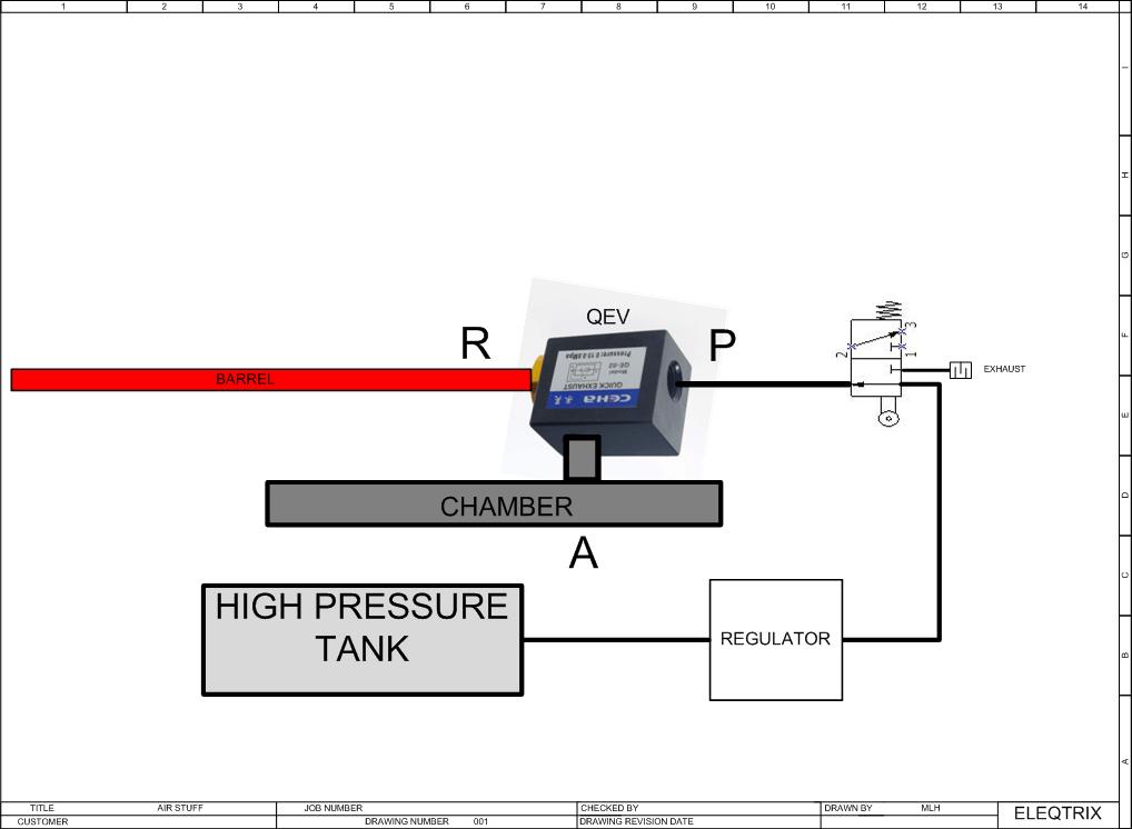

The "out" port of the pilot connects to the "P" port on the QEV. Port "A" on the QEV has a secondary air chamber, and "R" connects to my barrel. The "in" port on the MJVO-3 has a quick connect fitting which attaches to my HPA tank and regulator.

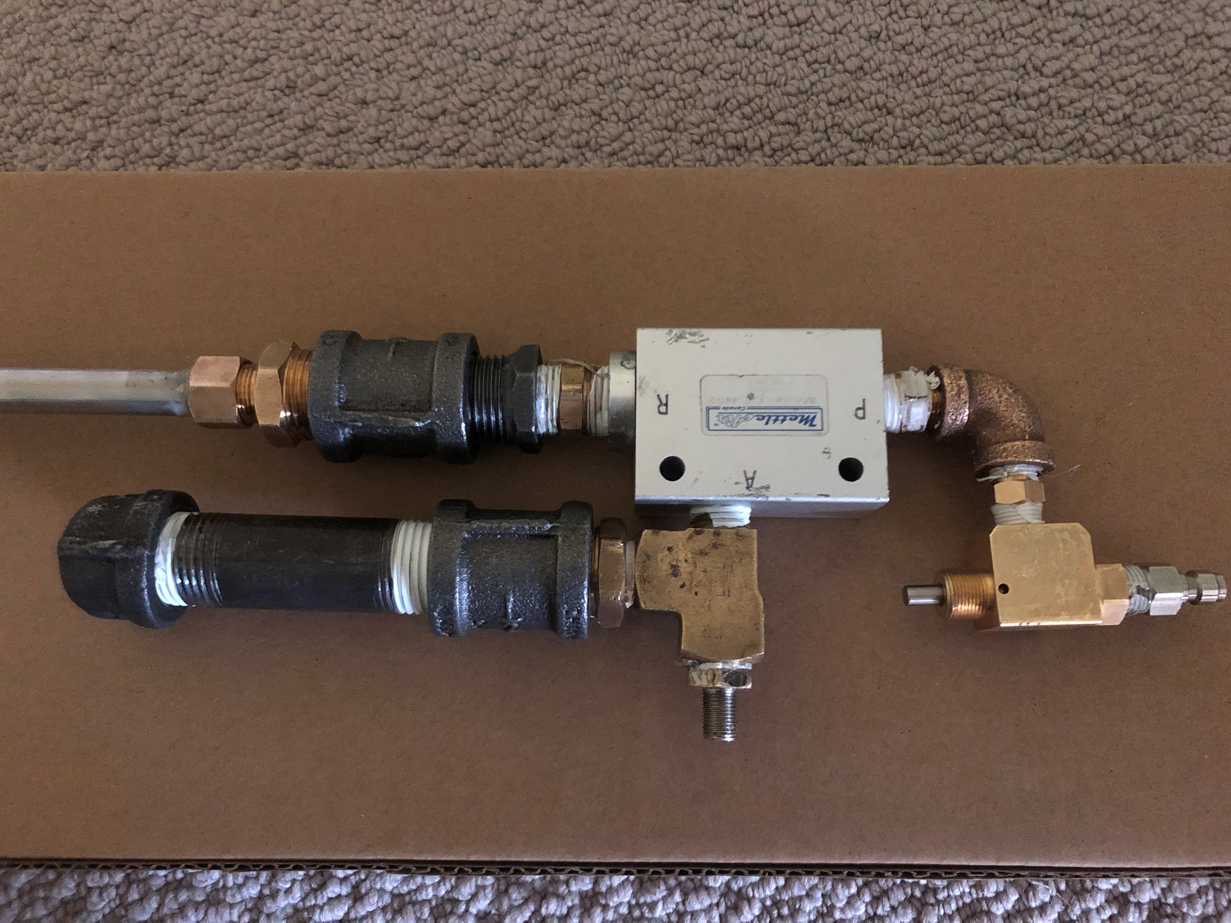

Here is the entire cannon

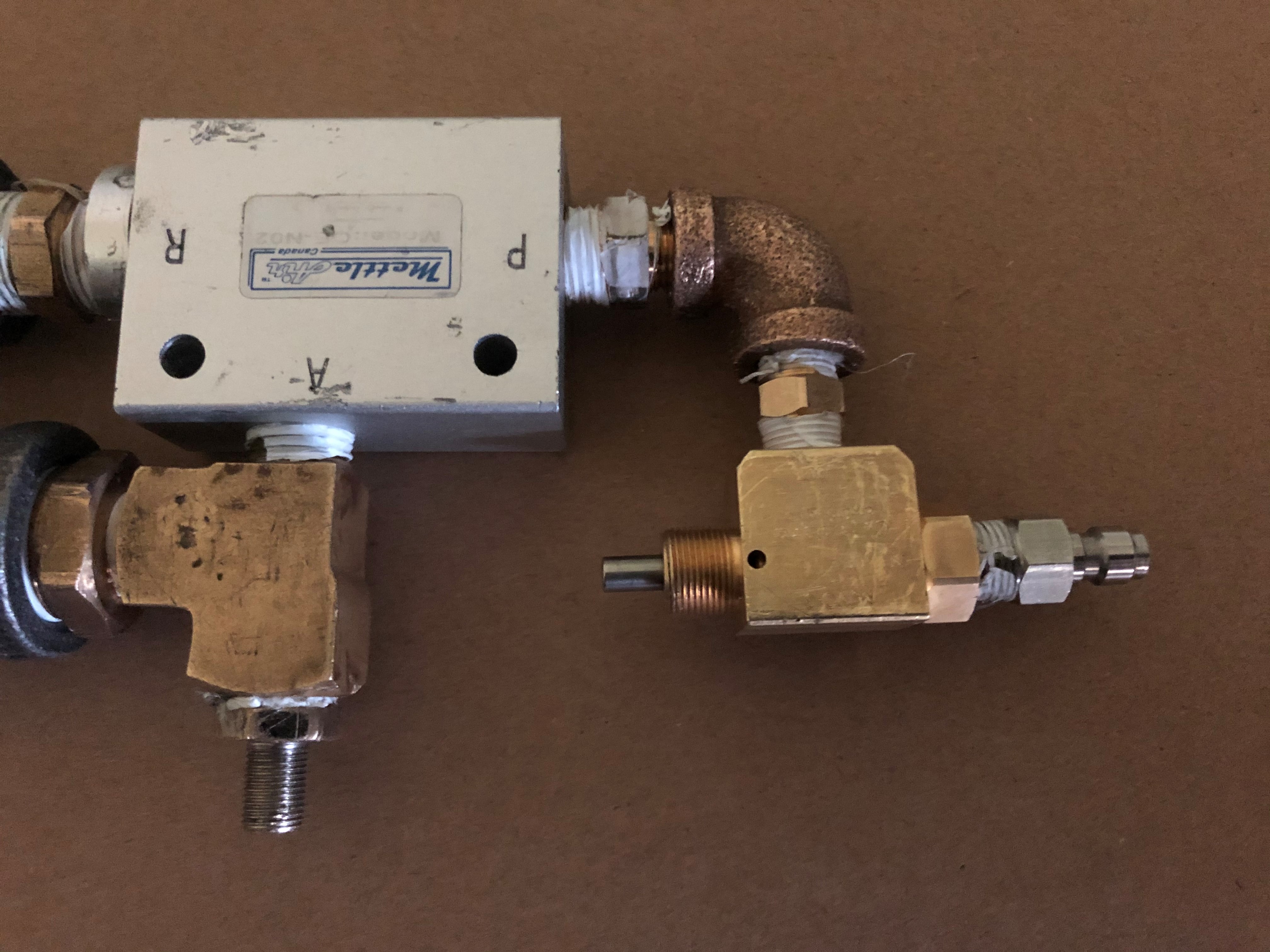

And here is a closer look at the valve configuration
Any help is appreciated! Thanks.

Components look good, you are filling from trigger valve (P). This is how I run mine
Trigger valve is normally open then blocks air feed and dumps P port to atmosphere to fire QEV. I think maybe you need to flip the connections on the MJVO-3. Hmmm, now I look at the connection diagram it appears as if you have it correct. Almost like the QEV is stuck, is the air getting into chamber ?

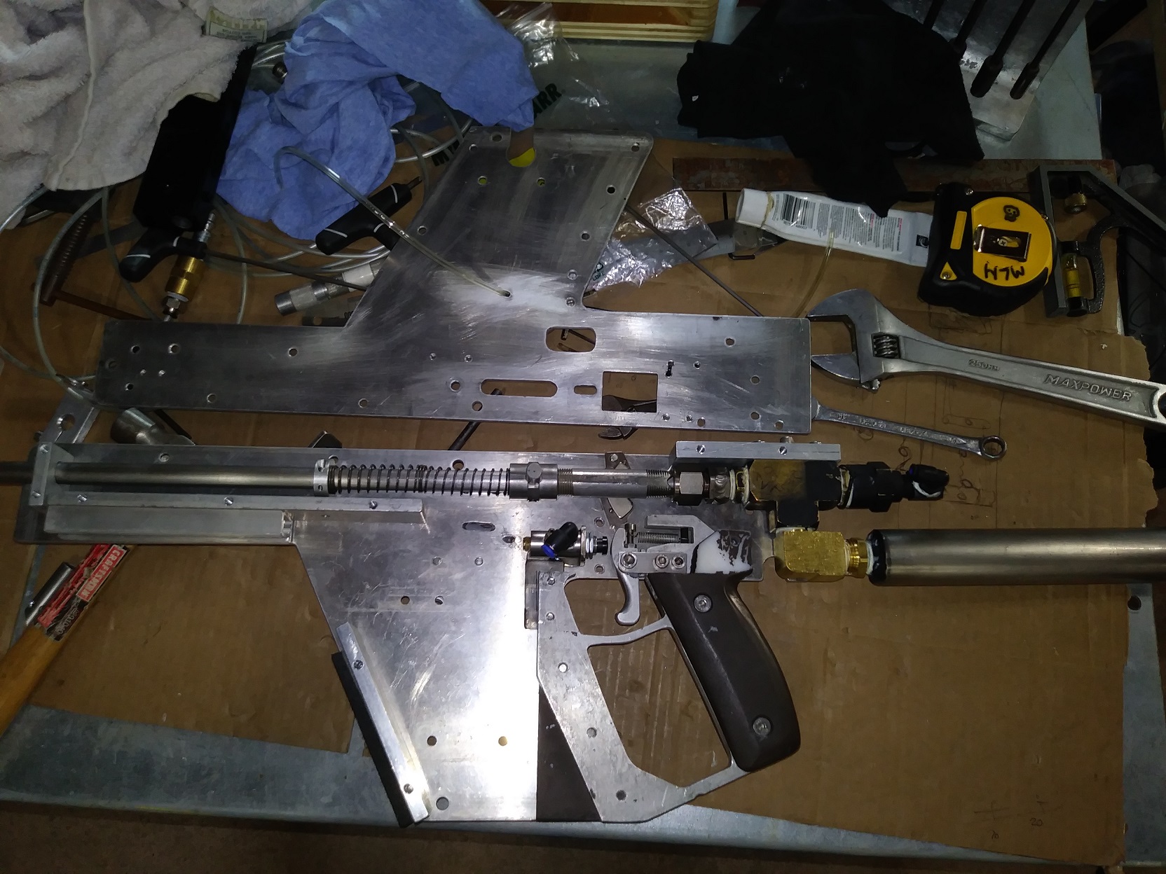

Just finished a 10mm ball bearing launcher with homemade QEV, they do work excellently.

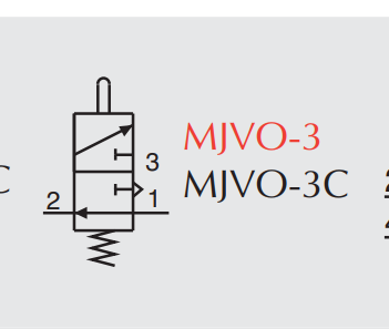

The Clippard MJVO-3 is working as intended described by the manufacture. Under "Additional Information" on the product page it states "Exhaust-To atmosphere through holes in body.".
https://www.clippard.com/part/MJVO-3

I've independently tested my QEV using a slide valve, and it functions as expected; properly filling the secondary chamber and releasing air out the barrel. I even added more lubricant to the QEV to ensure the cylinder was properly cycling.
I also tested the MJVO-3 on its own (hooked up to my regulated pressure source), but I was having the same problem - air was only coming out of the side holes and was not being released through the "out" port of the valve.
I understand that the MJVO-3 releases to atmosphere in order to properly function, but I'm surprised that it is doing so without also releasing air from the "out" port. I could also try reducing the volume on the "P" side, but it is already fairly small.
I'm considering returning/exchanging my current valve. Could it possibly be defective? It seems to be the common variable in my tests.
