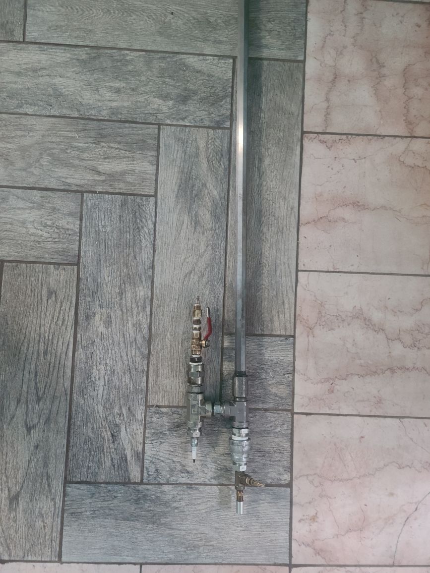

So I've put something together, its a hybrid clone of my phenumatic rifle. Right now they share a barrel but it will get its own dedicated when complete.

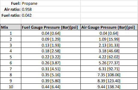

For the time being I have had a few successful test shots at 10x using the chart from the forum. They are hard to repeat. But I have had some success.

I have been using the chart posted in the forum, I haven't done any calculations.
For 10x 6.44 ~6.5 psi propane
138.74 ~ 140psi air
Are you saying I need to subtract 15 psi?
So 6.5 and 125?
I’m a scientist; because I invent, transform, create, and destroy for a living, and when I don’t like something about the world, I change it. ~Rick Sanchez.
Sat Dec 19, 2020 8:25 pm
The table you are using seems to account for this, with the air gauge at zero for 1x.
One thing that might be throwing off your mix is the volume of the pump between the launcher and the pump's check valve, can you measure the volume of the hose?
Basically once you connect the pump the propane from the chamber is going to flow into the hose and dilute your mix.
