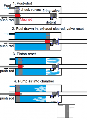

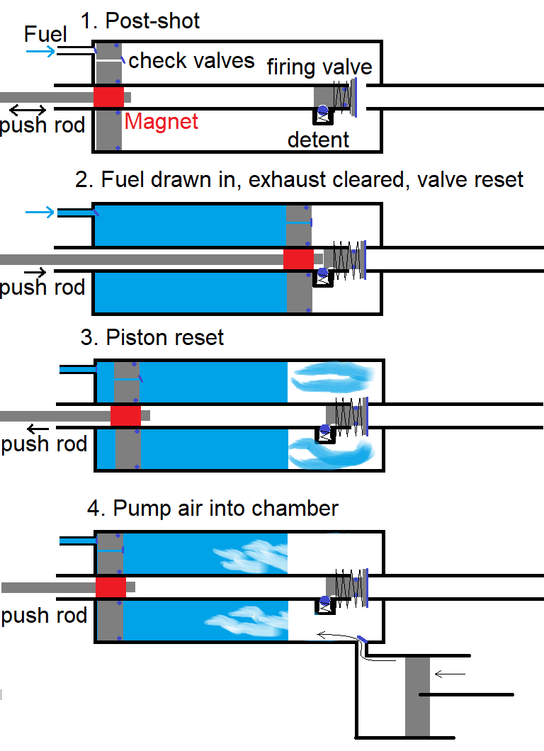

At 23.8x mix, I can use the chamber itself as the metering volume. That kills two birds with one stone: I also blow out the exhaust that way. I'm not sure yet how to do all the valving, but I want it to be simple. I'm toying with the idea of using a lighweight piston inside the chamber that is used to push the exhaust out the barrel after the shot, meanwhile drawing fuel into the rear of the chamber. Then this piston retracts, allowing the fuel to pass through using a check valve. This scheme requires a firing valve that stays open after the shot, and is then closed after this operation but prior to the pump stroke. Perhaps a pop-off-style valve that sticks to a magnet & then gets bumped closed by the exhaust piston? I think this fuel/exhaust piston could be driven forward and back at the same time the bolt is cycled to load the next pellet.

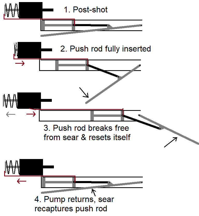

Here's what I was thinking for the fuel/exhaust cycle:
When the gun fires, the firing valve piston gets trapped by the detent, so it stays open post-shot. Then, the push rod is pushed forward, drawing in fuel through the check valve from a near-atmospheric-pressure fuel reservoir (eg, syringe or balloon). At the end of the stroke, the push rod releases the firing valve from the detent, closing it. Then the push rod is withdrawn, and the fuel flows through the check valve in the fuel/exhaust piston and occupies the chamber. Finally, the pump pressurizes the chamber with air.
I'm thinking that the push-rod could be coupled to the loading mechanism, so that a new projectile is loaded at the same time. The push-rod could also be coupled to the pump, so that as the pump moves forward, it pulls the push rod forward until the push rod hits its limit of travel. At that point, the push rod disengages from the pump and returns using a spring. I'm still kinda fuzzy on the details of making that catch/release mechanism.

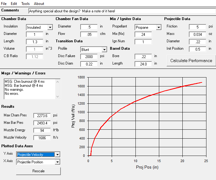

I also had a look with HGDT (thanks for reminding me about that!). It should be plenty powerful with 1 cu in chamber and 24" long barrel.
