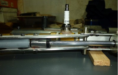

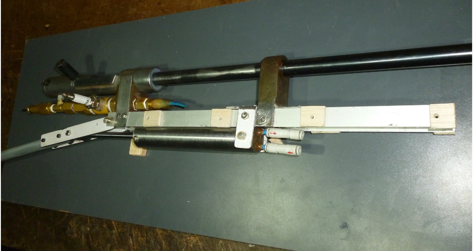

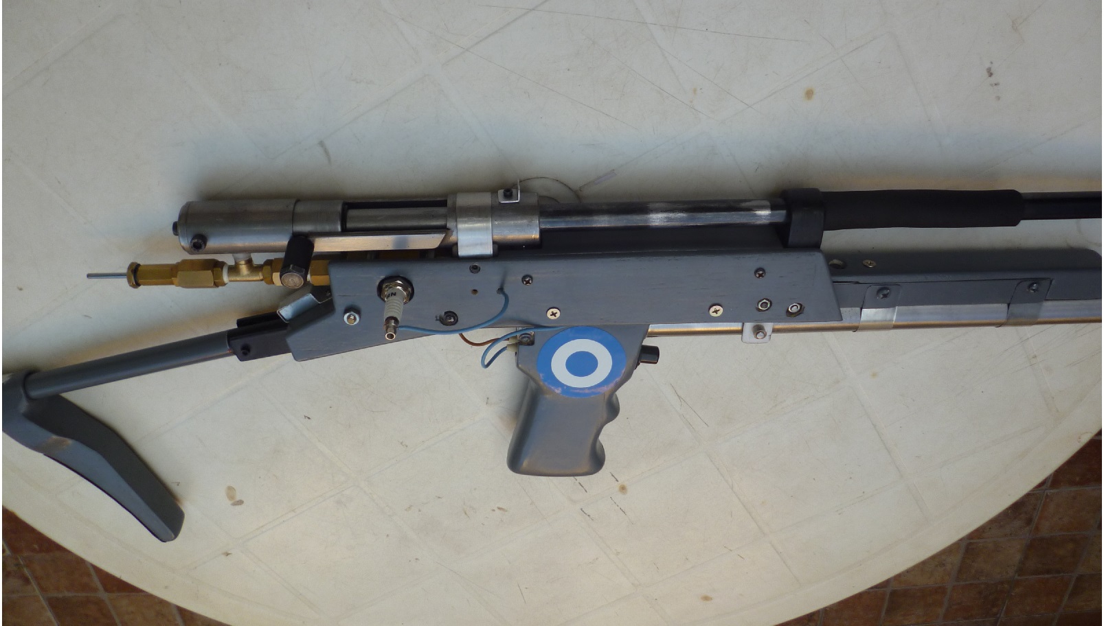

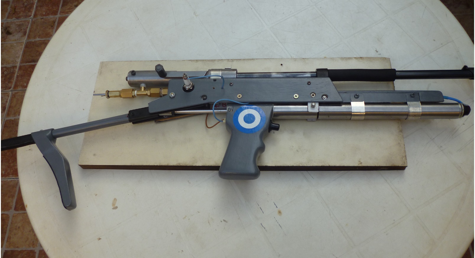

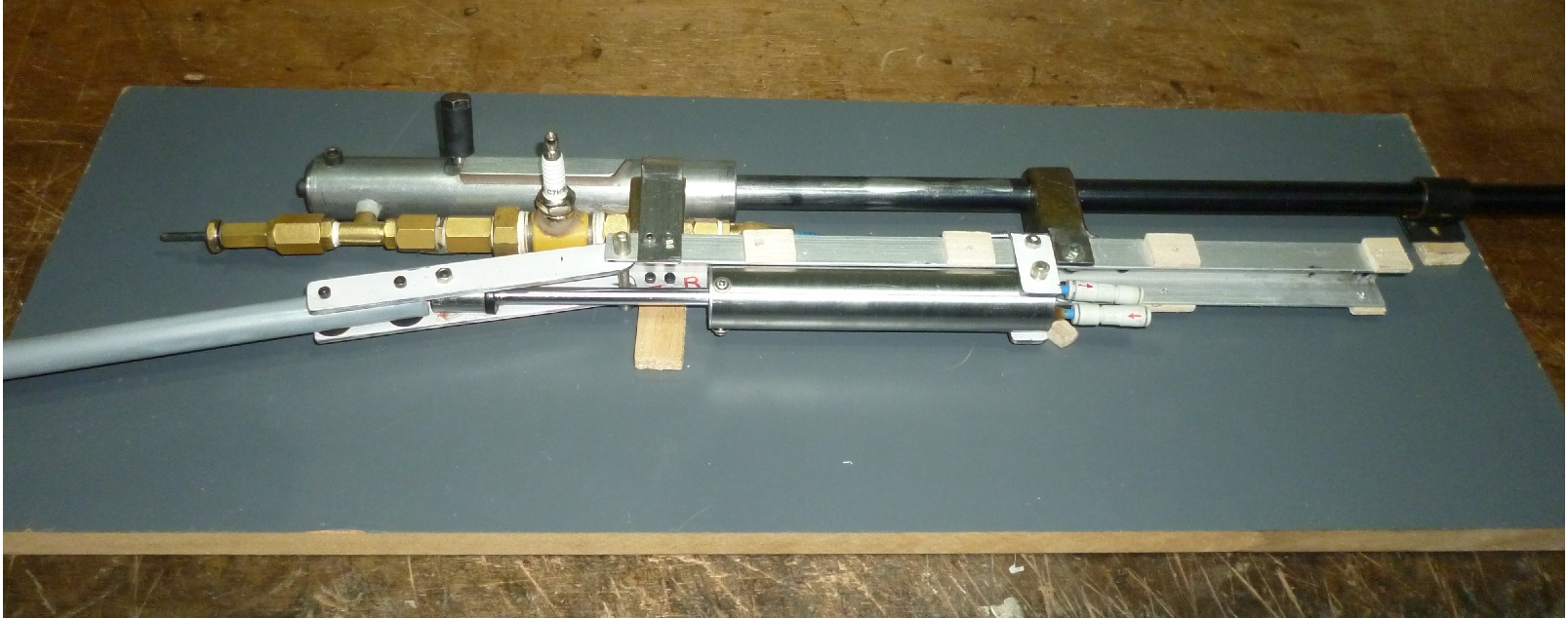

This is a project called "Armadas 1500 II". It is a weapon that works with an integrated air pump, it is a single shot, hybrid that precompresses at 8X - 10X.
The firing barrel is with 12 microgrooves, caliber .25 and fires common pellets. The inverted bolt is made of 1045 steel, the combustion chamber is approximately 20 ml. It has quite a bit of punch, going through 4 cans cleanly at 8X, with only 4 pumps.
It is an evolution of the previous ones, because it has more performance, 4 or 5 pumps are enough to compress the mixture and fire.
The dosing system is the standard one that I designed, and it works very well. Accuracy is excellent.

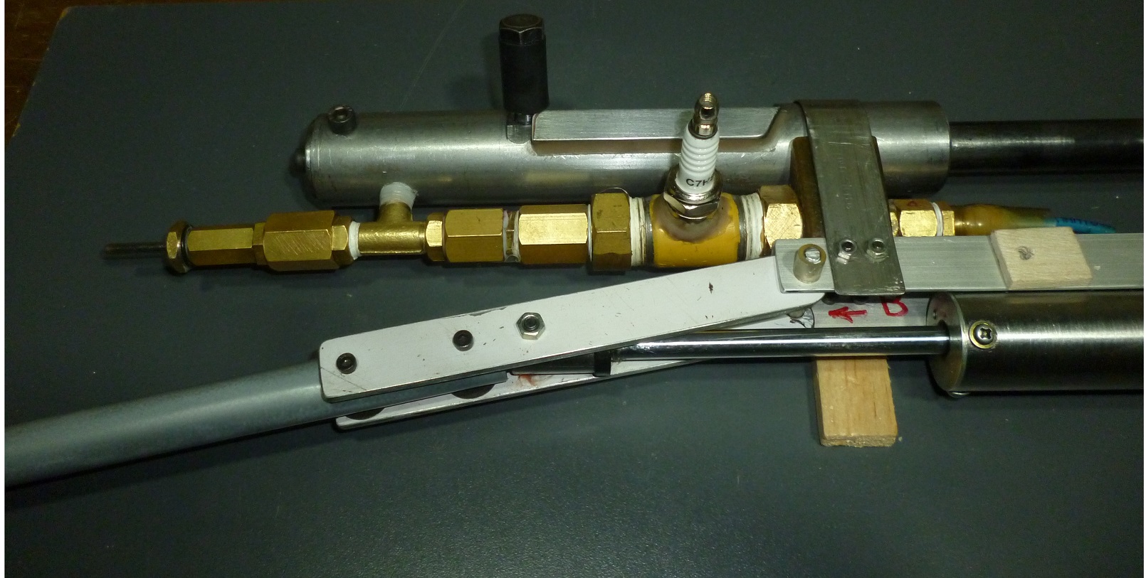

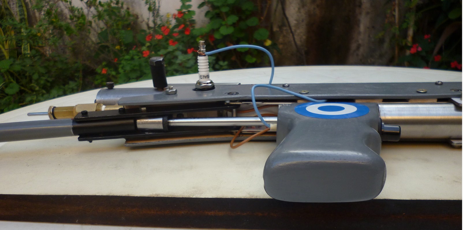

I used a motorcycle spark plug, screwed into the combustion chamber which makes it fire safely. The lighter is piezoelectric from the big ones.
The main valve is of the o'ring and ball type, which works excellent (it is the "captive ball" valve). The o-ring lasts about 150 - 180 shots before being replaced, which is easy, without having to remove too much.
The front tube houses the small liquid butane gas tank, and has its manually operated valve (pressed with the finger), to introduce the gas to the dosing system, about 6ml.
The sequence of operation is simple: You close the valve, place the pellets in the chamber, introduce the butane and give 4 pumps. The pumping lever, in this case the rear, includes the shoulder rest.
The ball valve - o'ring, is closed by pressing the small stem that can be seen on the back of the gun.

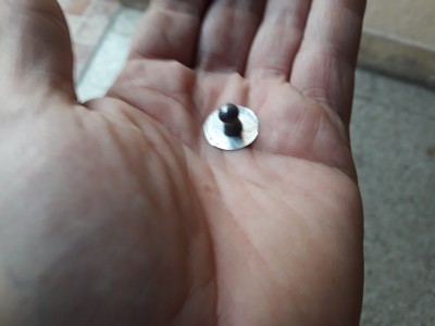

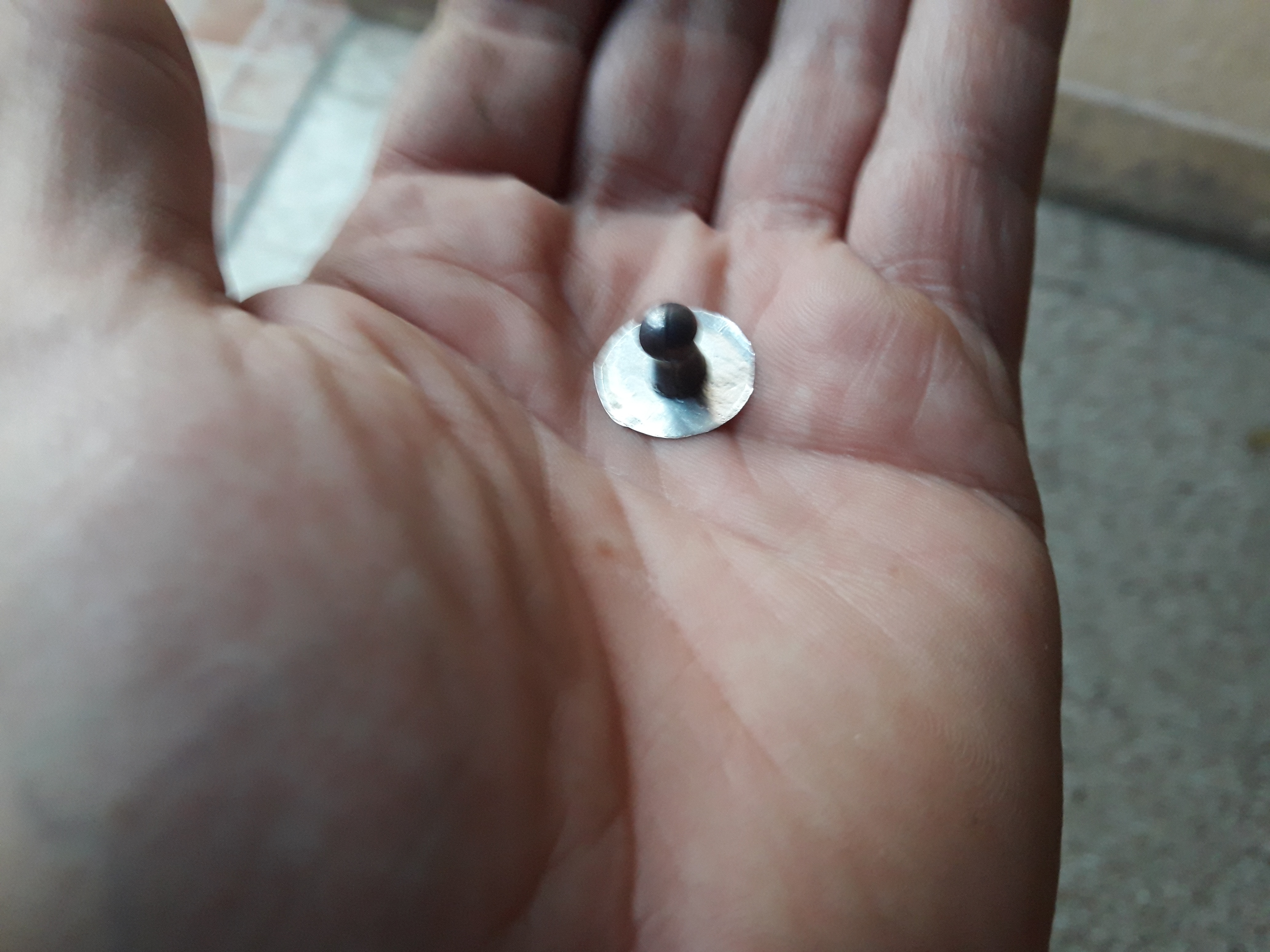

Adapting this weapon to shoot with rupture disk. It gave me more power and regularity in the shots. I love plain old bursting records...
I am using aluminized paper. I'm using two layers, which work fine for 9X of precompression that the hybrid has.
The face that is made of paper itself is faced and glued with non-wetting glue (glue stick), and the aluminum faces are towards the outside, so as not to be affected by ambient humidity, which in my place is a lot. .

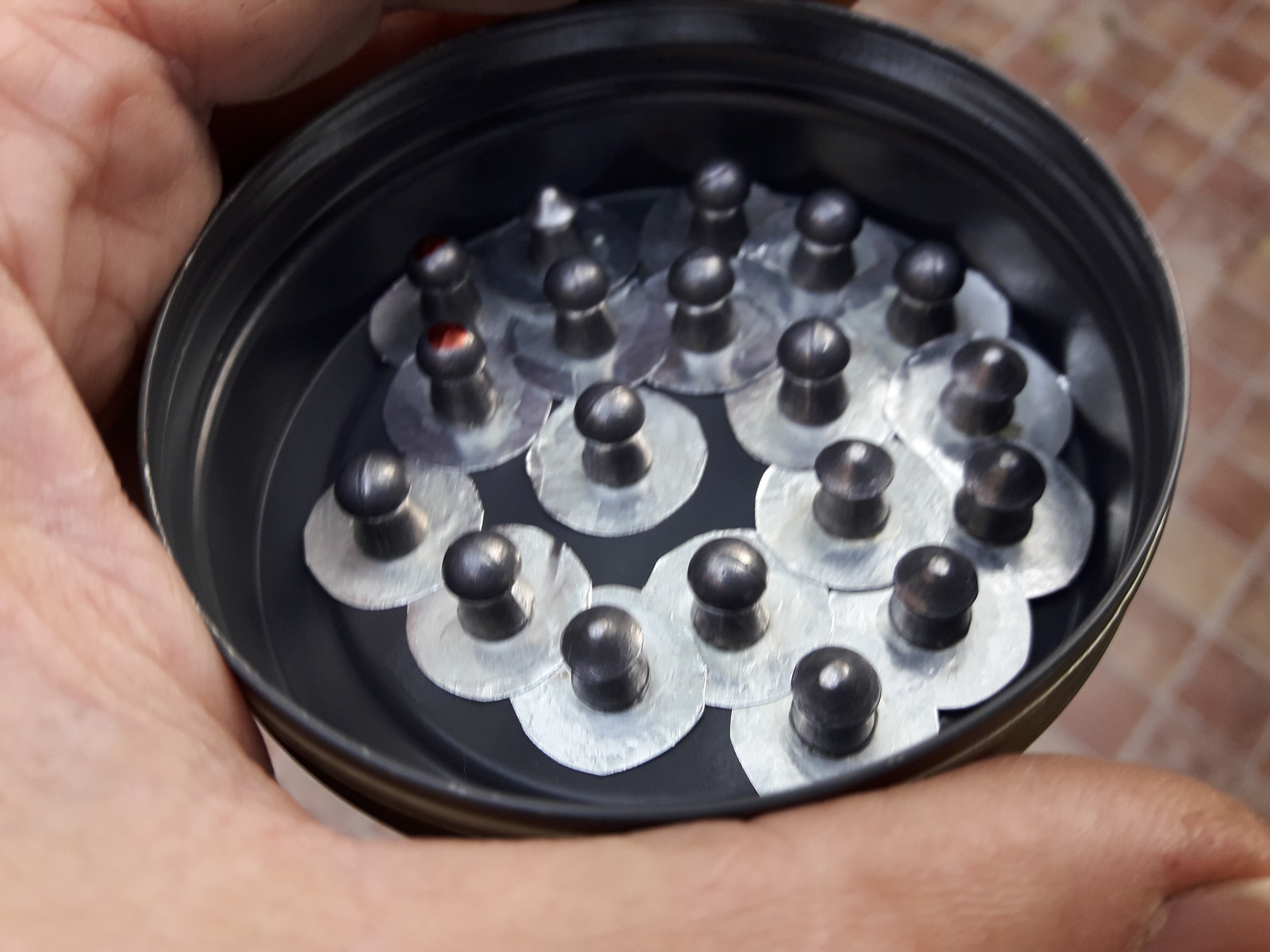

As it is a shotgun, I did not make cartridges, the pellet is simply glued to the sheet of double aluminum foil that is the material of the rupture discs, and it is cut with this tool. The center is the guide and the largest tube is the one that cuts the disc and they are finished.
For gluing the pellets I am using spray contact glue which is quick to use and can be put on the entire sheet, (for about 50 rupture discs).
It is easier to have the pellet and the disc as one thing, but without a cartridge, without a doubt. The good thing is that you do not have to make 20 or 30 cartridges, unnecessary for this weapon that fires one at a time.
I am using 33 gr .25 caliber pellet. The force of the shot is quite important, at 9X, I can pierce 0,7 mm sheet steel.
mm sheet steel.

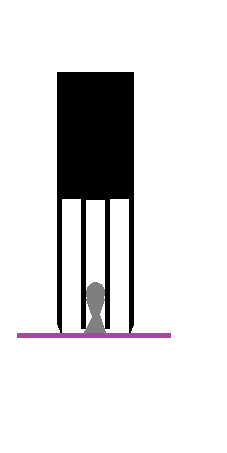

The "cartridges" that includes the rupture disk, seal o'ring and the pellet is as in the drawing. In case of planning a repeating or semi-automatic weapon, with an ammunition magazine, it is necessary to build many.

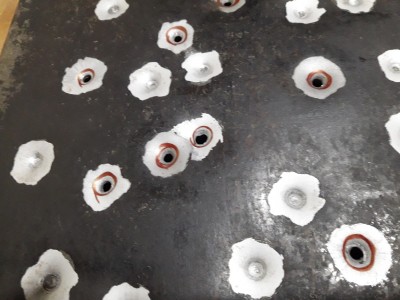

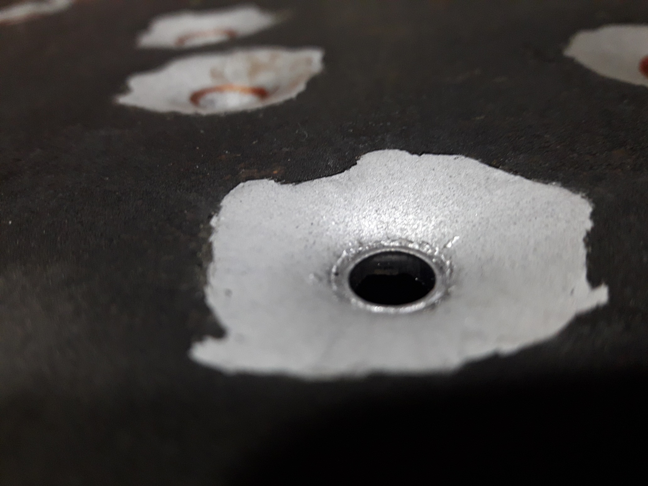

No, I'm just using the gun with two rupture discs. Surely you can break three, with a little more precompression load, I estimate with 10 - 11X. At present it is set to 9X. I think that with the energy he currently has it is enough to play at home, without a doubt, with more pressure he will become more dangerous.
This model can shoot with 5 or 6 pumps, which is two power levels. Despite being only a pump difference is noticeable when shooting.
The only thing that doesn't convince me is that the "skirt" of the pellet is "welded" to the target plate, it doesn't pass, only the "head" of the pellet passes to the other side... look at the photo.
