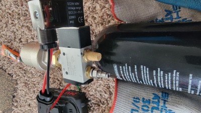

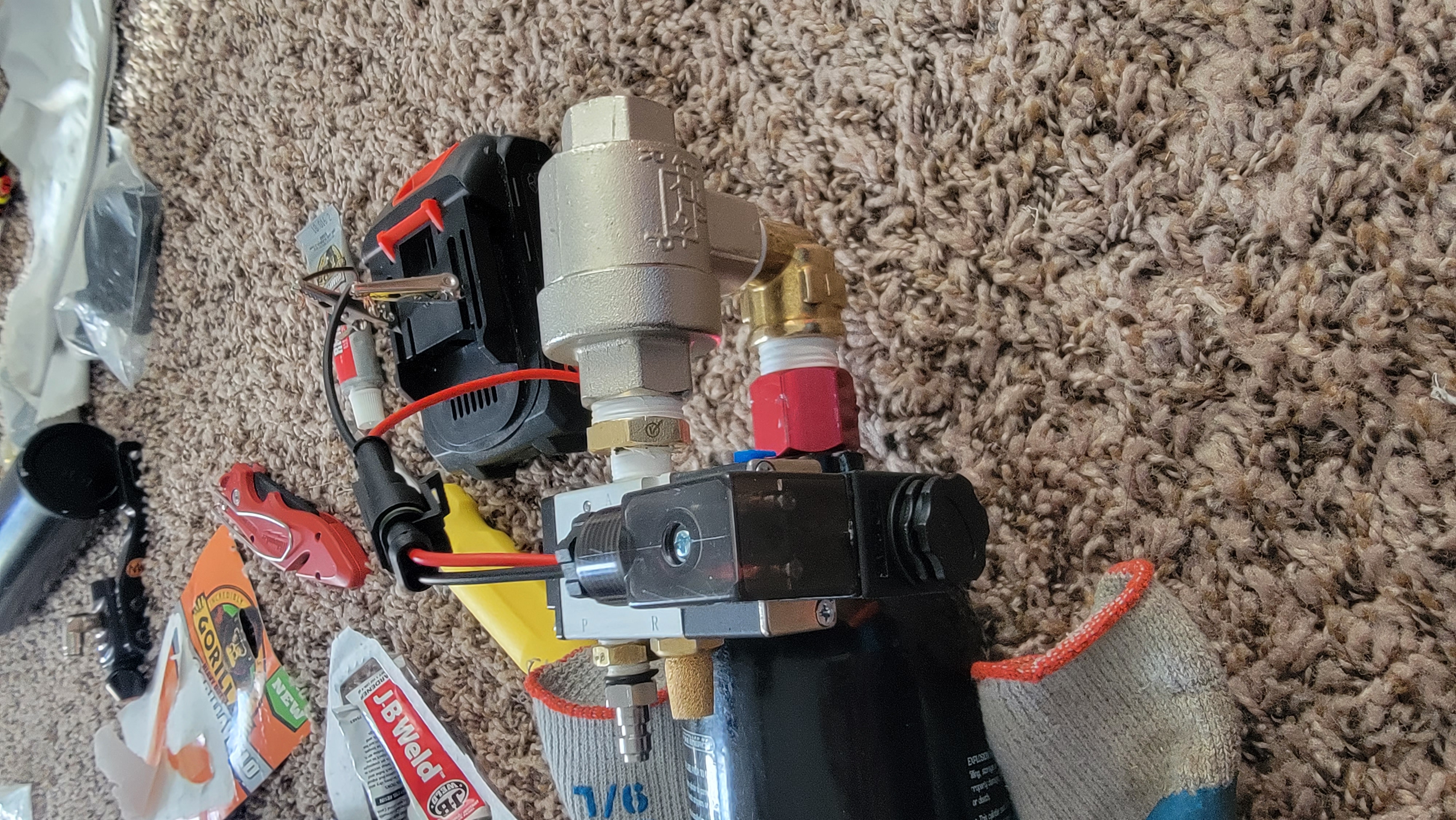

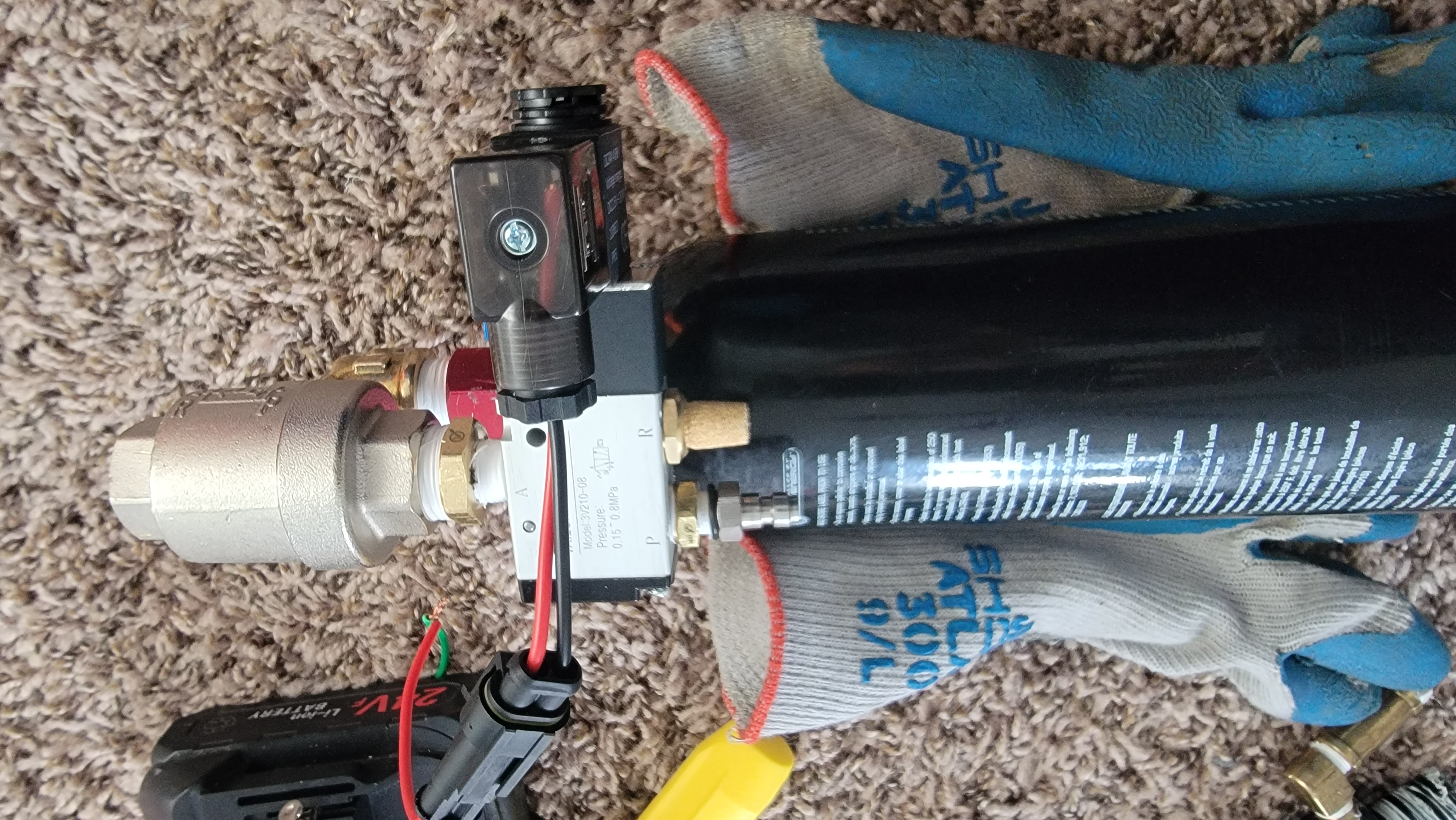

Hi I'm having trouble with a solenoid valve for a qev cannon! The issue is the valve is working but in the opposite way I need it to. So when the trigger is pressed the valve is activated and allows air to flow through the valve past the qev and into the fill tank, when I release the trigger it then closes and dumps the air from the fill tank through the qev. I need the opposite of this action. Need it to fill the tank automatically then with pressing the trigger shut air off and activate the qev dumping the fill tank! Did I get the wrong valve and solenoid or can the action of the valve get switched? Any help would be greatly appreciated! Pictures of current configuration

Assuming you have a two position three ported valve, the ports should be as follows:
P - inlet
A - outlet
R - exhaust
Depending on whether the valve is normally closed or normally open, gas can flow from P to A when not energized and from A to R when energized, or vice versa.
From what I can see in the images you've shared, you appear to have hooked it up correctly, I'm assuming the nipple on P is connected to your main chamber and A is connected to the QEV pilot.
If that's the symbol on your valve, I believe it could mean that the valve is normally closed, in which case you would have to switch P and R.
