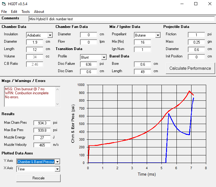

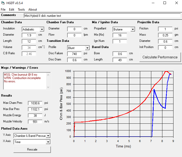

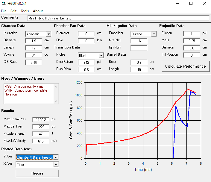

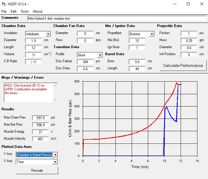

One of the experiments I've done with this project to to see how burst disk strength influences performance. Intuitively one would tend to think that the stronger the disk, the higher the pressure it will burst at and therefore the better the performance will be; this might be true of a pneumatic but not necessarily the case with hybrids.
In this case I was using layers of photo paper for disks. At 5x with a single disk, the latter did not burst upon ignition, however it did burst when tested at 10x.
I then fired four shots with progressively more disk layers added and got the following results (velocity in feet per second, energy in foot pounds, velocity in meters per second, energy in Joules) and in all cases the shots were at 16x using 0.25 gram airsoft BBs as a projectile.
1 layer - 1525 fps 20 ft lbs 465 ms 27 J
2 layer - 2010 fps 35 ft lbs 613 ms 47 J
3 layer - 1808 fps 28 ft lbs 551 ms 38 J
4 layer - no burst
As can be noted , the highest energy by a significant margin happens with 2 layers.
I've tried to model the observed data in HGDT but was unable to get the performance with three layers match by raising the burst pressure.
1 layer and 10x mix:
1 layer and 16x mix:
2 layers and 16x mix:
3 layers and 16x mix:

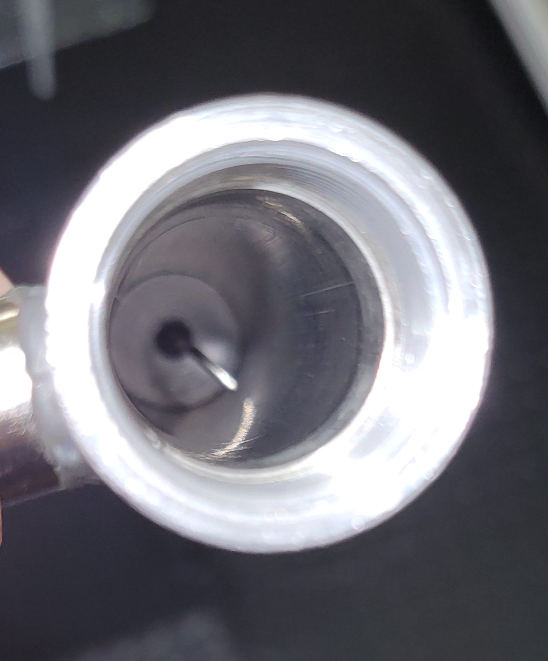

Question: How smooth is the interior of your guns? In the case of VERA we tried a couple different burst pressures and while the pressure ramp to the disk burst was obviously longer for the high pressure burst, the muzzle velocity of the gun was indistinguishable... Which made sense given that in both cases we saw the afore mentioned step function in chamber pressure. The only rational answer was flame propogation rates going to high velocities when things started to actually move. This effect would be affected by the chamber's interior, however. The more bends, rough surfaces, and such, the faster the gases would go turbulet. With that said, VERA has a fair amount of equipment mounted internally and the construction (steel pipe) means a less-than-glass-smooth surface. By contrast, if you're building a gun out of a straight piece of very smooth interior pipe? OK, maybe turbulence doesn't dominate so quickly.
In the case of my testbed it's very smooth, this was also a cylinder in which a piston was moving so it had to be.
Perhaps it's worth adding some basic baffles as an experiment.
