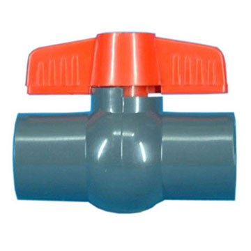

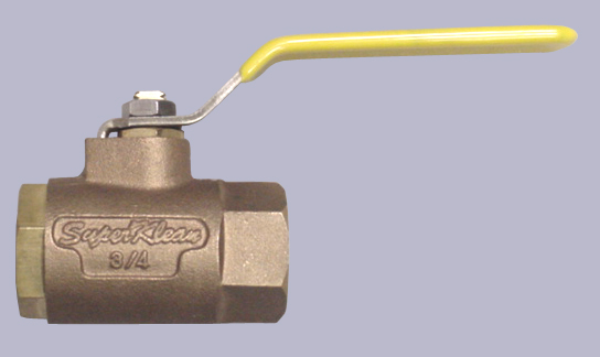

my friend built a similiar cannon and it shot less than 50 ft with the ball valve but if you do choose to use a ball valve use metal not plastic because the metal (brass) ball valves open much quicker than plastic
plastic
plastic
z plastic ball vale.jpg (14.95 KiB) Viewed 5025 times
metal
metal

Metal ball valve>plastic.
They are easily reusable and cooler.

plasitic are reuseable just put a male or female adapter at the end

Thu Feb 08, 2007 2:27 pm
They still suck

im not saying that they dont i was just trying to clear it up for anybody sitting there going ? there not reusable
