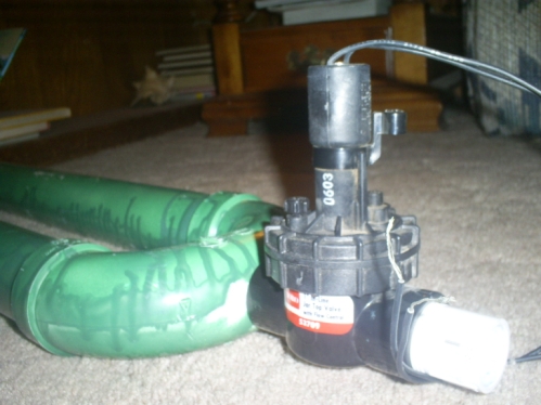

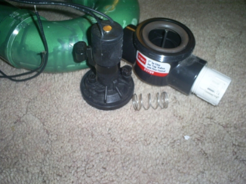

how is this valve? I have seen just about every valve on here but this one.
[albumimg]327[/albumimg]
[albumimg]326[/albumimg]
would it be ok to remove the solenoid and drill right through that? From what I have read the rod is on the bottom, which is a good thing right?
veginator
Posts: 186
Joined: Tue Apr 10, 2007 4:02 pm
Sat May 19, 2007 7:41 am
i dont think it would be a good idea to try and mod that valve i have seen something like it on the forums and it didnt work out to well. oh, and welcome to the forums. :D
