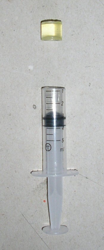

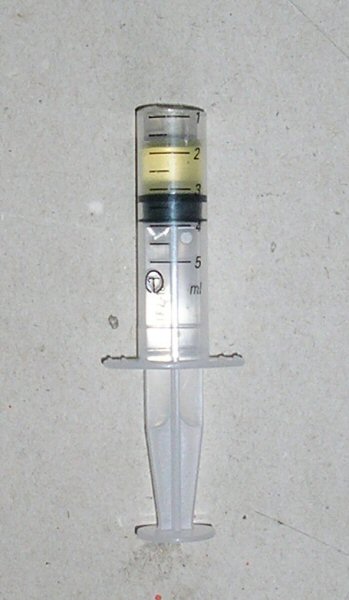

Some insight into how I make my pistons - in this case, I simply cut off the nozzle face of a 5mL syringe and poured the epoxy in.
The cured piston pops out easily, especially with some light lubing of the syringe tube.

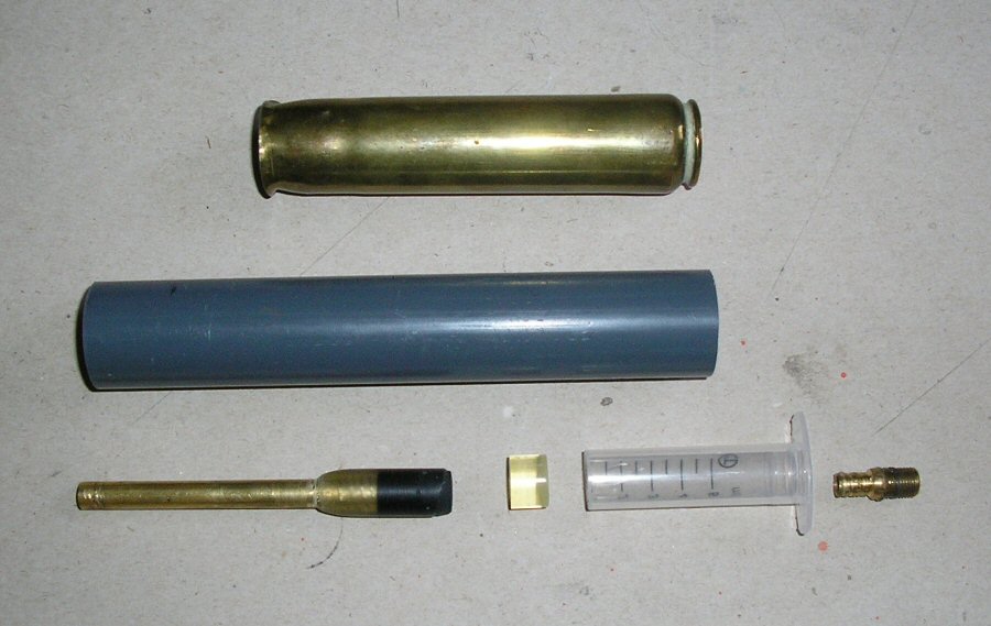

Basic components - the "barrel" (actually an air duct) with rubber tubing added epoxied in place (with the epoxy smoothed down to streamlined shape in my "lathe" - a drill clamped in a vice :D ), the epoxy piston (now sanded down to give a smooth face), syringe tubing (which still has to be cut down) and cut down schrader valve.  Next to the PVC body is a genuine WW2 20mm cartridge for scale, the actual caliber of the launcher will be 19mm

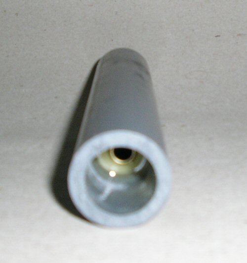

internal diagram
internal diagram
cartridge front, where the projectile will sit

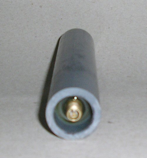

cartridge base - note how in this design the cartridge is recessed (I can still fill it with my shock pump because the pipe screws on to the schrader) to protect the schrader from damage when the cartridge is ejected

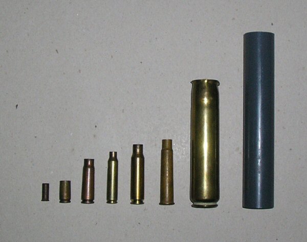

As a matter of interest, here's how it compares to some firearm cartridges, from left to right: 22LR, 9mm pistol, 7.62mm Russian, 5.56mm NATO, 7.62mm NATO, 0.303 British and 20mm cannon
