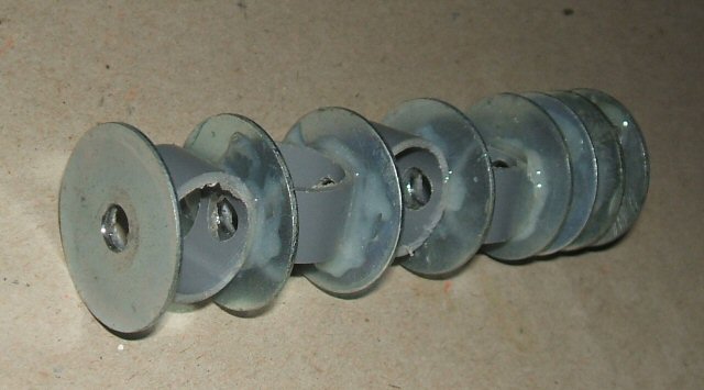

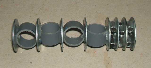

I just wanted to share this design I'm making for a friend's 0.22" Shinsung Career 707 air rifle. This airgun puts out a powerful blast of air that has been known to tear apart lesser commercially available silencers. For this reason, the construction I'm using is fairly massive and heavy - weight being a less important consideration that overal strength.
The baffle array is first assembled using various spacers, with the washers on a steel rod to ensure correct alignment, and secured with quick setting epoxy. The assembly is then wrapped in duct tape and then secured in the main tube with epoxy, fixing the washers in place and adding extra srength to the PVC tube. The muzzle end is then sealed off, providing a large final expansion chamber with an 8mm hole at the exit.
Pictures show two views of the baffle array and a diagram of the completed suppressor.

wow, that sure is purty. Looks like it must have been a biotch to line up properly.how did you make sure the holes lined up?

very easily, when I glued everything together all the parts were threaded through with a dead straight 6mm steel rod (laser printer cartridges are a good source ;) ) so there was no chance of misalignment.

Have a look around your hardware store - what you want is washers with a hole a few mm wider than your projectile, and with an outer diameter as close to your silencer tube inner diameter as possible. In my case there was only 3mm difference and I filled the gap with epoxy. Of course if you can find washers that fit exactly it's better, or you can even cut your own baffles from balsa wood sheet or similar.
Note however that this will only work for projectiles that fly straight, ie tight fitting spheres like airsoft or steel BBs, or elongated projectiles fired from a rifled barrel. For other types of projectiles that are unstable in flight you need a perforated tube.

blowgun darts are made to fly straight from a smoothbore barrel so you should be fine - I'd leave at least 3mm difference between the baffle hole diamter and projectile diameter though. The drilled out sections of PVC tube as separators have a dual function, not only do they add strength but they also conspire with the baffles to create more turbulence, which makes the suppressor more effective.
