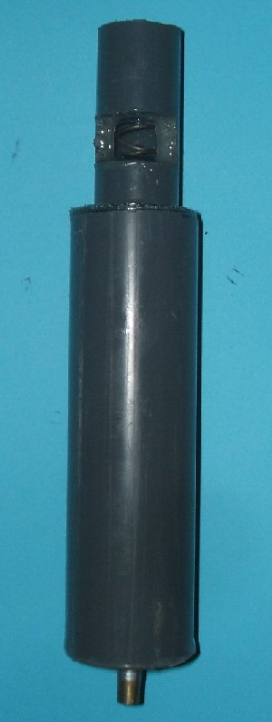

Here's the prototype, pretty isn't it

I still think that it won't give you pulsed source of air, becasue it would cycle way too fast....

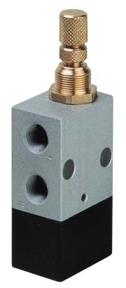

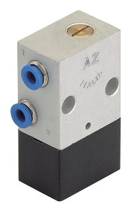

how much pulses per second do you need jsr ? I've found some off the shelf parts that are used to provide pulsed air.... it generates 5 Hz pulses of air (so a pulse every 0.2 second) (sorry but expressing this is very difficult if your not a native speaker of english
It is interesting becasue you can also regulate how many times per second pulses are generated
some pics and a diagram that I think might be very useful for you

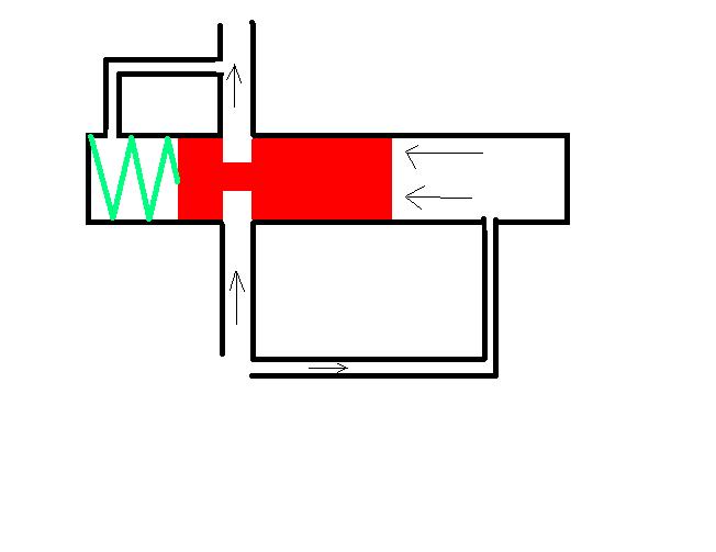

someone suggested something like this today and I knew that these valves work more less simmilar....JSR I think that all you have to do to make it work is to understand that diagram in my post above....

Ah, bugger it all to hell - cycle too fast, you said? It didn't cycle at all, just popped open and leaked, like the devil's arse'ole at a particularly awkward dinner party.
This one's going straight to the bin, I'm through with reciprocating systems for the time being. It's back to the well-worn drawing board for now.

JSR Maybe it is a good time to buy this valve or at least build yourself something similar.... some of this valves even have a small inbuilt bleed valve to regulate the numeber of pulses / second so you oculd easily reulate the ROF

BTW. tansit234 I just drew my diagram to show how do I understand the way those valves work... and yes you are right that extra pipe in my drawing is not neccesery
MrCrowley i think that he can easily find them in any european country...

POLAND_SPUD, I'm strill strugging to understand how this could work - so the air pressure pushes the piston to the left, blocking off the flow, but how does it reset if the air pressure holding it against the spring doesn't drop?
