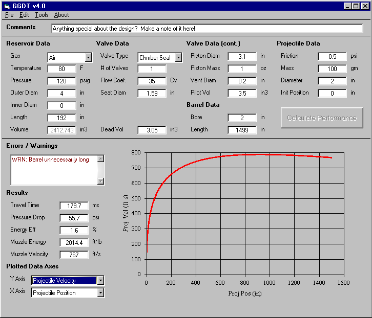

You might want to download a copy of GGDT (Gas Gun Design Tool).
Here is what I get with the default valve. The graph is barrel length on the horizontal axis and velocity on the vertical axis.
For the default valve, the optimal barrel is about 80 feet long. Shortening the barrel to just ~20' only drops the velocity by ~10%.
