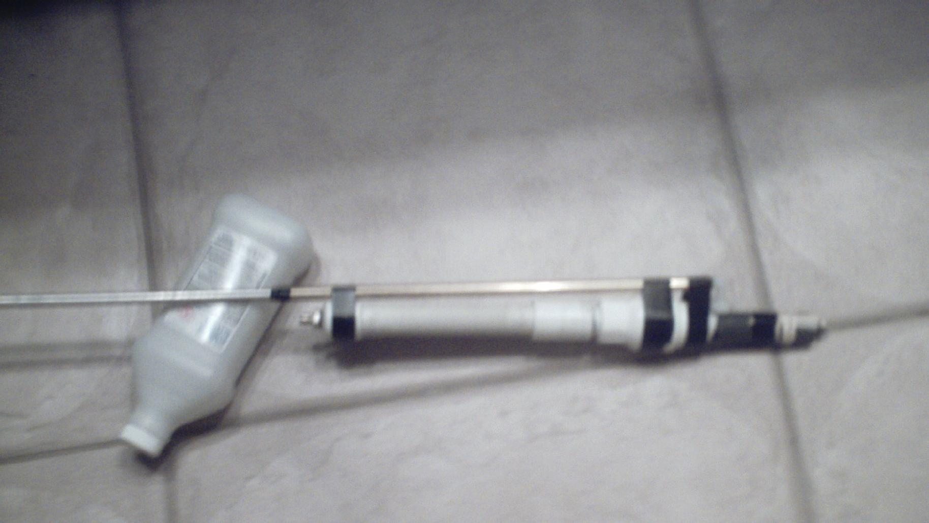

Early this moring I was browsing the forums when I saw Ant's "old" airsoft gun, the hammer valve on his gun inspired me to build my own hammer valve gun, but one that could be easily mass produced without modifying any parts. So I started thinking.... and then I thought of a check valve, it was the exact same thing as a hammer valve with out the bolt and striker attached, so I set out to ACE with $15 and bought the parts, It works perfectly, the only thing is right now it doesnt have a trigger, I just pump it up pull back the hammer like a pinball thingy and let go. Wela! a cheap easy and simple hammer valve for the general spudding community. (I'll put up pictures later today or tommorow but I have the diagram)
Edit: pics!
hammer valve.jpg (11.33 KiB) Viewed 5039 times
Its blury but you can see the check valve the brass and aluminum barrel, near the back it the bolt, right now instead of a spring I have 4 rubber bands tightened (for now)

Thats a pretty good idea. All you have to do is hook it up to a motor and tripod and you get an auto turret. :D

thats a good idea you have there, you could use a sear system for the trigger.

damn. I'm also in the process of making a hardware store hammer valve. you beat me to the punch i guess. Oh well, mines inline. looks sweet btw

how much power does this have?
Sun Jan 06, 2008 11:59 pm
Interesting, what sort of velocity are you getting from it?

Hey good job there. I made something similair a while ago when I didnt understand the physics behind it and i build it with a large area poppet (check valve) and it was nearly impossible to open at 60psi. Just wondering what size is the face of your check valve?

Excellent, and beautifully simple - love it. Do you guys still have those cap guns over there? They look like revolvers (but don't revolve) and they feed paper strips of caps? If you butchered one of those by removing the barrel and cylinder it'd give you a nice trigger, hammer and pistol grip you could use for firing your hammer valve.
