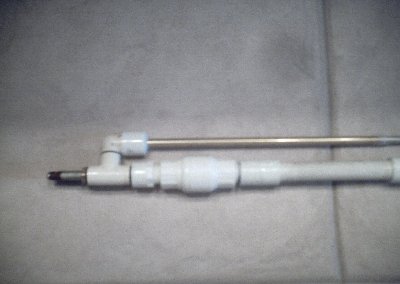

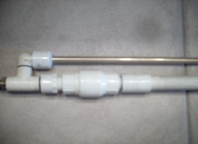

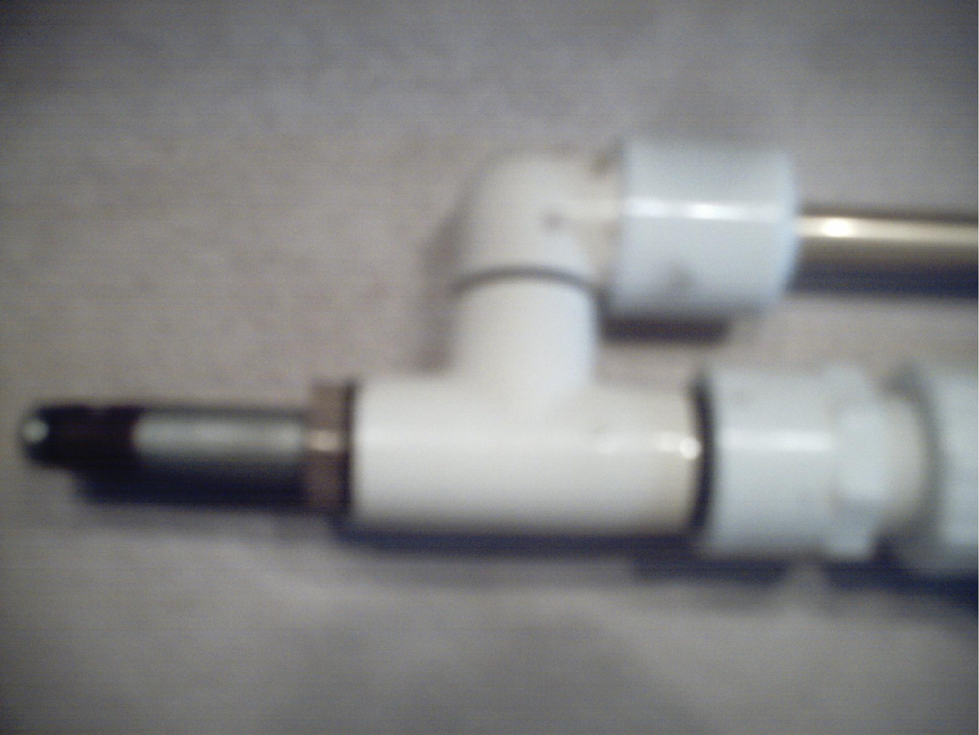

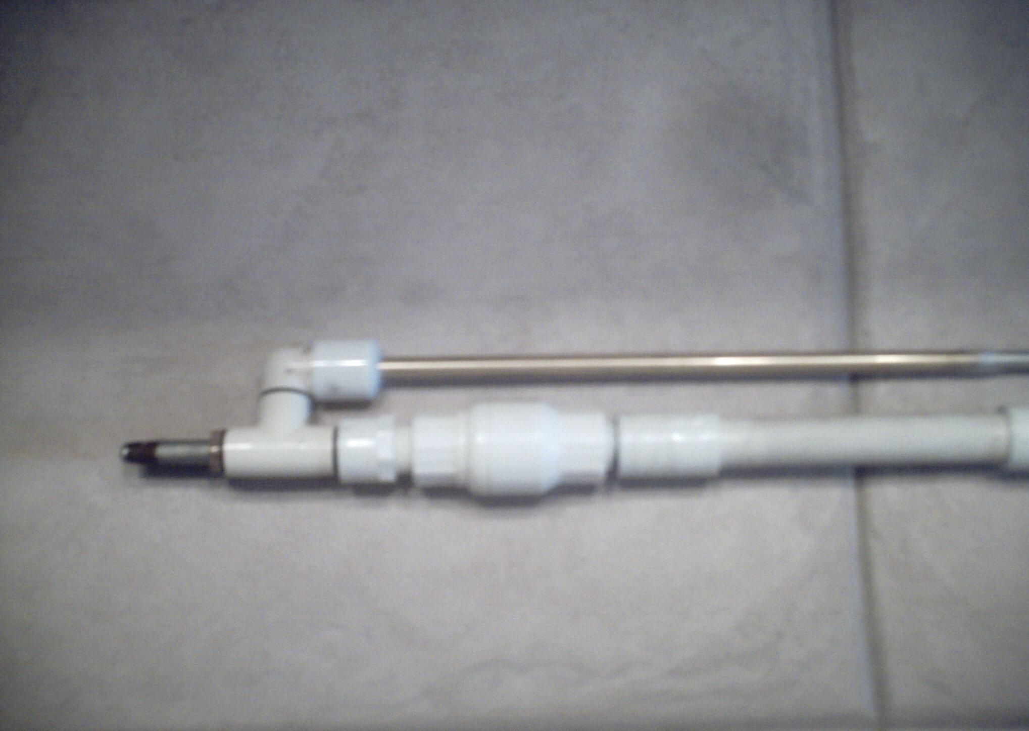

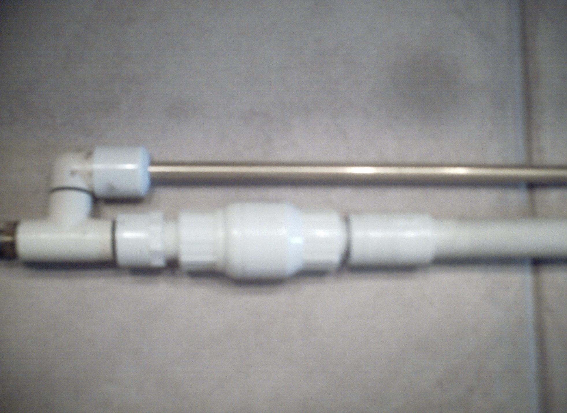

The face/ size of the valve is 1/2 in. I run the gun at about 80 psi, JSR, the preformance is about as good as my aeg which shoots 340 fps, my aeg can shoot through a can both sides from 30 feet, so can the hammer valve gun. I just made some modiifactions to it, instead of a 1/8 in. elbow, it has a 1/2 in. cpvc tee with an elbow on top, and the back side of the tee has a 3/8 in. to 1/4 in. brass fittin, and the a 1/8 in. nipple for pressing the valve, right now I'm just pressing the valve, but maybe later (I'm "sick" :D from school today) I will put some rubber bands on. for now heres an updated picture.

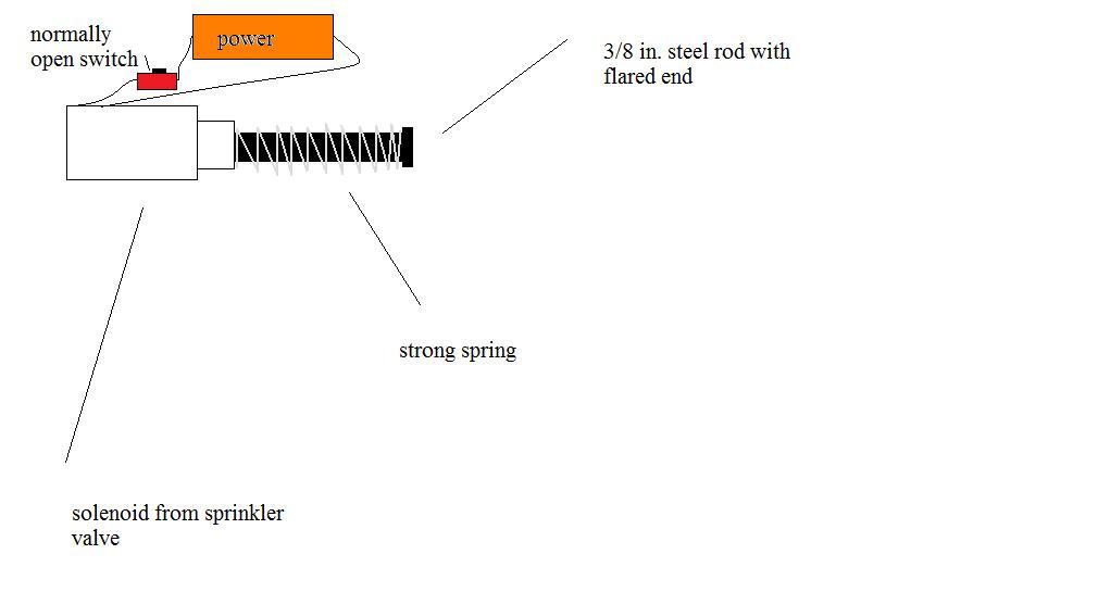

As for the semi auto thing, I need a bigger tank, and the valve would have to solenoid operated, which I'm working on, it's pretty much a sprinkler valve solenoid with a 3/8 in. steel rod in place of the steel thingy/ sealing face. there is a pic below. Instead of using a revolver cap gun, etc. I'm going to just use this solenoid method. Will it work? If so the solenoid threads fit perfectly into the 1/2in. cpvc tee, and the steel rod fit through the pipe, so it would be easy to make this thing fire semi auto, I just need a clip idea.
a close up of the new and improved setup with the 1/8 in. nipple striker (no not a nipple striker) lol

You'll need a pretty strong solenoid, as to the magazine system the blow-forward breech would be a good idea.

The solenoid in this case can be used in lieu of the spring driven hammer, but it's going to have to be pretty heft to knock open the check valve, I don't think one from a sprinkler valve will cut it.
