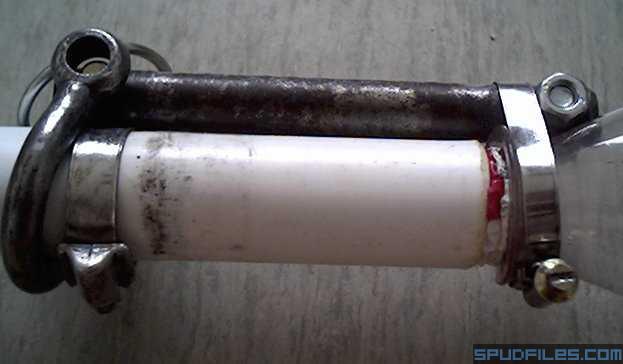

The parts connect together like this.
and are secured with a shaft pin.
a better view of the connected breech.
