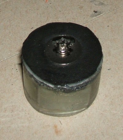

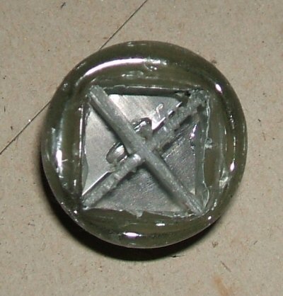

Thu Jan 24, 2008 11:14 pm
Here's the enormous piston :) by adding an internal structure (basically a cruxiform syringe plunger wrapped in duct tape) to the casting it's not only light but also saves on epoxy, while still being strong enough for the job. This is how it looks like fresh popped from the mould, still needs some finishing.

Fri Jan 25, 2008 12:18 am
Very cool. Nice to get live updates on the progress. How big is the tube that piston seals against?
:lol: @ your profile pic.
Fri Jan 25, 2008 3:31 am
Skywalker wrote:How big is the tube that piston seals against?
Ideally it would be the same 17mm piping I'm going to use as a barrel, but that would mean the spring has to hold back around 37 lbs of force at 110 psi, so I think it will be closer to 13mm, that will cut the force required to around 22 lbs.
