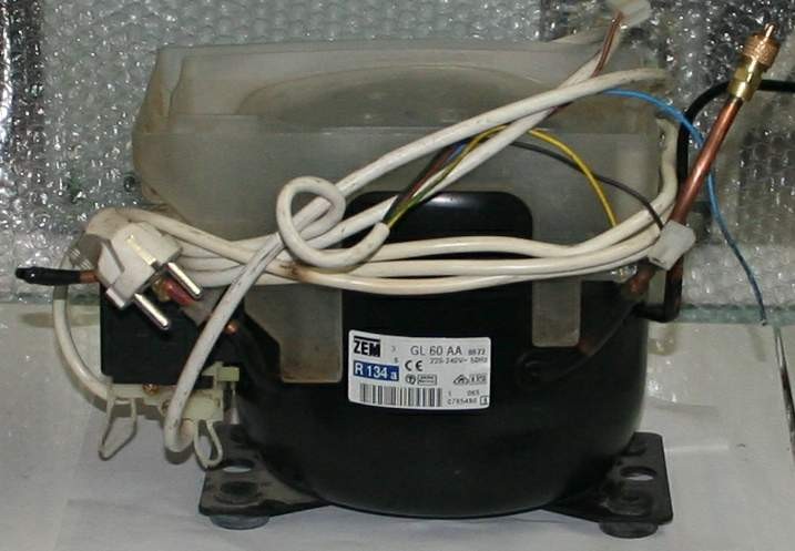

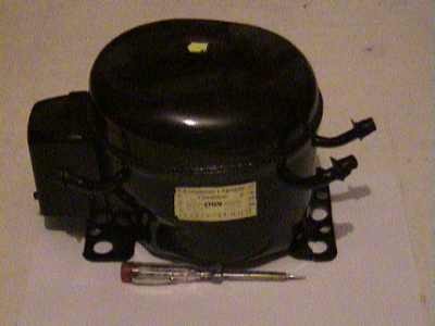

There are different types of these compressors becasue they are used for many appliances.. As a result their dimmensions, weight and flow might vary... you can expect that most fridge/refrigerator compressor have specs more less the same as mine.
there are more powerful compressors as well, for example those used for air conditioning or in shops/stores
I've just read that their air inlet can be used as a suction pump, so it is quite versatile (esspecially usefull for these people --> http://www.spudfiles.com/forums/wrong-s ... 12563.html :D )

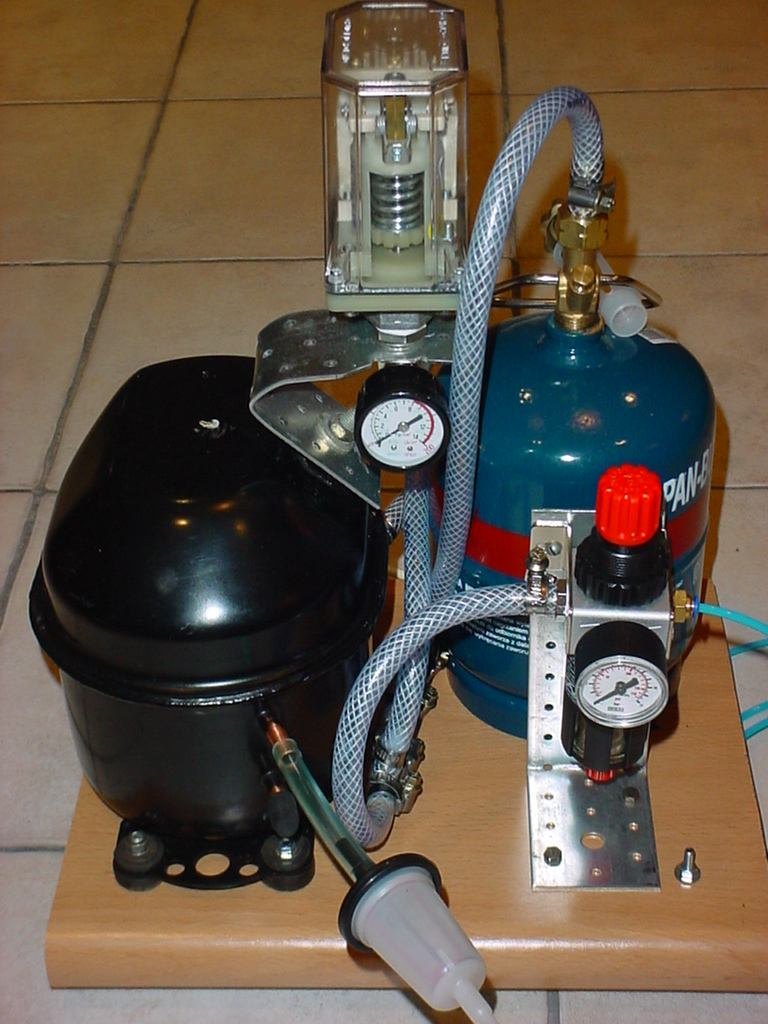

some pics showing more of these pumps + one full equiped compressor with a tank, regulator, pressure switch etc. (not mine)...
Hotwired
Posts: 2599
Location: UK
Sat Feb 23, 2008 1:38 pm
Second picture down even has a filter/regulator on it.
Nice neat package mounted on a board there.
