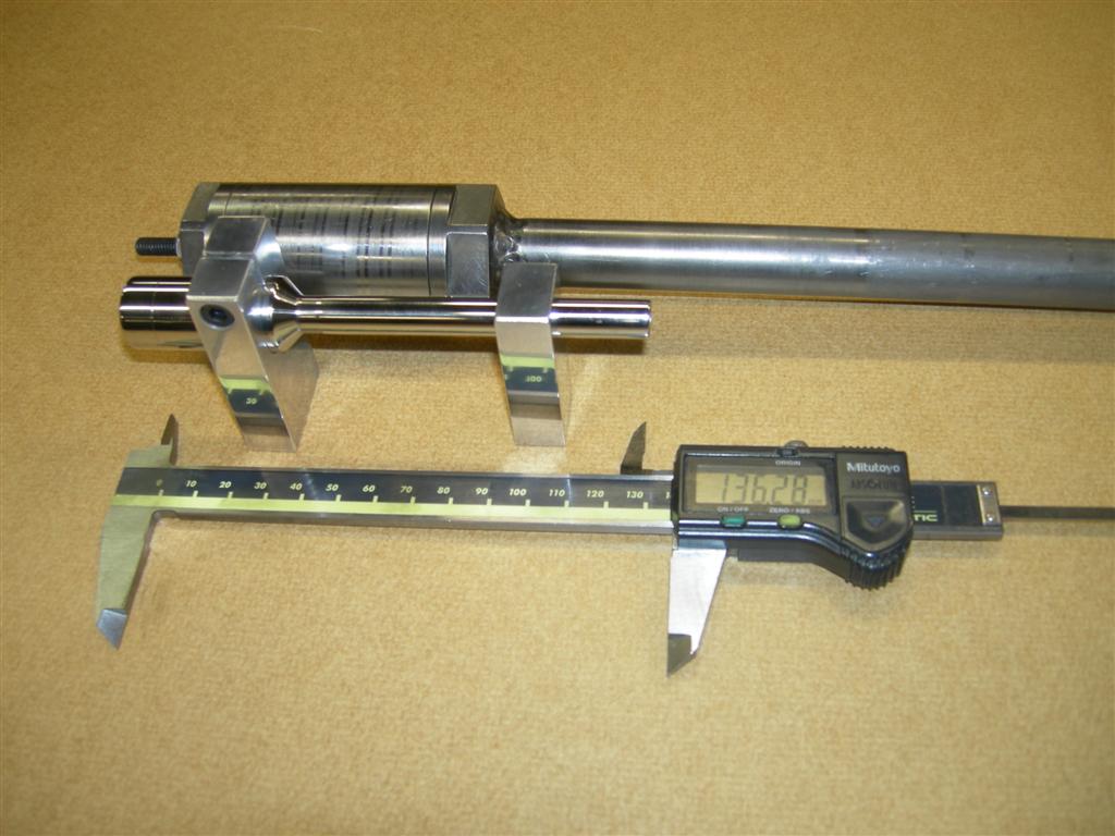

The ETG compared to a calliper and a small ETG i also made of stainless steel.

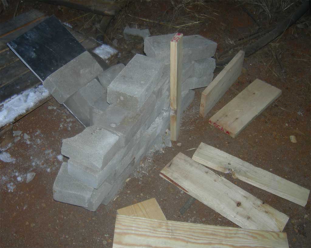

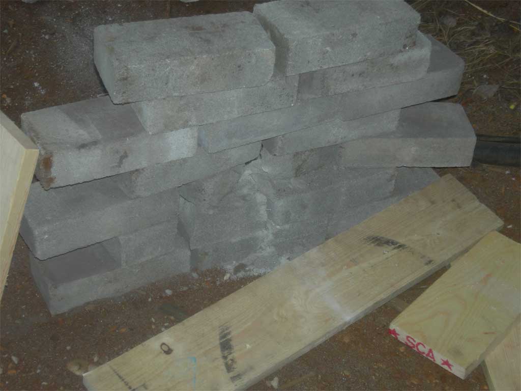

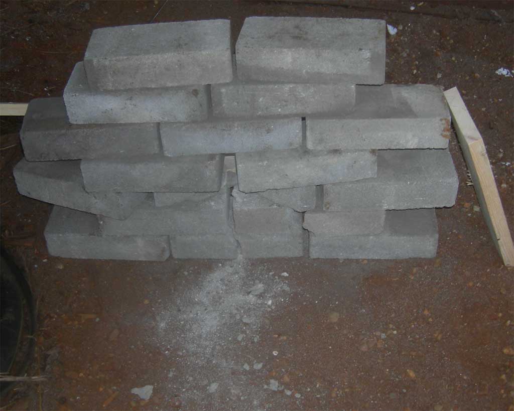

The projectile first went right threw a total of 60mm of wood, the continued threw the bricks and ricochet on a dumpster.

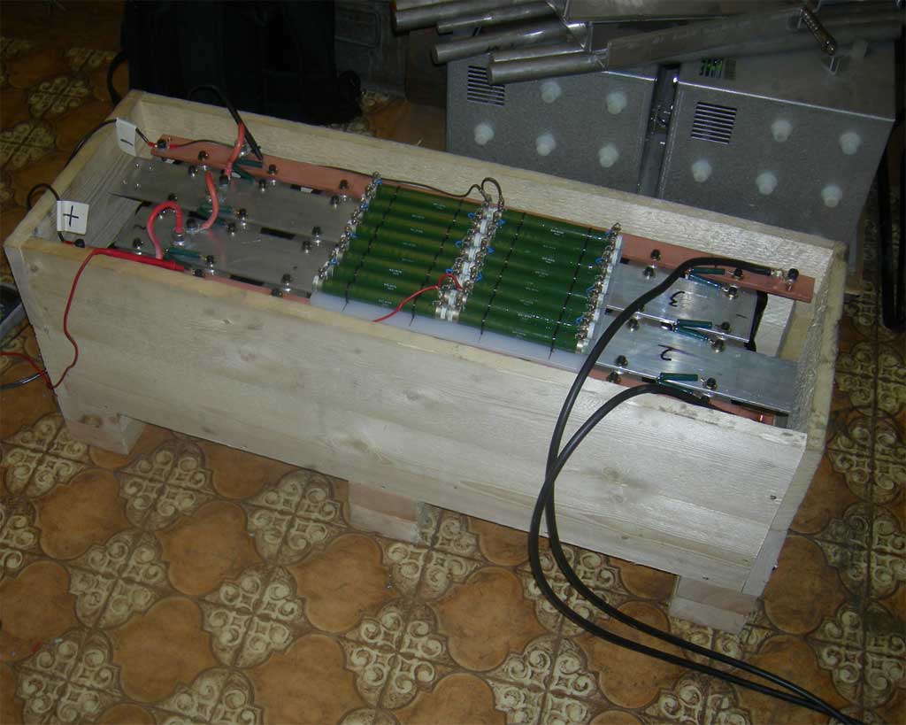

The 28,8Kj CapacitorBank.

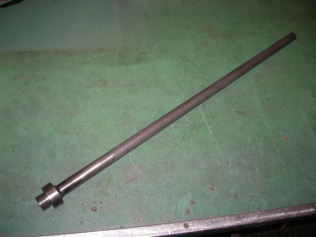

12mm ID smooth-bore barrel.

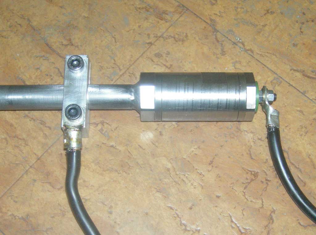

The chamber of the ETG.<br />You can also see the two 35mm2 cables connected to the chamber.

I only see 1 bank in that lower picture... where are the other caps?
Also what gauge wire is that leading to the gun?

Davidvaini wrote:I only see 1 bank in that lower picture... where are the other caps?
Ohh, i meant 3 rows that are wired in series, only one bank so fare.
But i have enough capt to built at least to more identical banks. :D
I use 35mm2 cables, that's about AWG 2, but aim planning to upgrade to at least two in parallel.

Here is a few more damage pics, really not that detailed but i can take some more this weekend when i do some more shots.
Damage.
Damage.
Damage.
Damage.

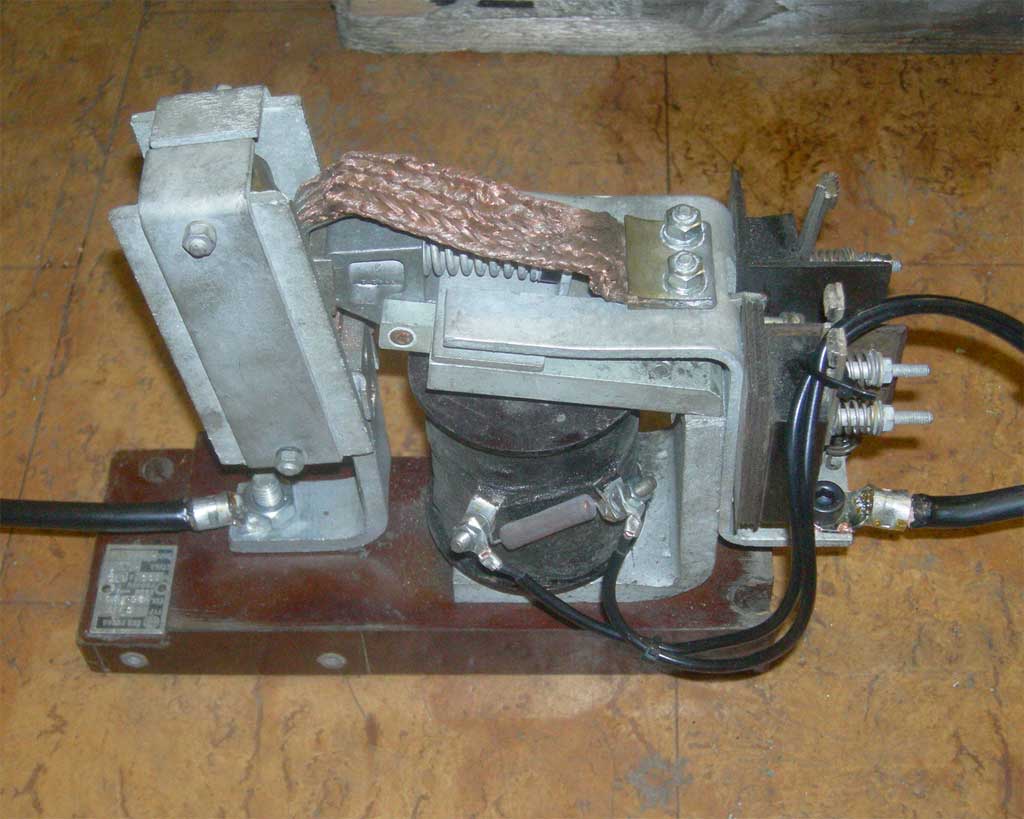

The switch i using.
The switch i using.
