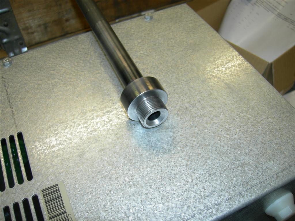

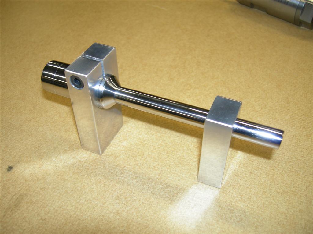

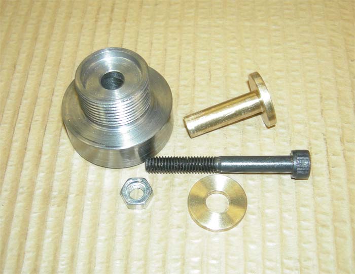

Some Pict's of the chamber.
The chamber is made of Cr-Mo- steel.
The brass parts is later made of Teflon.
And a short video of me milling hex on the en-caps.

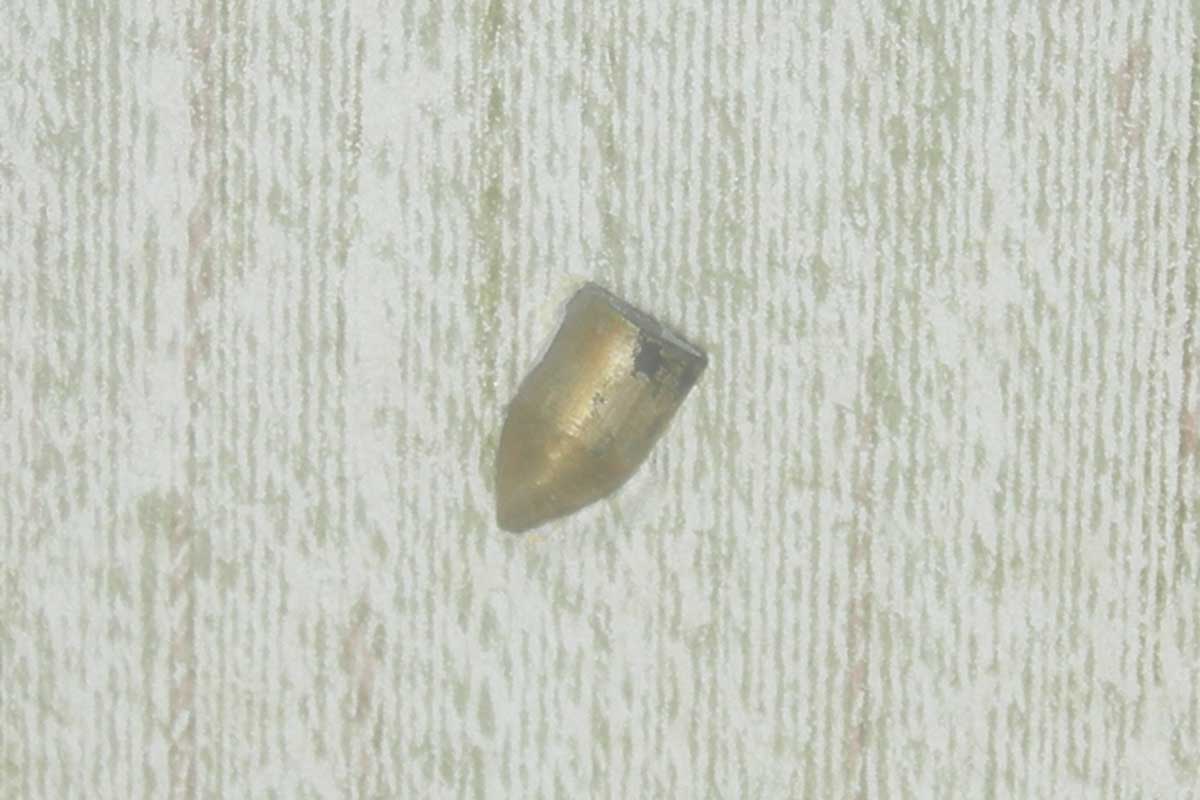

Actually i have already built a smaller caliber ETG.
Its the first prototype i built and its made out of stainless-steel, the barrel is 7mm and the gun is about 135mm long.
I only tried it with a smaller capacitor bank the results was so promising so i built the current one.
Two videos of the prototype.
I had some newspapers in the box to stop the projectile but instead of stopping it embedded itself into the wall. :evil:
http://www.vimeo.com/786297
http://www.vimeo.com/786306
And YES that is in my living-room.... :P
