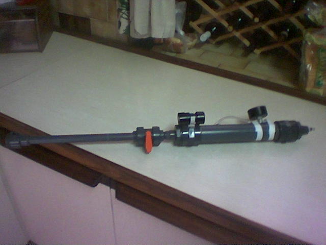

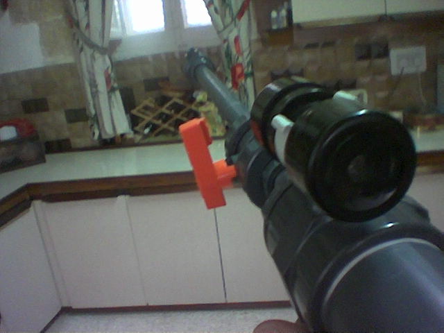

My latest creation, a very basic pneumatic rifle with a couple of add-ons.
It is an inline pneumatic with a 1 1/2" reservoir, 1/2" barrel, ball valve and a schrader tyre valve.
It then has telescopic sight (1.5x), a pressure gauge and a PVC flash hider.
I have fired it at 80 PSI, but it can easily go higher without leaking.
I mainly fire naked AA batteries (plastic coating removed) without wadding, but you can fire anything that fits down the barrel snugly. The batteries give it a noticable recoil.
I havent performed a range test yet but I believe it will fire quite far.
This gun was recycled from my Marble combustion cannon, I unscrewed the end cap and barrel and used PTFE tape to fit a Ball valve and schrader valve.
I left the igniton screws in the chamber wall since they already sealed it quite nicely (however later I unscrewed one, widened the hole and fit the pressure gauge tube). I created the barrel from a piece of 1/2" pipe.

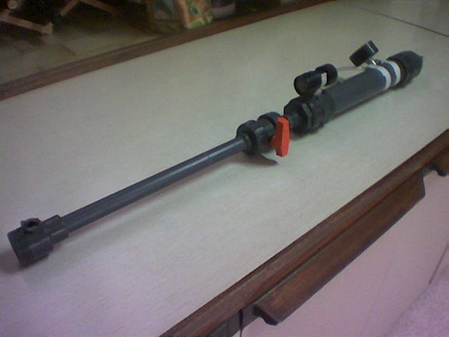

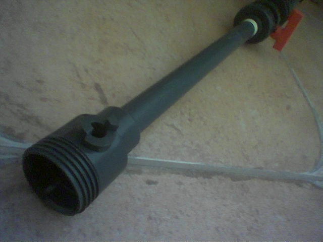

The flash hider was made from an old ball valve that I disassembled.

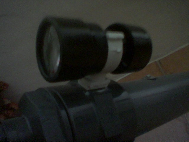

To make the sight and holder, I first found an old plastic wall clip (used to clip broomsticks to the wall and stuff), I filed down the edges and superglued it onto the gun. The sight is an old toy telescope that has approximately 1.5x magnification. It ended up perfectly straight in line with the barrel.

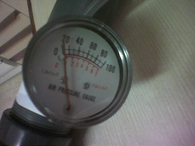

The pressure gauge is from an old foot pump, I liked the markings too much to throw it away!. I took off the red hose that was connected to it and replaced it with plastic aquarium tubing.
The operation of the ball valve is very smooth so I dont see any need to change it for now.
Its quite fun to fire it mostly due to the recoil and the mist that comes out of the barrel after each shot, smoking gun anyone?
Its called the barett E-444, because of the flash hider and 444 since its part of my nick.
Overall, its my favourite pneumatic so far and I just love the way it looks
and cost wise I'd say it cost me around 14 pints!

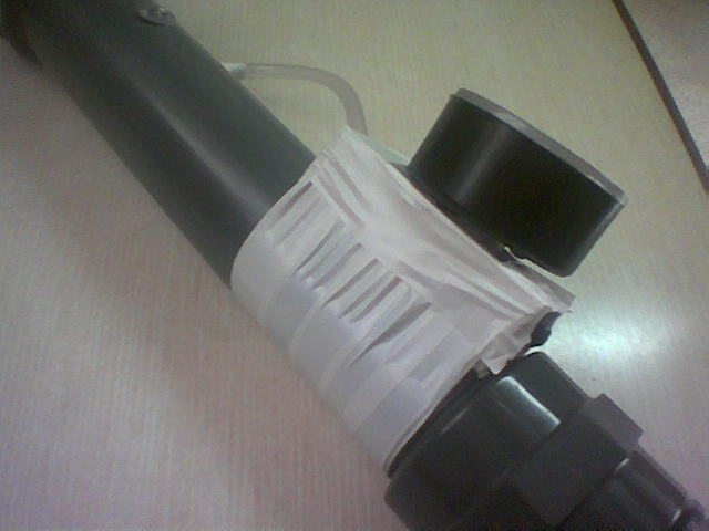

I have added a new mount for the pressure gauge, made from rectangular electrical wall trunking.

The Barett E-444.
The Barett E-444.

Snipers View!
Snipers View!
The Barrel with the flash hider
Telescopic sight in clip.
The markings on the pressure gauge that I like.
Another shot of the new mount.
Updated pressure gauge mount.

Thanks, the gun has been updated now, the pressure gauge is no longer taped so akwardly onto the gun, it now sits on a homemade stand and looks neater. New pic is up top.
