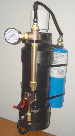

This is my first multi-barreled cannon and also my first propane setup. All ABS to PVC parts were glued with ABS to PVC transition cement and nuts and bolts reinforce all fittings that weld the two together.
Combustion chamber 12" x 4" (main chamber).
Breech = 2"
Softball barrel = 32" x 4"from base of ball to tip.
(A bolt sits 4" above the main tube of the barrel to seat the softball high)
Tennis ball barrel = 36" x 2.5" PVC (thats where it seats)
Potato barrel = 48" x 1.5" ABS (new length)
Golf ball barrel coming soon (I plan on 72" x 2")
Propane and meter system with valve from a propane torch and a blowgun for the other. This screws into a tire valve at the base of the combustion chamber. Hose is from a broken bike pump.
BBQ igniter glued into a hole. Nothing special. Very reliable so far.

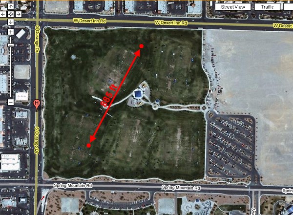

Softball distance measured with a GPS = 885 ft. Who says short barrels can't shoot far? Haha

Measured with my GPS all the softballs fell within 30 ft of my best distance of 885 ft.

ahh Jeff i see u got that meter built, looks good. have u found a good pressure for it yet. also i shoot baseballs out of my howitzer but your gun has inspired me to add a softball barrel too. g/j.

Excellent work on the meter. I don't think I've seen anyone use a blowgun on one, usually just ball valves.
Good to see someone thinking outside the box :D

I find that 36psi gives me the furthest launches with the softball attachment.

Very nice. The use of the blowgun for the meter is a great idea. Just wondering if you have any issues with your C:B on the softball barrel, It's a 1:3 from your given measurements, does it seem to kill performance... of course 300yds with a softball from a combustion isn't bad... nice work though, very clean.
