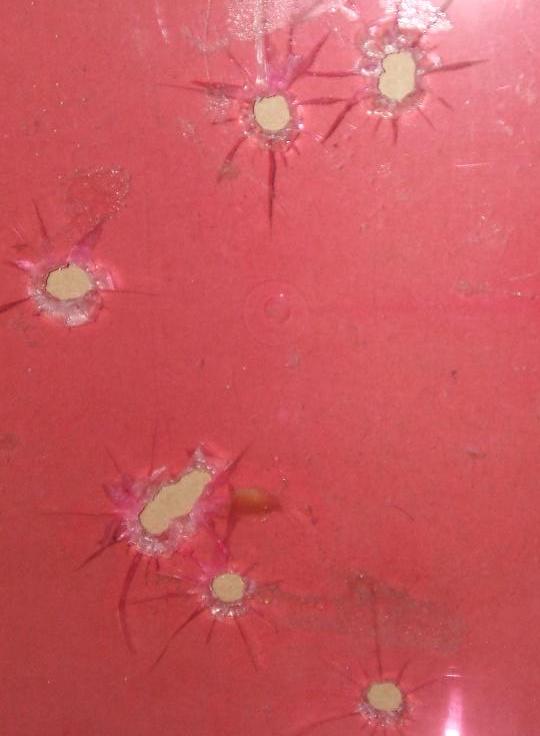

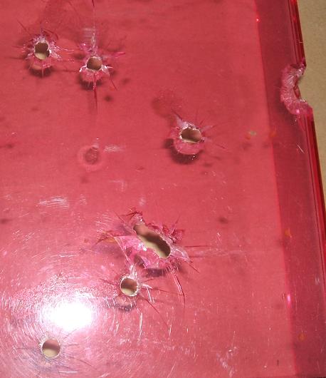

Doesn't really come accross in the videos but it's really loud! I tried it with the pellet magazine and total fail, it fired a couple of shots before jamming completely because the heads of pellets in the mag were jamming into the tails of the preceeding pellet and expanding :roll: so here's a damage vid with 6mm 0.25g BBs instead:
Just a quick ten round burst, double feeds galore, but look what it did to that 1/8" thick acrylic (with the BBs being totally pulverised against the hard surface behind it):
