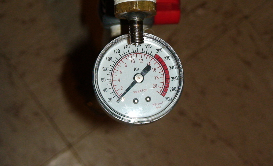

This is my latest project please leave comments likes/dislikes. The gun is all metal with some brass fittings. I choose PVC for the barrel because the inner is smooth. the whole length of the gun is 2feet 9inch and not that heavy, it's easy to carry around. This is by far the most powerful gun i've made :twisted: .

Looks quite nice, what pressure do you run it at? Get some damage pictures/videos up too, I wanna see this thing in action :)
How's the ball valve trigger? Looks like you hip-fire this cannon with the trigger being at about your hip or maybe slightly further back?
Any other specs you can think of, add them to your post. :P

I like it, but dislike the enormous pilot chamber volume.

You don't need the extra T in the pilot area if you fill through the handle.Just make sure you remove the schrader valve-stem.
If you made your piston right, it will surely actuate ( via bv)through an empty schrader.
Copper and aluminium are very suited to be used as a barrel.
The pvc ballvalve breechloader is very nice, but I'd go high pressure with this one ( effectively a sawed-off) so out with the PVC, in with metal!

Nice gun, I like the layout. Definatly remove that tee in the pilot area, and as BTB said, stick on a copper barrel and crank up the pressure :twisted:

Take off that extra T like everyone is saying though.
A pump action system would probably make this a lot more fun to shoot and they're not difficult to build.
