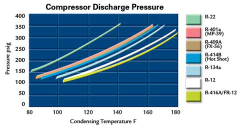

Look at the graph below. Notice the curve for R22. It has high pressure for low temperatures. It is a good match for freezers. R134A has relatively low pressure at higher temperature. It's a good match for A/C.
For fast fills, go with the big boys. It's OK. Note R12 is obsolete to protect the ozone. Refrigerants near the same curve are good substitutes.
