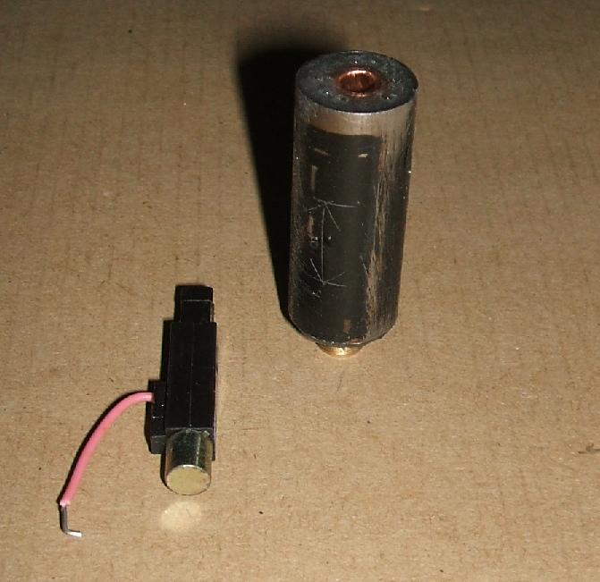

edit: version 2 made and curing, I checked for spark beforehand and it seems consistent :) actual internal volume is only 1.8mL so I'm going to have to be very careful with metering, even at 10x it will be just 0.7mL but with a 1mL syringe it shouldn't be an issue.
update 25/10/2009:
Can't get it to ignite :( I've taken it to 5x, reasonably confident of my metering and I definitely have spark. Bollocks.
Cartridge v2 curing with a piezo ignitor for scale, the scratched arrow markings indicate the effective internal volume.

How did the v.2 prototype perform?
Fri Oct 30, 2009 5:42 am
In short, it didn't. I definitely have spark and the BB-seal arrangement is holding pressure, I've tried to up to 5x but no ignition in apparent. To be honest I've chickened out of trying it at high mixes, my conclusion is that I've gone a little too small with the volume to allow for effective syringe metering.
I might try a bigger version but for now I'm thinking aboutpneumatic cartridges again.
