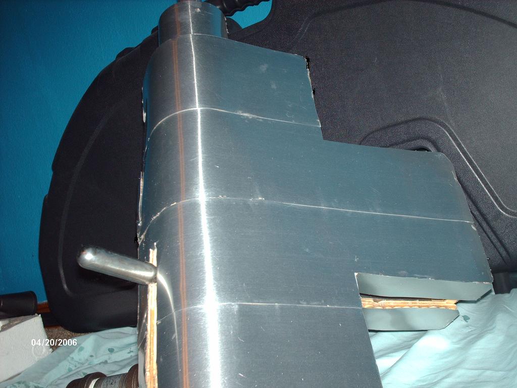

After being inspired by JSR's combustion cartridge awhile back I decided to attempt my own with hybrid mixes. Ignition still needs work and metering still needs tweaking but it is coming along. It has also successfully loaded an empty cartridge :lol: .Feel free to ask questions.

A view from the side.
