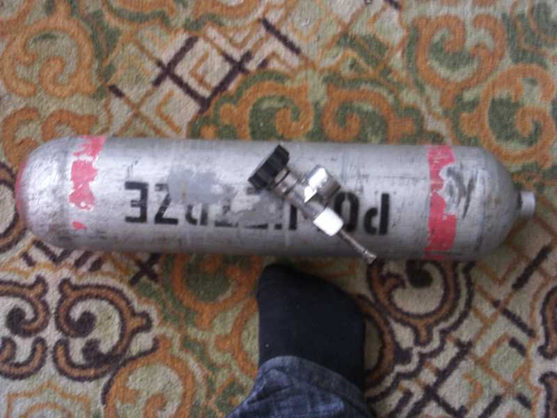

I has got a 4L air tank rated to 200 bar!!! (though it's not the same I mentioned a couple of weeks ago... but it has ASA threads too (female))
ohh jsr I included my foot in the pic... it's with a sock on because that makes it even more sick
any idea how to prepare it for dealing with lots of moisture ??
I think I've asked this question earlier.. I need to first clean the inside with something that dissolves oils, let it dry and then pour in some sort of paint right?? lol but what paint ?
ohh BTW where can I get a bolt captive pistol ??

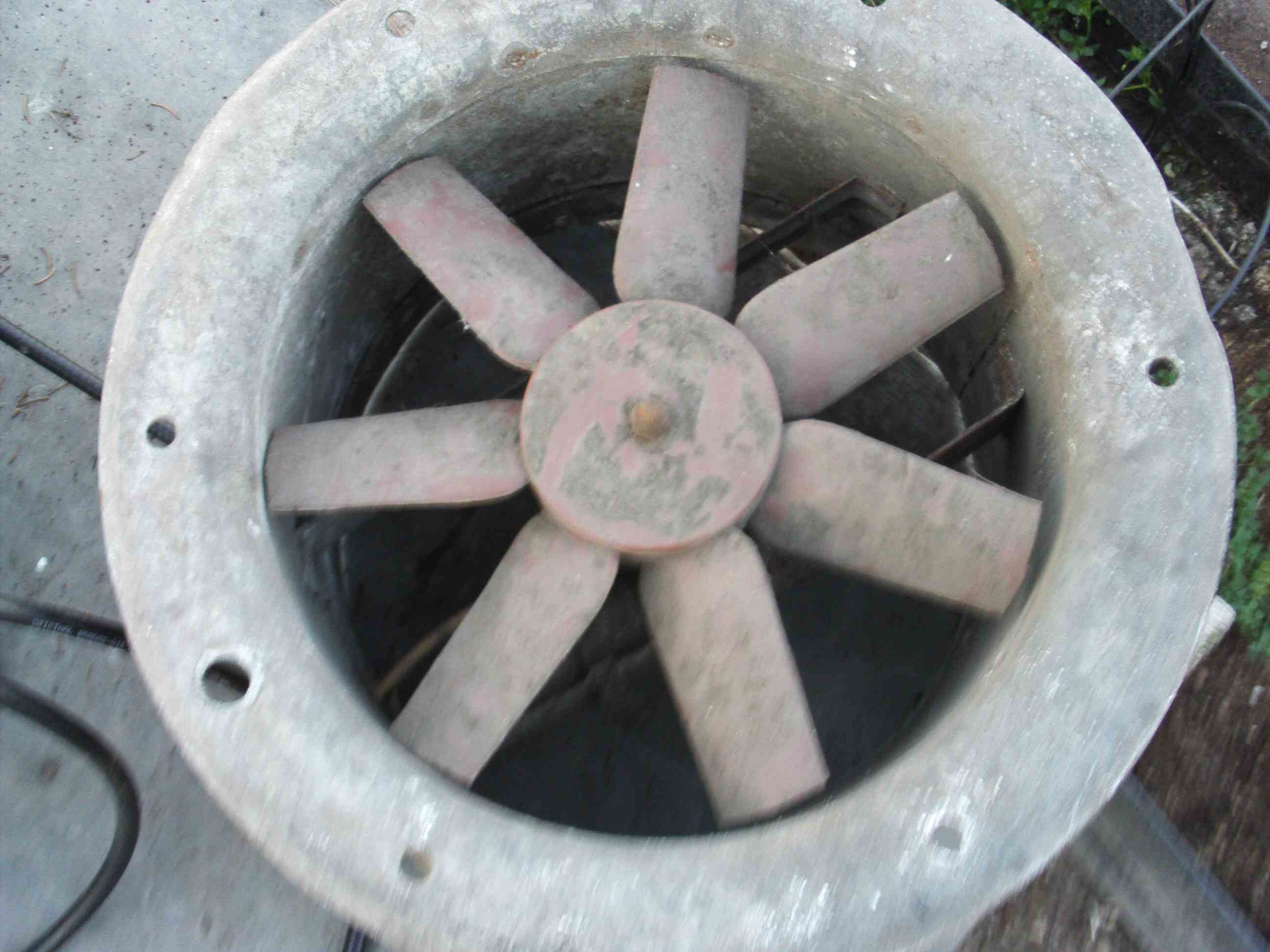

ohh BTW I almost finished my new setup.. well not that much new as upgraded... I haz the biggest fan I could get
pics soon

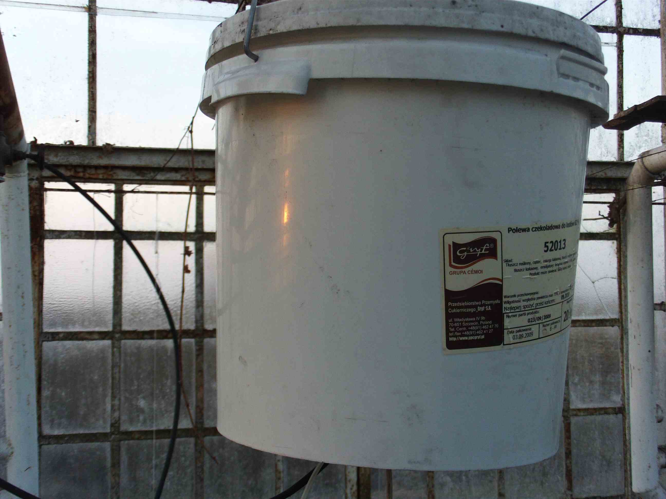

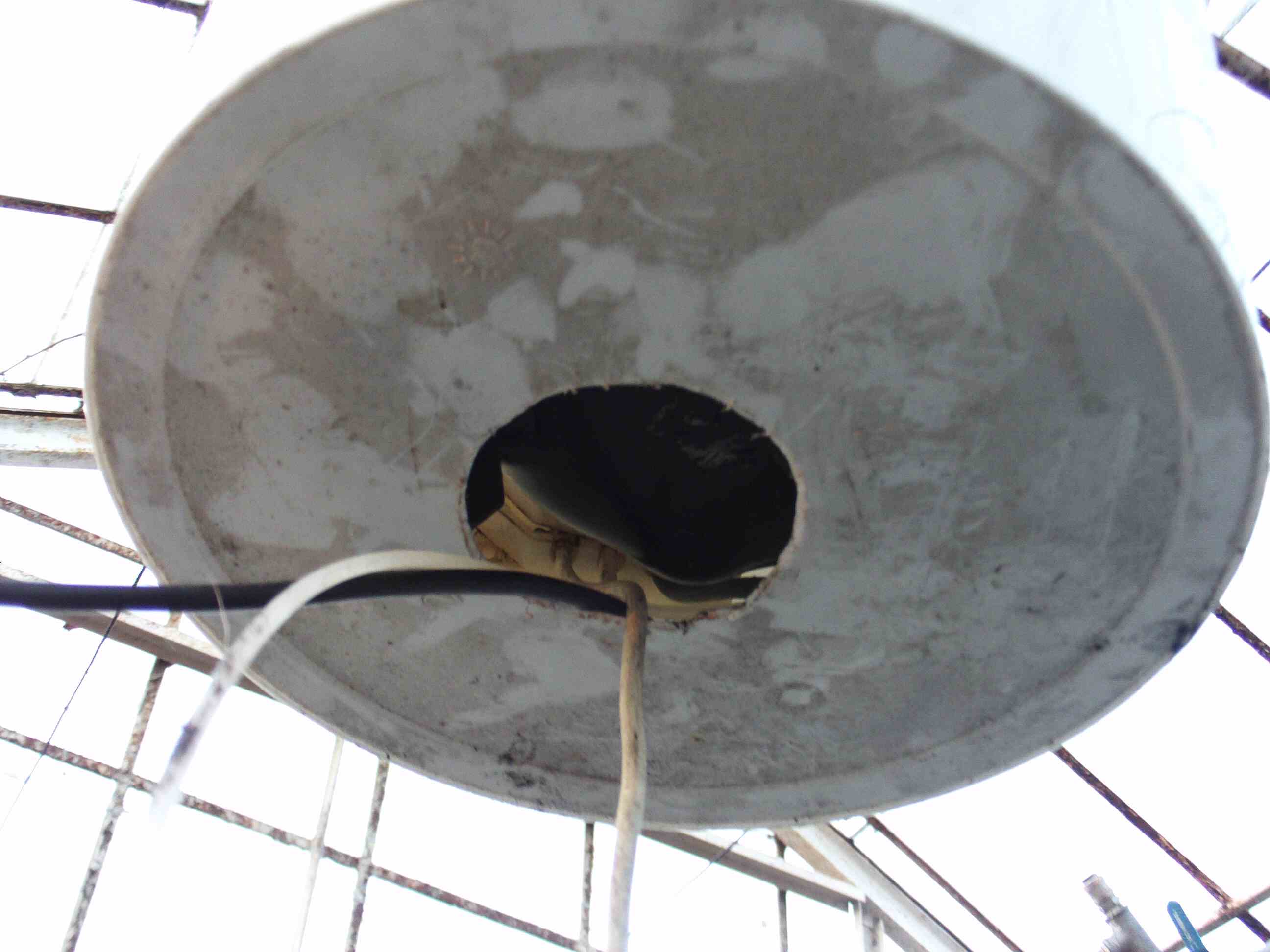

lol sorry I don't have much time ATM
as I said eariler, it's as simple as it gets... a plastic bucket with a hole cut in the bottom for cables and tubing...
the fan fits the bucket perfectly... I just have to remove the lid from the bucket and put it there... but I haven't done it yet (I haven't wired it yet)
@mrcrowley
good thinking I've got a radiator fan too but I decided to use this one as it runs straight off 220V
EDIT
ohh btw sorry that everything is so dirty but I didn't have time to clean it yet
@mrcrowley
EDIT

- POLAND_SPUD
- Posts: 5402
well who said that overkill is a bad thing...?
the compressor can work continuously and it stays cold
