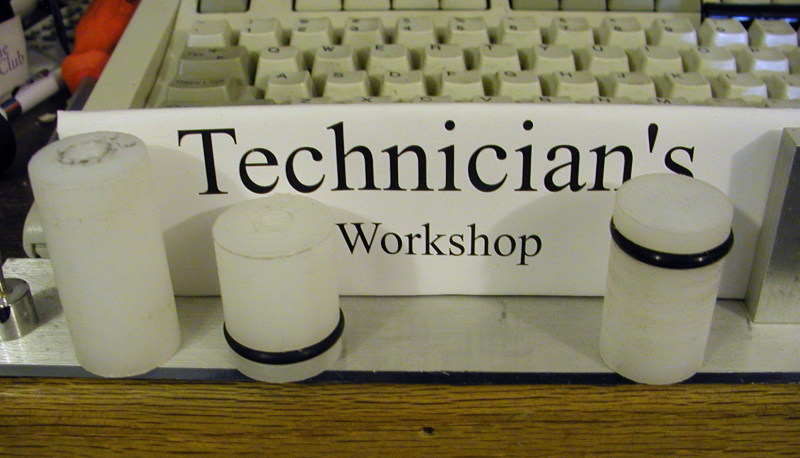

The piston on the right is destined to become someone's piston hybrid. I can't wait for the photos and a video of the finished product.
The construction of the middle piston was photographed for this tutorial.

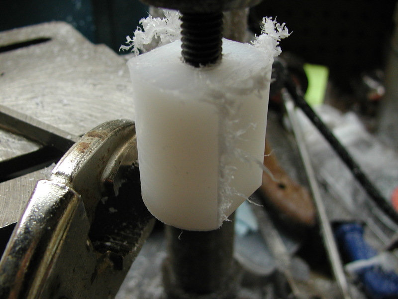

When the piston fits, stop.   If the arbor was centered better, the flat side would be smaller or gone. This is the end of part 1.
After several passes the piston is starting to take shape.  As it becomes smaller, keep track of the diameter.

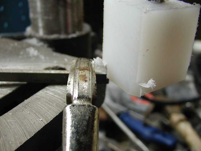

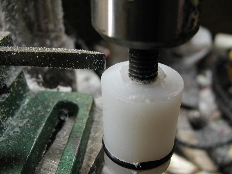

A suitable cutting tool is clamped to the drill press table.  I used a wood chisel.  The rotating block is lowered past the cutting tool taking off a small amount in each pass.

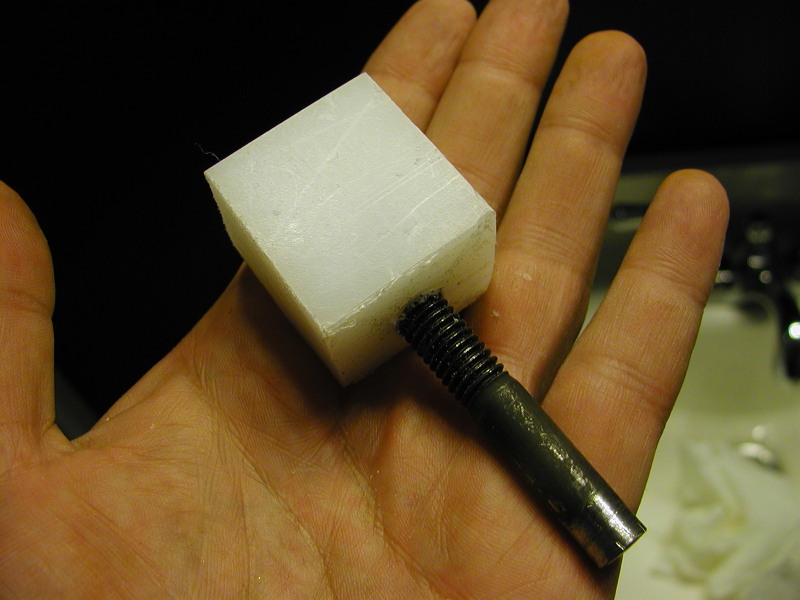

The arbor is nothing more than a bolt with the head cut off.  This is screwed into the hole.

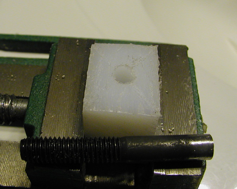

The block is tipped on edge and drilled for an arbor so it can be attached to the drill press.

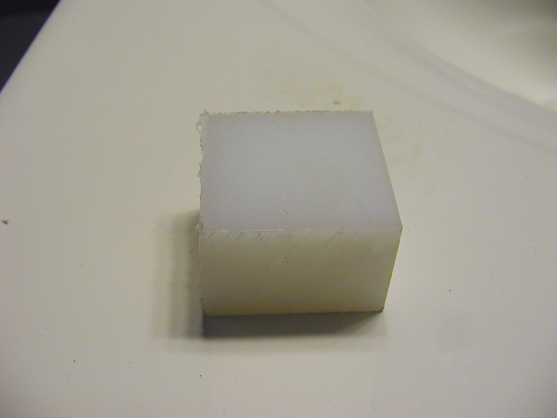

A suitable size piece of plastic is cut using your favorite saw.  For a long piston the material can be turned edgewise.  This tutorial will show that procedure.
These pistons are made using a sheet of 1 inch UMWHDPE.  The piston on the left is 2 inches tall and 1 inch in diameter.  The piston in this tutorial is 1.37 inches tall and 1.06 inches in diameter.  It has a flat side from the original surface.

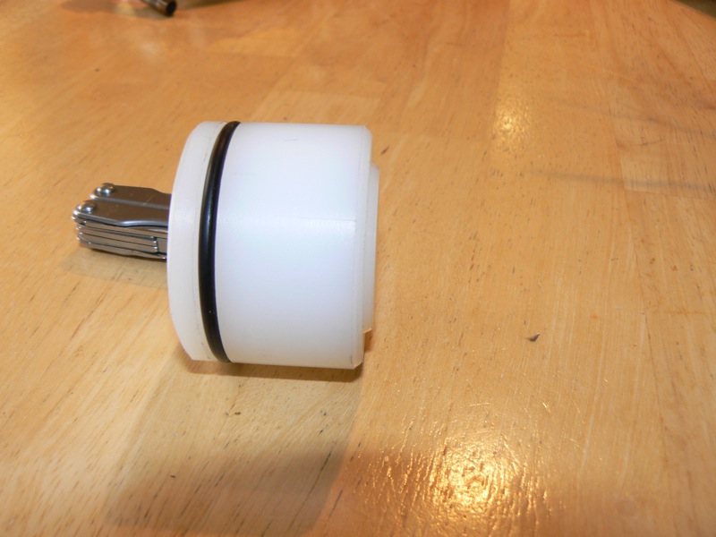

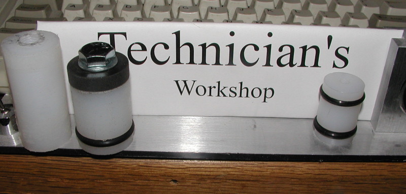

Updated photo with the finished pistons.  From the left is a long piston with no seals. A traditional barrel or chamber sealer with face gasket and o ring, and a QDV style for a Marshmallow Cannon type piston with 2 rings.

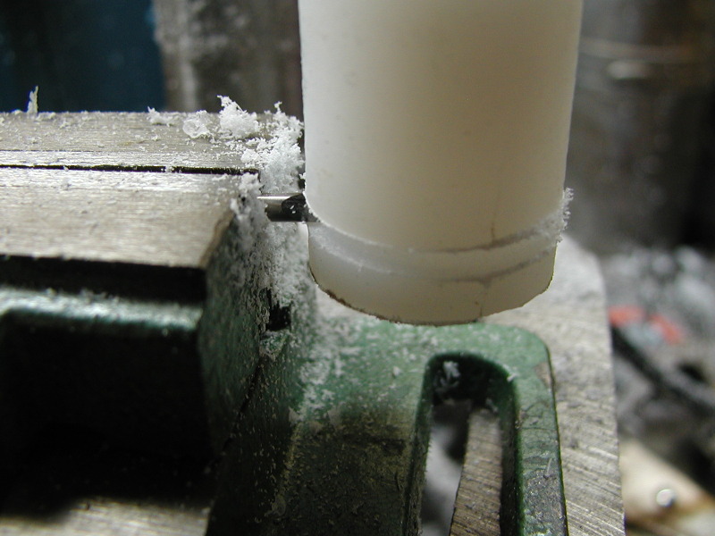

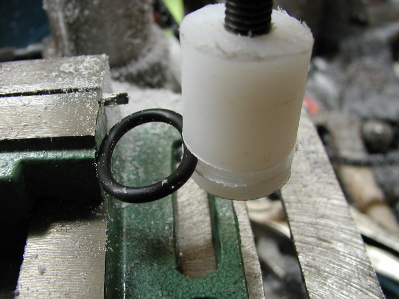

To cut the groove, a sideways cut needs done. A drill press vise works great to hold a small cutting tool that can be used to cut into the side of the piston.
The groove in a piston for an o ring is called the gland. For a floating o ring the gland is deep enough that the o ring does not receive any cross sectional squeeze. The gland is wide enough the ring has some wiggle room, so it is free to float. This prevents it from becoming stuck down in the gland.
The ring is slightly larger than the ID of the cylinder so it gets some peripheral squeeze to fit. The air pressure holds the o ring against the side of the gland and pressure under the ring tightens the seal with pressure against the cylinder wall. These work great as a dynamic moving seal on a piston.

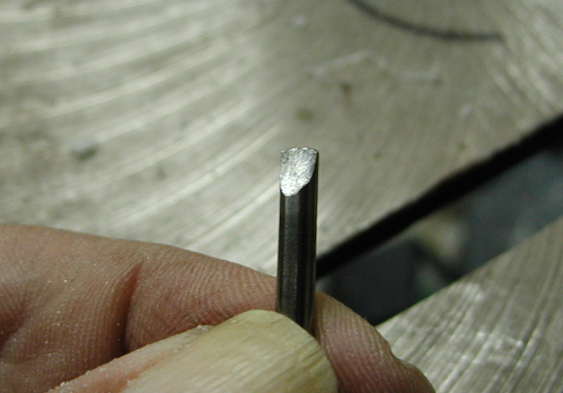

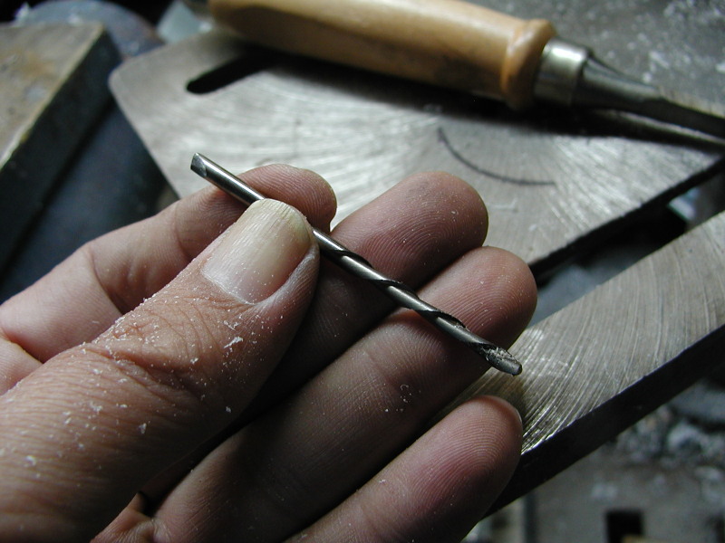

Here is a close up photo of the business end of the drill bit used to cut the gland.  It is cut like a mini chisel.
The last steps are to trim the ends of the piston.  The area by the bolt is trimmed so a washer can be used for the piston face seal.  The arbor bolt hole can be used to hold the washer.
Cut the gland so the o ring can drop into the grove without force and just deep enough so the ring can fit without any protrusion. This ensures the ring will not get any cross sectional squeeze.

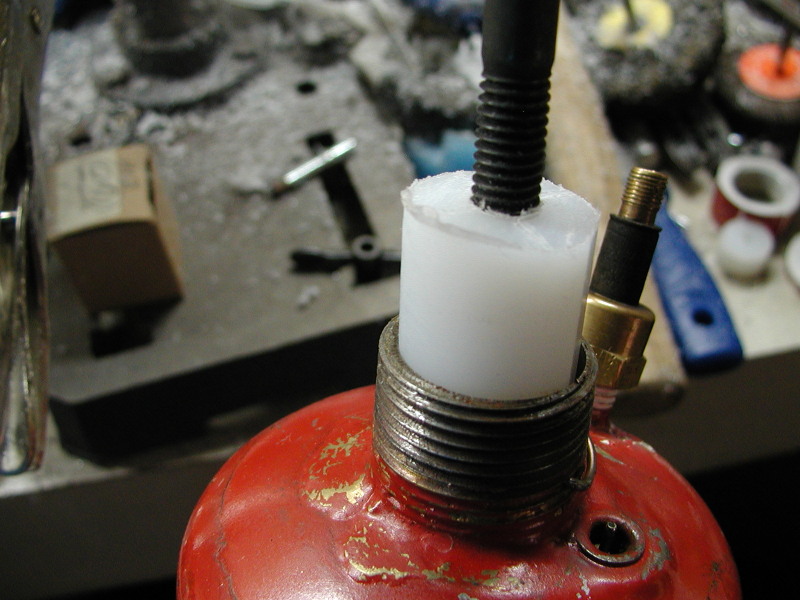

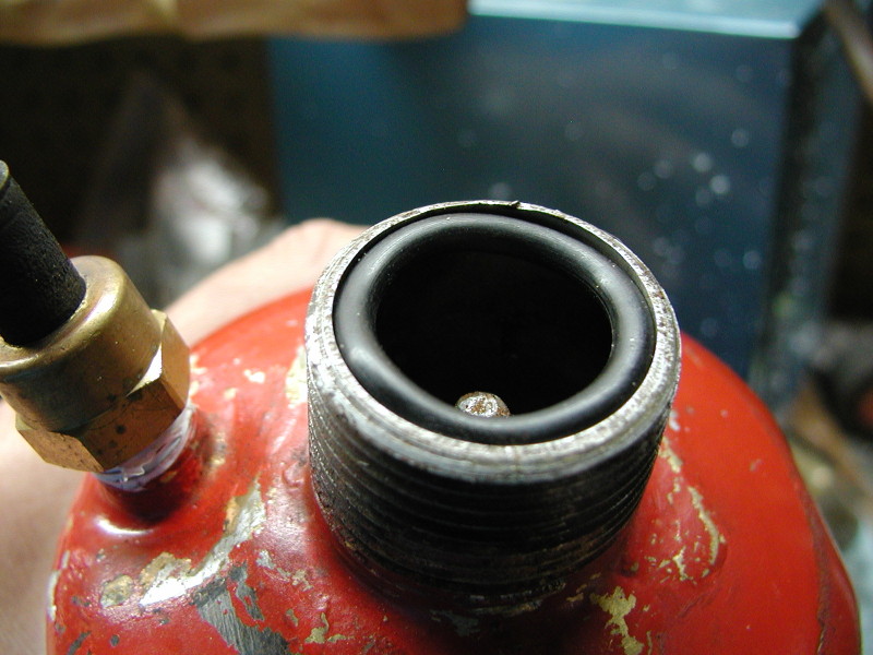

Our target o ring is selected to fit inside our cylinder with just a slight squeeze of the ring. It is the right size if it will hold it's position in the cylinder without falling out.
The tool is secured in a drill press vise and the vise is moved into the side of the piston.  The groove is first cut too narrow and too shallow.  It is easier to make it larger later than to make it smaller.
To cut the gland a small cutting tool is needed.  I simply made one using an old drill bit.  I cut an edge with a small grinding wheel.  Look at the left end of the drill bit.

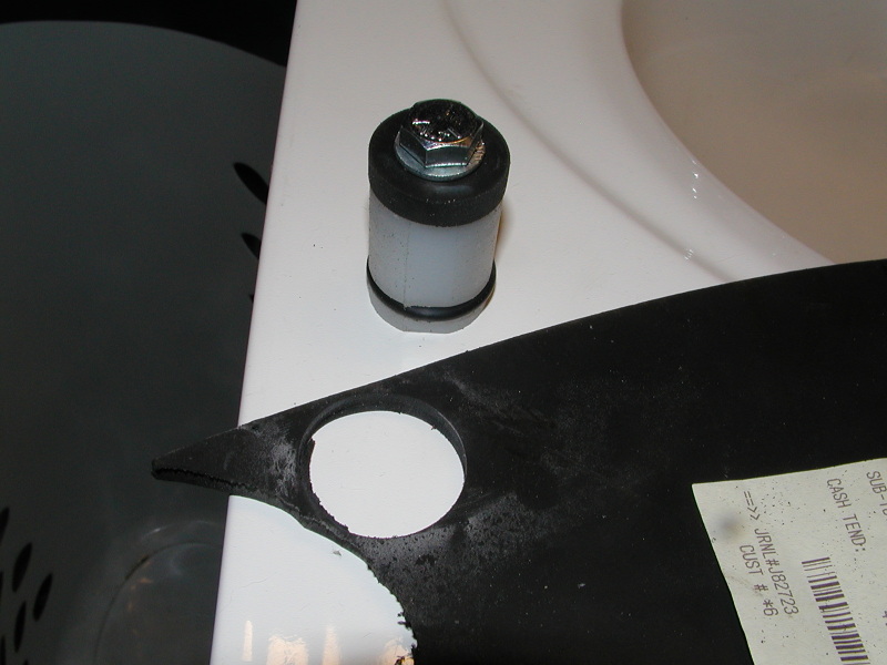

A proper size seal is cut from a sheet of rubber using a hole saw.  It is cut slightly large and then the edges are trimmed on the drill press to size just like the way the piston is made.

You'll get to your piston shape faster, and with less tearout, if you cut the corners off the square before you start to spin it on the drill press.
As so:
